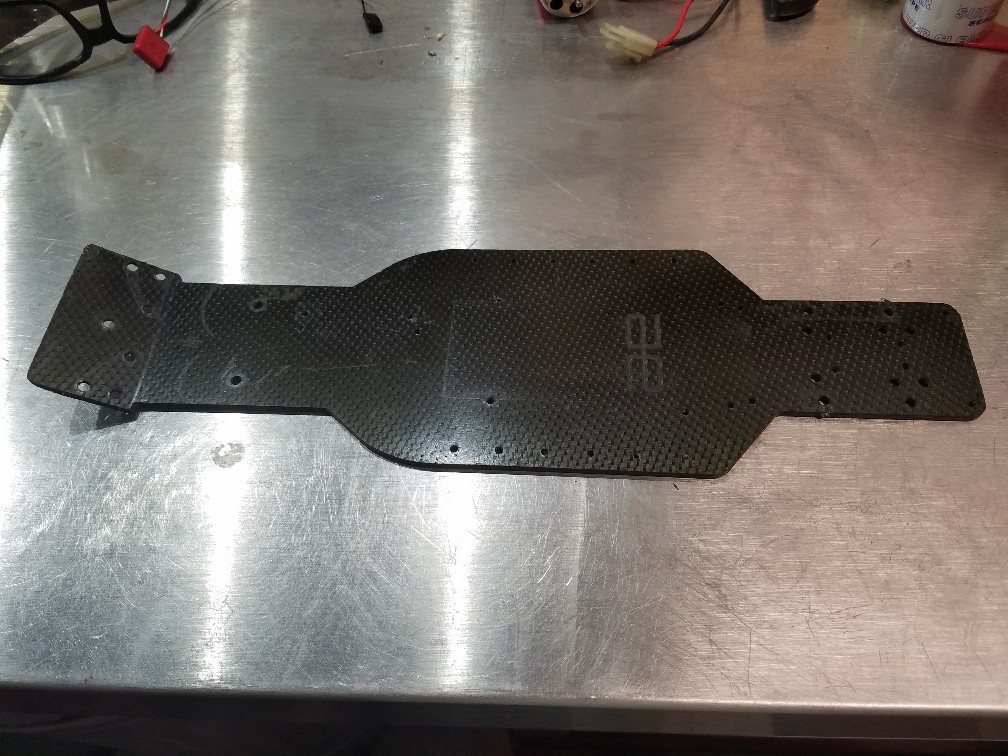

I picked this up on eBay a while ago, I was the only one to bid on it and I got it for pretty cheap. The chassis is pretty nice, but not perfect. My plan here is simple, clean it up and shelf it. Or I may unload it, I'm not much of a shelf queen kind of guy. Only things I may change are putting proper front shocks on (it's got .56 bodys), maybe a pair of vintage Ti turnbuckles, and maybe some better steering.
Here's what I looked like out of the box. Mostly just dirty, and with a few mis-matched screws. The chassis had been drilled for a Stealth, but not countersunk. I'll fix that
Disassembly down to the chassis. I still need to pull apart all the suspension and give everything a good cleaning.
Chassis cleaned up a bit. The scratches on the bottom are very light. I'm wondering if I can clearcoat and sand it to get rid of them???

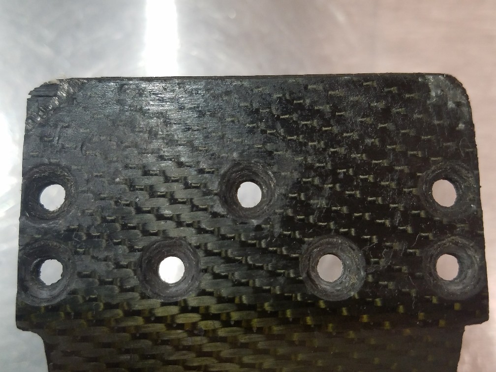

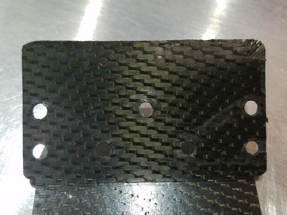

The nose of the chassis has a little delamination and damage. I need to look into re-gluing the layers, any advice would be appreciated

.56's are correct for that car.
For the chassis, CA glue and clamp it together.

I've soaked carbon noses in cyanoacrylate, liquid with the slowest cure time i could find, then tightly clamped with flat stock, sandwiching some polyethylene plastic in between; nothing sticks to it, so it's an ideal surface, a ziplock bag for example. Then once it's dry clean up any external unwanted residue with acetone on a paper towel sparingly.
clear coat won't really stick well, I think the resin is a polyester base, so something like marine sealer or fiberglass resin might work. never tried it.

To be perfectly honest, just so it looked nicer, I would probably cut and 1/8" - 3/16" off the front edge of the chassis. Get rid of the bad stuff. Though I would try to fix it first to see how it turned out. It may work out just fine.

I think I will try to fix the chassis first, if it comes out like crap I'll just trim it. I'm thinking if I try to fix it, even if it doesn't come out perfect, I'll have less to trim vs. trimming it without trying to fix it.

Brian if you want to fill any holes on chassis black milliput epoxy works a treat, pretty much invisible on composite craft graphite chassis. I have not tried on weave style carbon yet.
