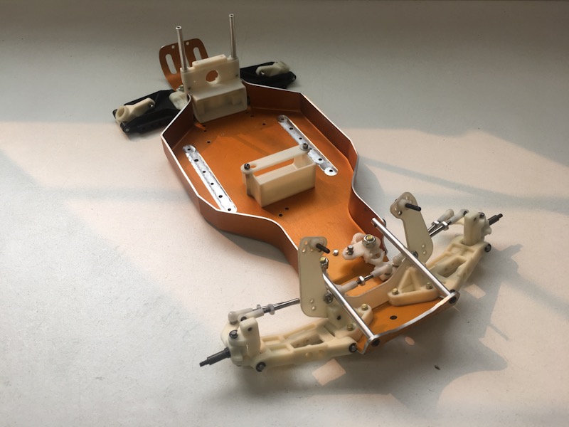

Guys, Here's my attempt at building a replica. It seems a lot harder to do then building a custom car because there is no creative freedom, you've got to adhere as closely to the original as possible and the finding of very specific parts.
With that said, here she is so far:

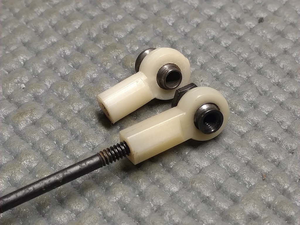

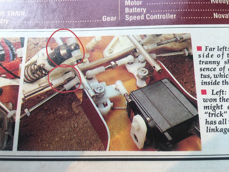

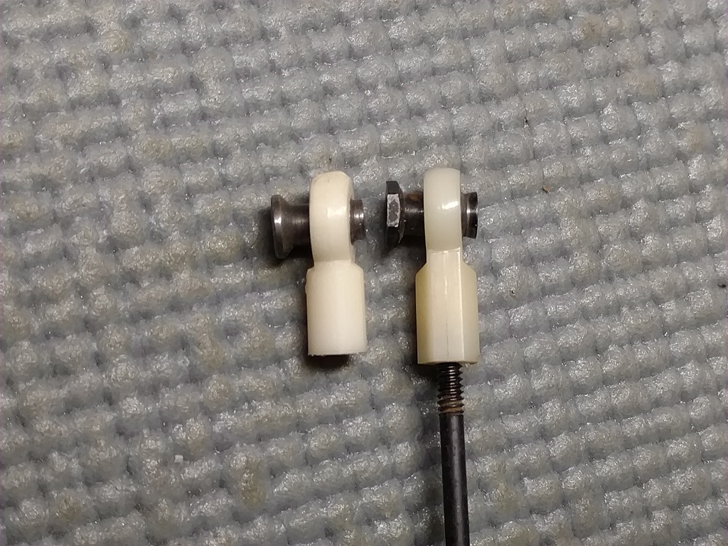

Also in this pic, are those Yokomo rod ends or just standard Associated shock ends?

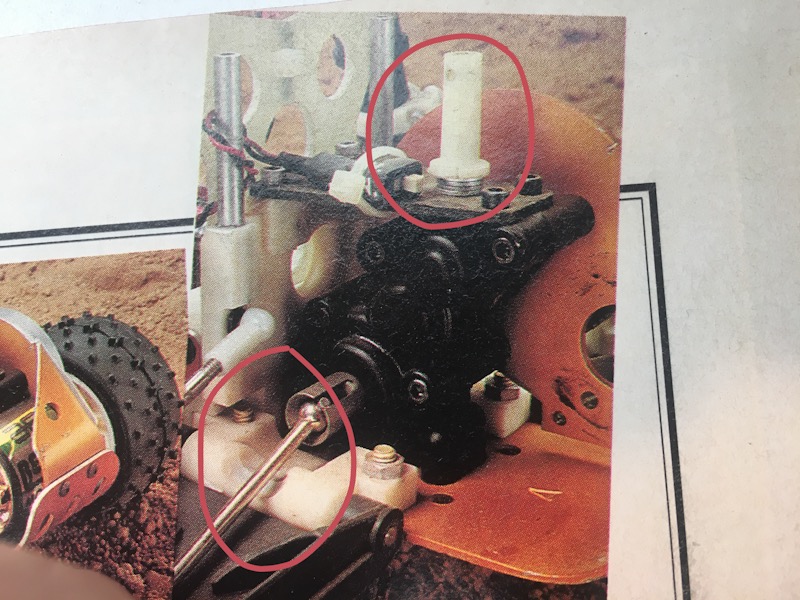

In this next pic, what is this rear body mount from? Also, what shiny universal joints did Cliff use?

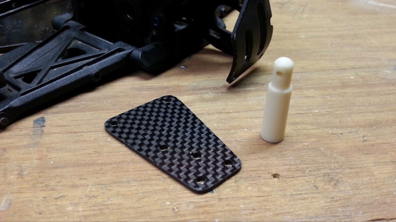

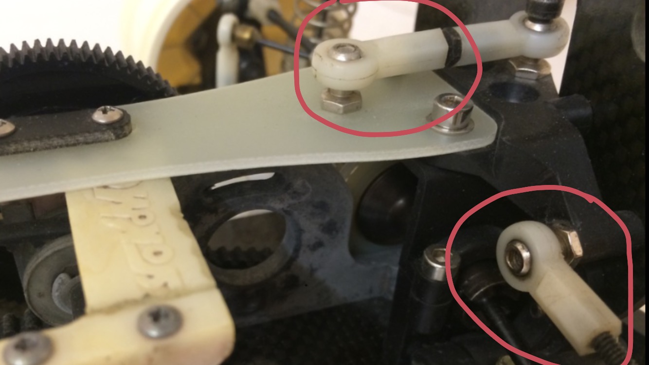

And in this last pic that I stole from scr8p's build thread, is there anyone out there who can make me a carbon fiber trans brace like this one? Also, who has a hobby lathe who can whittle down a front body mount for me?

Yokomo rod ends
Not sure what Cliff used, but I cut down a 10lss rear body mount.
jwscab made the trans brace and machined the body post for mine.

Yokomo rod ends

you can hit me up in PM if you are interested in the other parts, I can probably make that rear post out of a standard post just machined differently than the front.

I don't mean to be argumentative but after doing a Google search, looking at Yokomo tierod ends, it looks to me that the Yokomo ends have hexagon shaped bodies. It appears to me that the ones Cliff used on his RC10 have cylindrical bodies which lead me to believe that they are Associated shock ends? I have found some Yokomo threaded balls in 5.8mm which is the same as the .230 balls used on the RC10 shock ends. Also, if you compare the body of the Yokomo ends, the body and head are the same thickness whereas the ones on Cliffs car, the body is thicker then the head, similar to shock ends. Please correct me if I'm wrong.

I could be wrong. It just always looked like a hex to me in the pics I have.

It probably is. It just always looked like a hex in the pics I had so that is what I had set aside for mine.

Could very well be shock ends. They are yokomo balls though, they have to be threaded otherwise you would see a screw head or nut on the back side of the tower right in that high interference area.

I don't think those are the ones they look more like the associated lower shock rod ends like the ones a couple posts above.

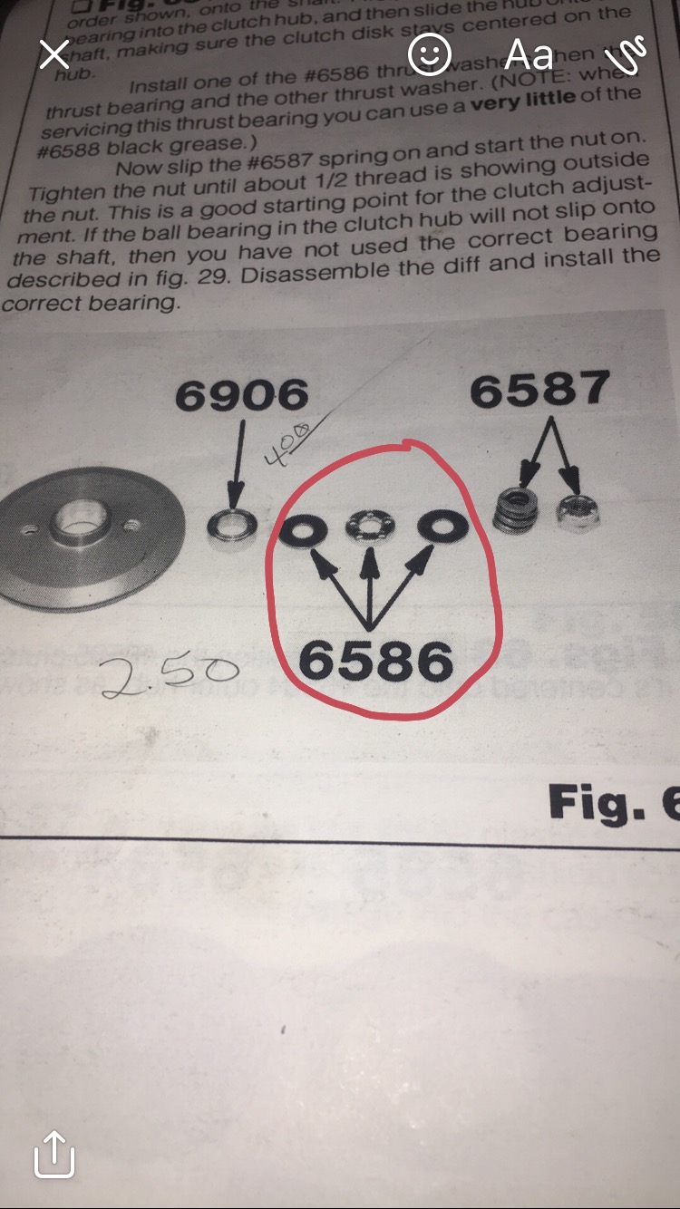

I ran into an "easier" snag while putting the stealth together. I don't have the thrust assembly number 6586. I know there was a later brass bushing version but not sure of the number on that one. Anyone have either version for sale?
I saw this on eBay, do you suppose this would work?
https://www.ebay.com/itm/361485004679
