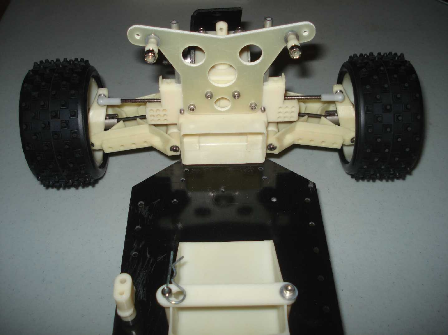

faceman2k
Posts: 40
Joined: Thu May 07, 2009 1:15 pm
Location: Voorhees, NJ
Re: TQ10 restoration suggestions?
Post by faceman2k »
Well i finally stopped looking at all my parts and decided to actually start putting something together. I've got the back end done except for rebuilding the shocks and i just can't bring myself to put the used white spur gear i have on it. I also started using all stainless steel hardware on all my "collection" cars so the hardware will not get all rusty over time. I know it's not "factory" but it keeps the hardware looking good over time. I will start the front end this weekend.
