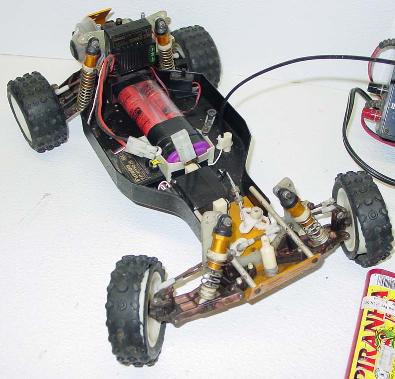

- The whole car, nice tires!
- ebayrc10 004s.jpg (105.81 KiB) Viewed 1152 times

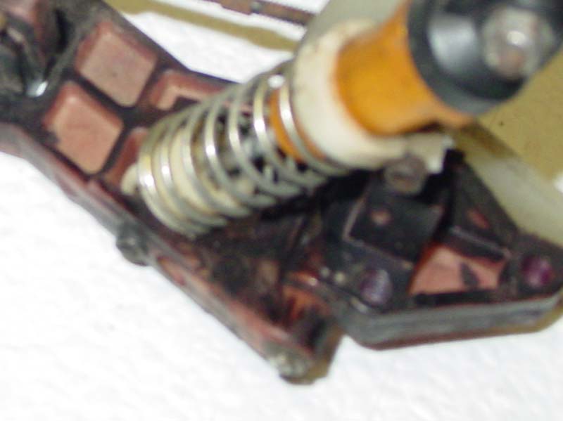

- rear a-arms, note the lack of color in the corners next to the ridges
- ebayrc10 006s.jpg (65.52 KiB) Viewed 1152 times

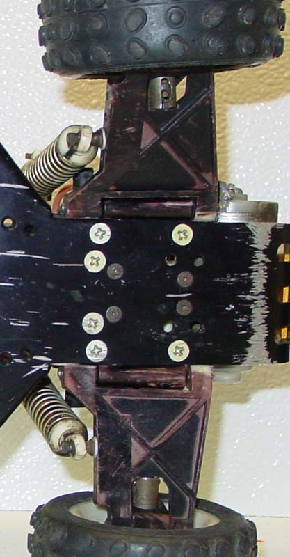

- front end, no color in the recesses,
- ebayrc10 010s.jpg (48.97 KiB) Viewed 1152 times

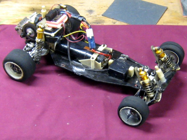

i got this one off of ebay for $20. someone painted the suspension parts with i believe testors model paint. the wheels, too. i soaked the parts in lacquer thinner, and scrubed it off with an acid brush. the parts were all shot, but they cleaned up.
before and after
before and after
- Attachments
- IMG_0746.JPG (109.47 KiB) Viewed 1144 times
- IMG_0581.JPG (80.05 KiB) Viewed 1144 times

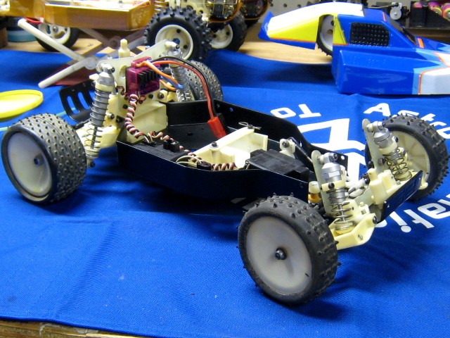

I don't know about using the marker to "color" the parts, but you can use the felt inside a sharpie to dye parts. Just take the felt out, cut it open, and put it in the water just like RIT. I use blue sharpies on my parts because the color matches RPM parts better than RIT.
In this pic the rear bumper was dyed with a sharpie, the other parts are RPM.
