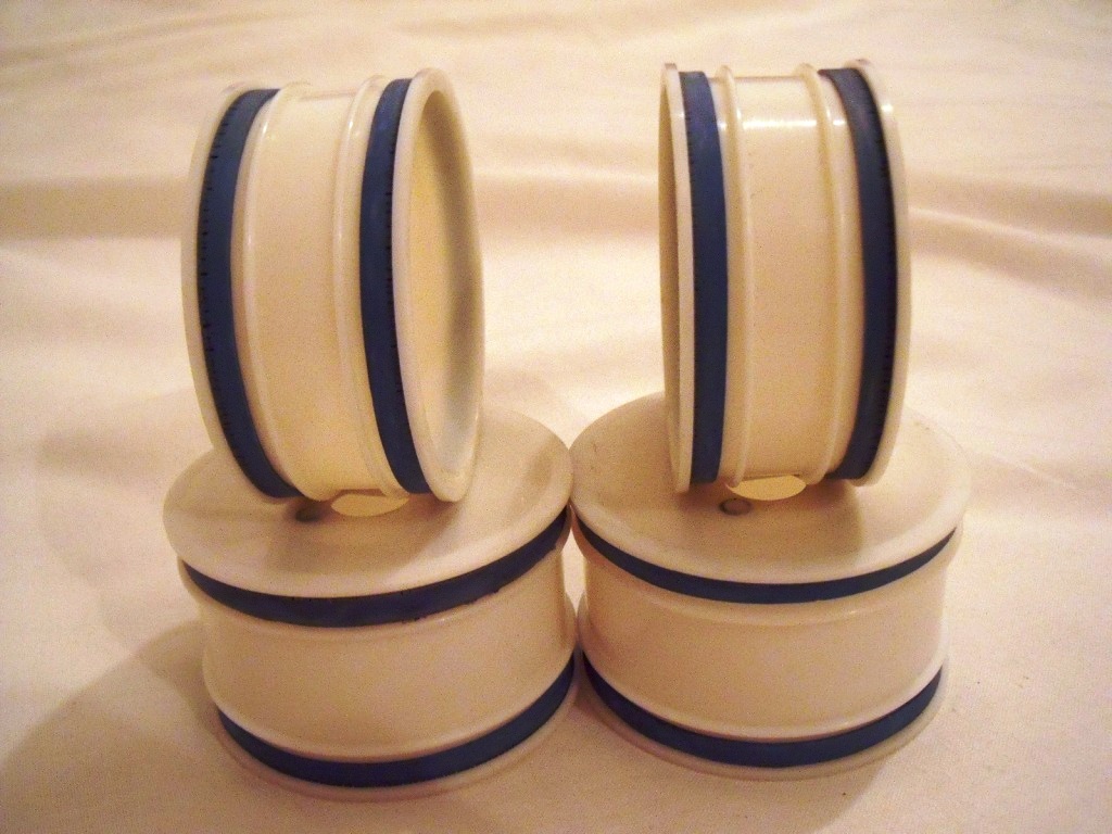

Here's a photo of the ZC-821 wheels which I have, they look exactly like the ones which came with the car originally?
The strange thing is that I have seen these other ZC-821 wheels which had plastic ribbing as on the YZ10 wheels.
YZ-821 YZ-827.jpg (25.38 KiB) Viewed 1841 times
These Yoke part numbers seem confusing!

Someone else here might know a little more about those wheels but the notation on the header card that they are Roar legal means that they can be used at Roar events with a rubber band around the tire rib slot and a specific tire to be used at those events. I don't think I've got this 100% correct but there is something special about those rims and they came out later like for the YZ-10.

Retro back in 89 at the world's here in Australia there was a whole big deal that went down with the yokomo team drivers running 2.2inch rims and tyres. This was deamed unfair by roar and by the 91 world's in detroit they were outlawed. Rims were to be 2.1inch I think so the way Yokomo went around it was to supply rubber bands (the blue ones) with each set of rims. These were first glued onto the rim then the 2.2inch tyre was fitted over the top and glued in place. Kinda sneaky I know but thats how they got around it.

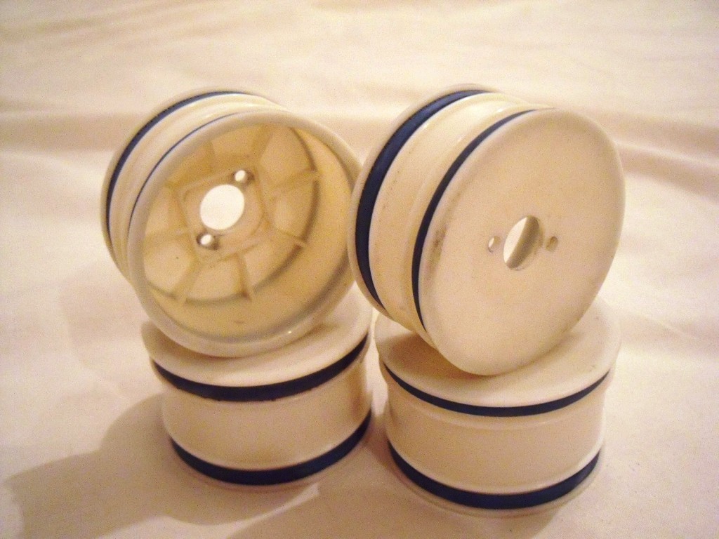

The other rims with the webbing on the outside were made for the later model dogfighters and have a different offset to the first series of dog fighters.
If you want to trade I would be interested in the webbed rims- :wink:

bormac wrote:Retro back in 89 at the world's here in Australia there was a whole big deal that went down with the yokomo team drivers running 2.2inch rims and tyres. This was deamed unfair by roar and by the 91 world's in detroit they were outlawed. Rims were to be 2.1inch I think so the way Yokomo went around it was to supply rubber bands (the blue ones) with each set of rims. These were first glued onto the rim then the 2.2inch tyre was fitted over the top and glued in place. Kinda sneaky I know but thats how they got around it.
Hi Jason is this what you mean? these wheel set are 2.1" and not 2.2" that's why yokomo provided a blue rubber band to glue the 2.2" tires on it. :roll:
im also interested to trade my 2.1 wheel set with those webbed rims :mrgreen:
