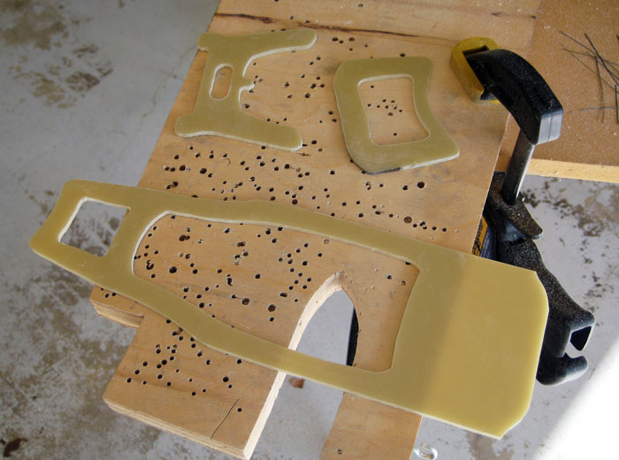

This is a quick video on how I cut some front towers for my Kyosho Turbo Ultima.
I design and draw everything on CAD and print on regular paper. Taped to material (2.5mm thick G-10 fiberglass sheet) with carpet tape and cut using a jewelry hand scroll saw with 0/2 blades (I use like 5, some broke some go dull).
After cutting I use a Dremel and drum sand all the edges and to finish I hand file to refine the part. Finally drill holes and counter sink where needed.
It probable took me +/- 3 hrs to make all 3 parts (front and rear towers and a chassis top plate). Some minutes got lost in thinking. :D
Thank you for watching.

I have done CF before and it is a bit harder but I can get the same results. Make sure the space is well ventilated.
My saw is 6” deep and I recommend the deeper the better. It helps with larger parts if you have more room behind the blade.
On blades, I say any brand is OK. I have tried the expensive and the very inexpensive ones and the inexpensive ones brake faster but you get 4 times the amount of blades for the same $. Like I mentioned above the 0/2 size blade is a good size, any smaller like 0/4 will take more time to cut and something like a 1 would be OK but the finish edge is not as refined as a 0/2.
Good luck with your parts.

This is one of the things I wanted you guys to know. I recently goy my new scroll saw hoping ti would make the job easier and faster but I fell like it is not going to work out.
http://www.rc10talk.com/viewtopic.php?f=40&t=12520&start=0
The problem with the scroll saw is that it makes short movements up and down and only uses the bottom part of a blade. The blade gets fatigues or brake easily when cutting G-10 or CF. When you cut by hand you can use the whole blade and works out better. I am thinking the Scroll Saw works OK when cutting thinner material like 2mm or less. I still have to play with different size blades but I like the hand process better.
I will probable be experimenting after new years so I will keep you posted on my experience.
If you are thinking of cutting some parts I recommend you get the hand saw and go at it.

i usually use a hacksaw for all rough cuts, then follow up with files. I'll use a drill at the point of acute angles, or within an enclosed cut. goes very quickly.
the other thing i tend to do is drill the holes first, rather than after the shape is cut. this way, the holes are all 'true' in location, since the outside shape is pretty much irrelevant, if the cuts aren't perfect, it won't affect alignments.
I like the idea of a form to attach to the piece to cut, but i usually scribe the shape onto the material, this gives me a very fine line to cut or finish to.
I have been thinking of getting a small drum sander, which would really speed up the finishing process, you can really put some nice curves and shapes into the material with them, and leave the edge finish really nice and smooth.

I have been using a jigsaw with 1/8 in blades to cut my G10 and
it wears the blades out quick. If i use the wider blades its does better.

yeah, the problem i have found is that when you use a quickly oscillating blade, it tends to overheat, and dull the teeth. Just the physical nature of the fiberglass, you can move very quickly with a hacksaw blade with a nice slow steady full blade stroke, the material and blade stays cool, and the cuts move fast.
