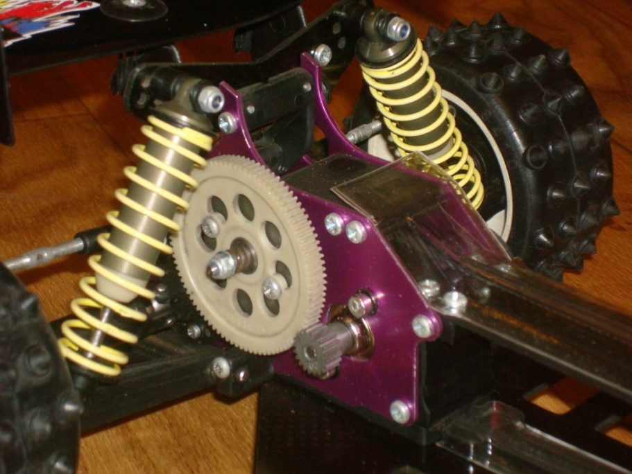

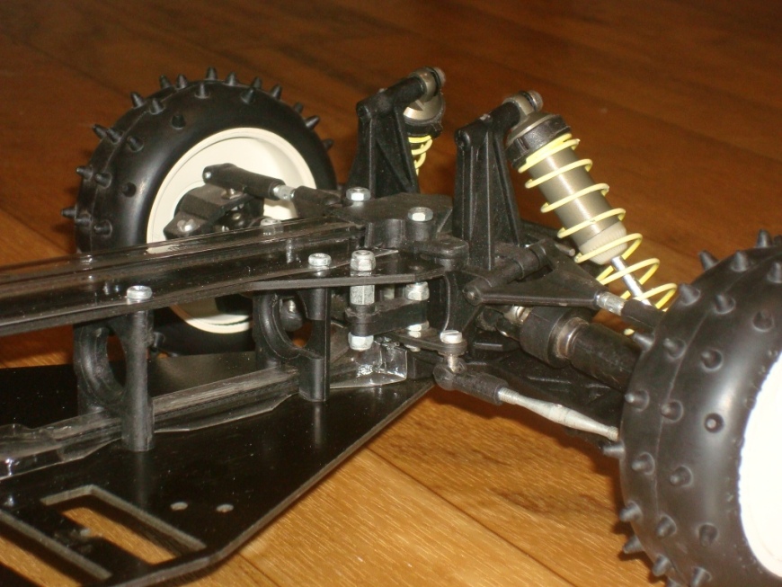

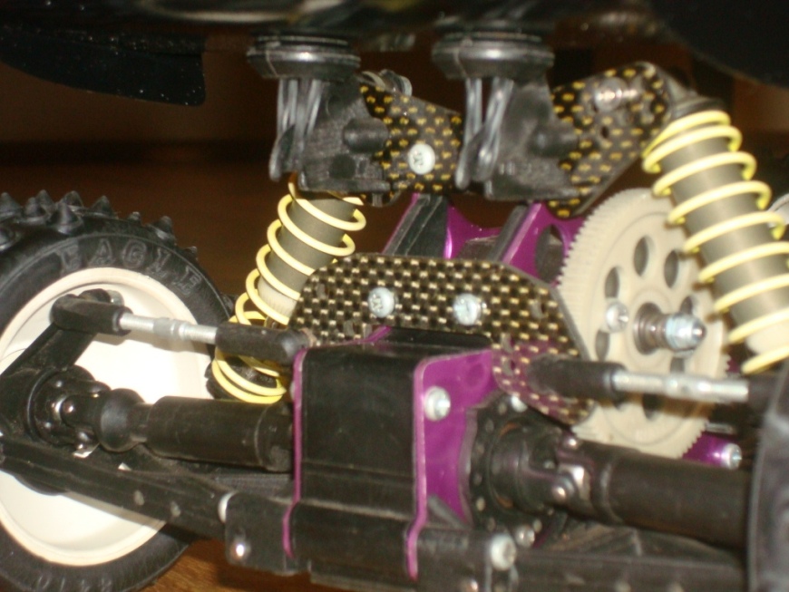

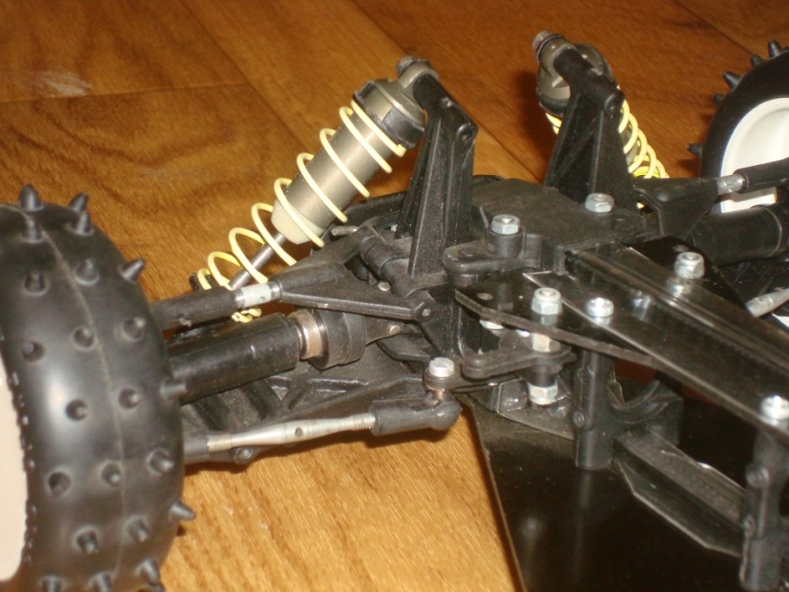

Some closeup shots for Red Scampi..
I have added a Pocket Rocket 4wd 17t mod motor to her.

Your car is looking good. I am hoping to find one my self so I can do a replica of my only National A-main making car. Good choice with the Twister in there. Always loved those motors. Ran a 13trp on 7 cells in my Cat back in '93

Ive built numerous Bosscat's from new spares and a couple from good condition used parts. I have to say that Schumacher definately built it right. The front bulkhead realy made the difference and the front suspension towers/uprights were much heavier duty than the procat before it. The adjustable camber link up front was also a much needed refinement too.
The Bosscat (and especialy the WORKS) had all the goods right in the box. The newly designed slipper works well, the alloy '5 bearing'PRO diffs are works of art and the carbon Fibre chassis plates are sweeeeet! Also this was the first car to run the new 2.2 aerodisc (if you dont count the PROCATse) so the modern tyres work with these cars now.
