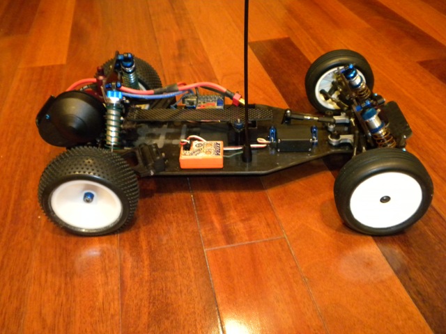

Here's a side view and a top front view. You can see the angle that the rear shocks are leaning inward. What is not visible is the bottom mount I previously described. If needed I can post a pic of that as well. This is a Composite Craft chassis with the Houge arms and mounts. You can also see the spacer underneath the inner mounting point for the arm mounts. This was to correct the extreme amount of negative camber that came with these cars.

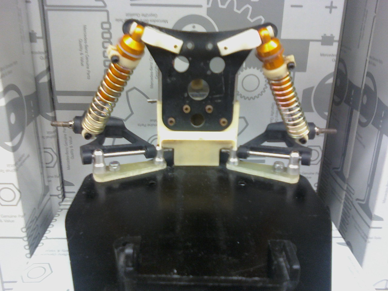

Pics of the chassis.
I should have chose a better angle on this one, maybe a bit more overhead.

a shot from the top or bottom would've been nice. but going by the a&l motor guard, arm mounts, shock mounts, shock tower, and the roundness of the chassis by the rear arms, i'd say that it's definately an a&l chassis. but mounts don't seem to be in the right spot. are there multiple holes in that area? does a battery even fit in the bulkhead with the mounts in front of it?
i'd find a pair of a&l rear arms and be done with it. :wink:

Just an observation- it doesn't look like you have enough downward travel in the rear. If the lower spring mount hits you could try B44 mounts. They will raise the spring away from the point where it mounts to the arm.

JHarris wrote:Just an observation- it doesn't look like you have enough downward travel in the rear.
it would if it had a&l arms on it. :wink:
plain and simple, he needs to have the correct parts. he doesn't, and it's causing problems. i still want to see a pic of the bottom, though.
