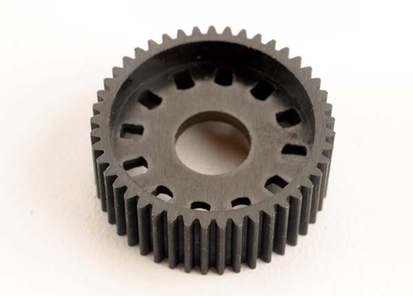

I also saw that the stealth diff gears are 45T too... the inner bearing would be different, but the gear could be bored out to 8mm... anyone has ever tried this?

jwscab
Posts: 6580
Location: Chalfont, PA
Been thanked: 505 times
Re: modern parts for trx-1 diff?
Post by jwscab »
as Mark said, you'll have to watch the ball diameter, but that is a great thought!
if you have taken the diff apart already (I'm guessing, based on your descriptions) take a look at how the gear is molded, does it have an offset, like, does the center of the gear actually 'sit' in the center of the gear? I'm pretty sure the stealth has no offsets, so it's probably OK as long as the balls line up somewhere on the diff rings.
I would also ream the hole out to the right diameter, to keep it concentric, and close tolerance, as well.
keep us updated!
jwscab
Posts: 6580
Post by jwscab »
here are pics of both. they look damn close! The associated gear looks a bit wider, but you could sand it down to the right width pretty easily......just have to use the right balls, hopefully, they are the same size, 3/32 vs 2.4mm(same), dunno for sure....doe the traxxas one use 3mm balls?
