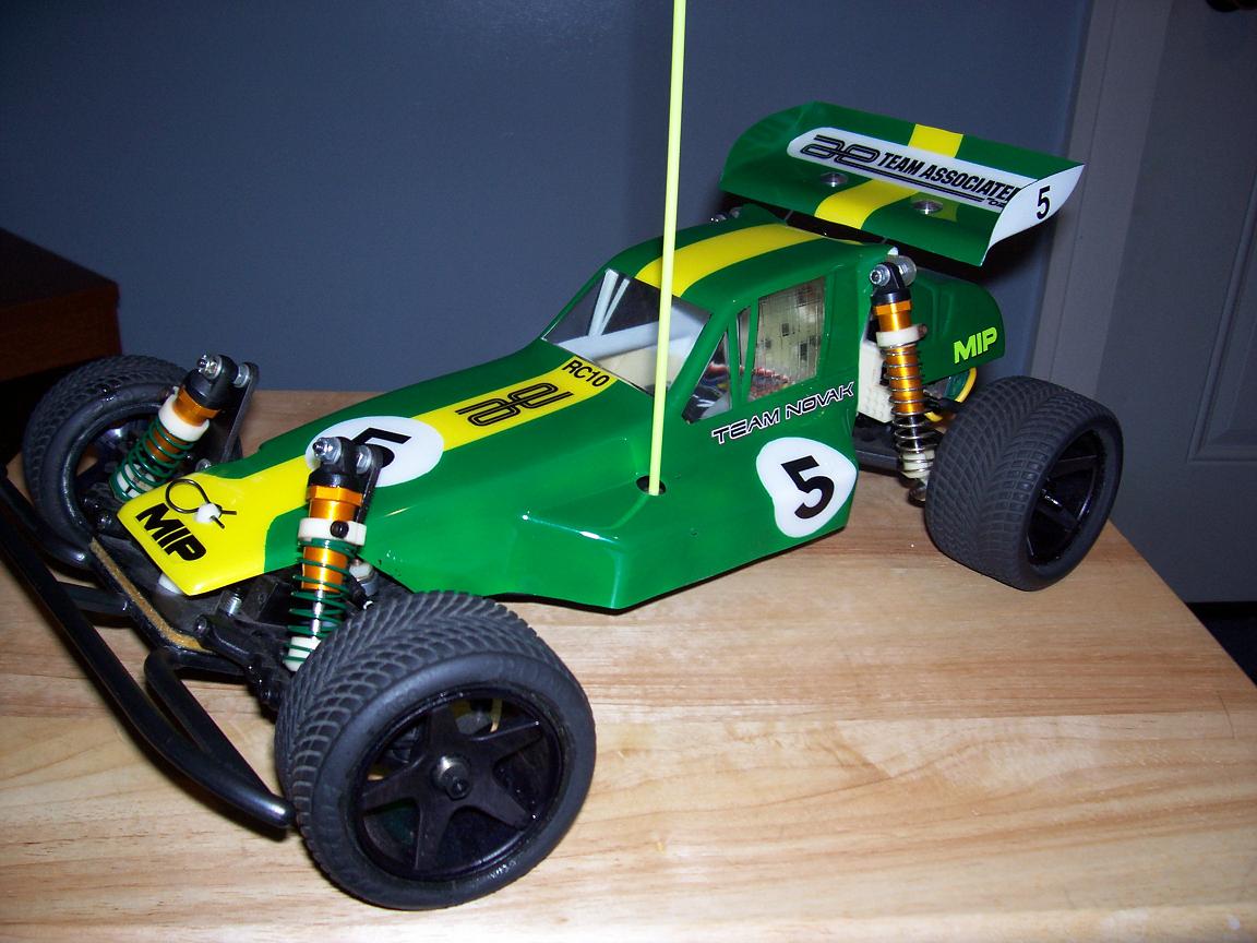

here is a pic of RC 10 with a lotus paint job. Based on a composit craft chassis.
arf
Posts: 254
Joined: Tue Jan 08, 2008 8:48 pm
Location: LaLaLand
Been thanked: 7 times
Re: Project RC10GTplus
Post by arf »
rctenracer wrote:here is a pic of RC 10 with a lotus paint job. Based on a composit craft chassis.
Cool. Here's a matching Brabham in British racing green.

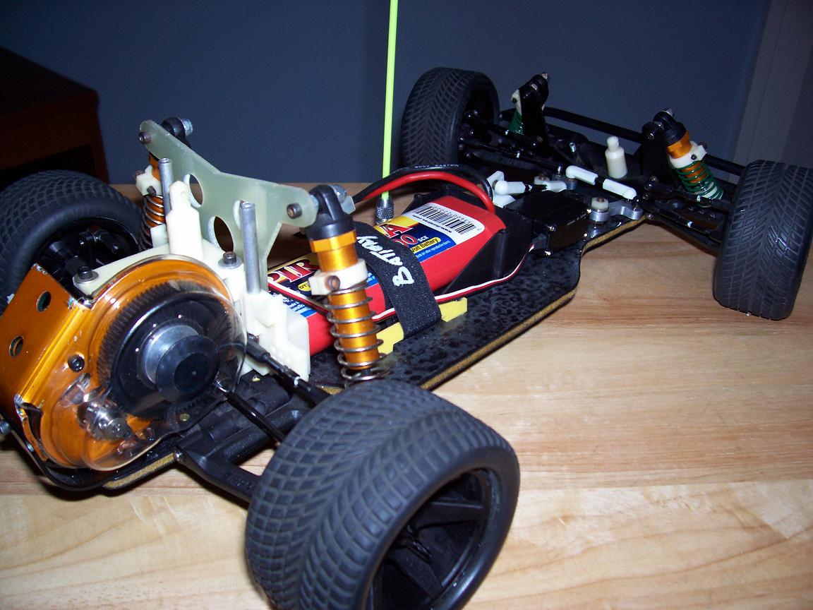

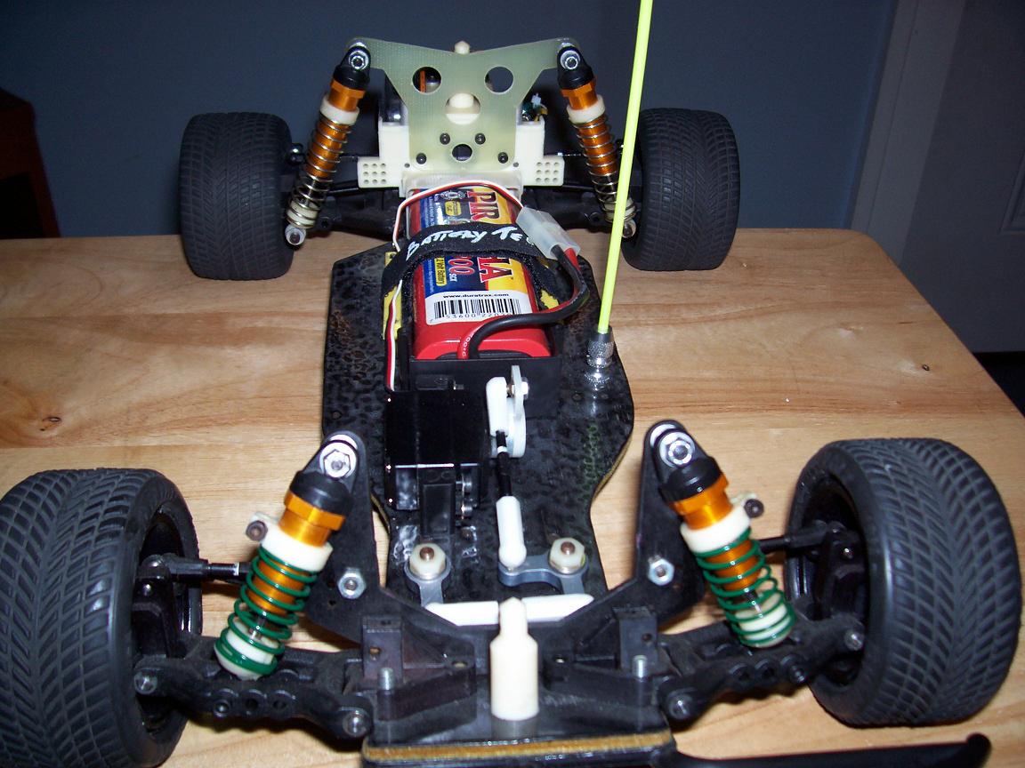

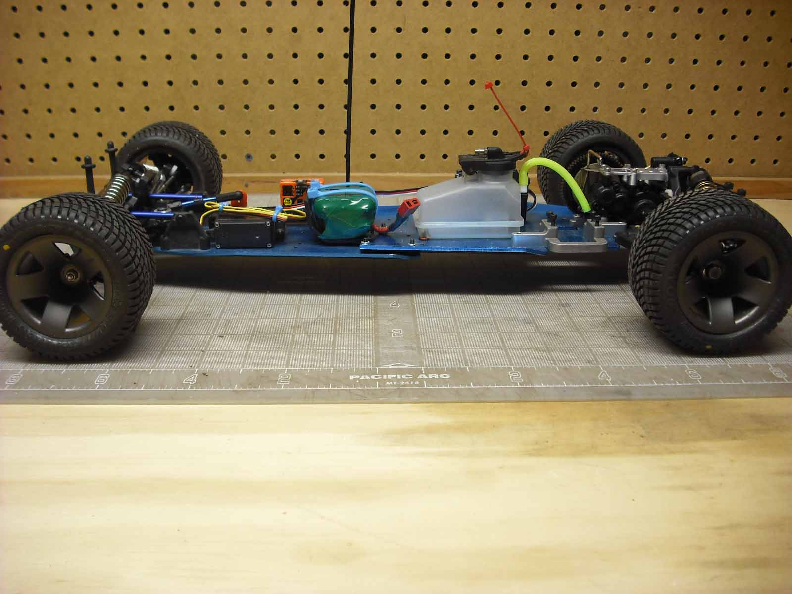

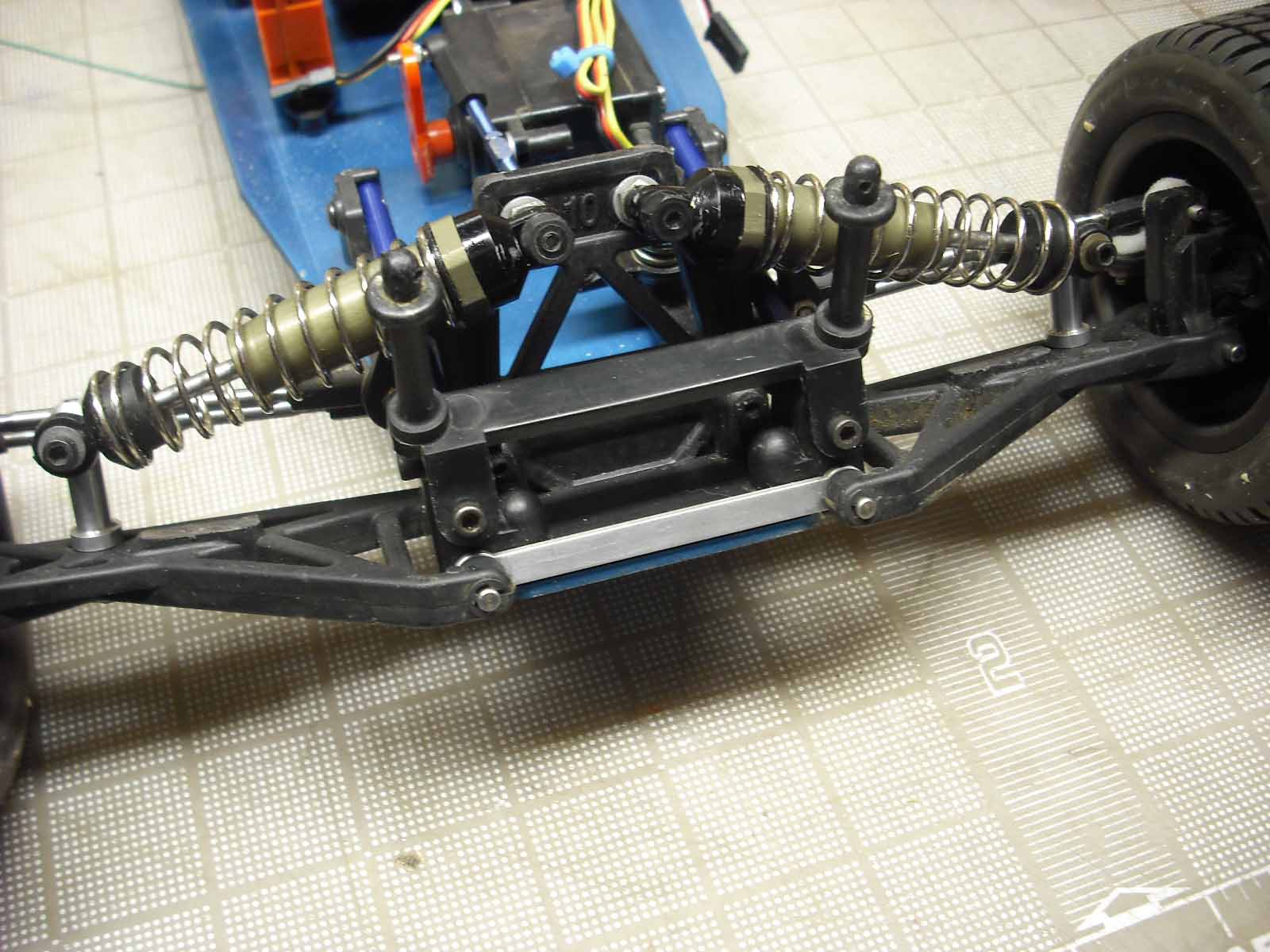

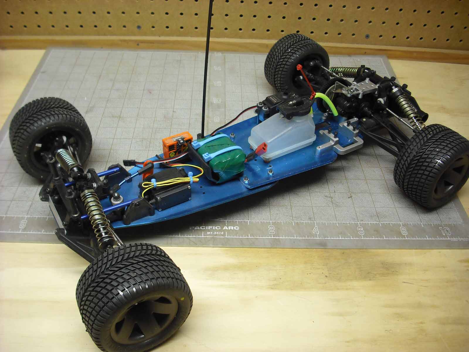

I used pan car wing mounts to locate the bottom of the front shocks and the shocks clear the nose tubes nicely. They will do for testing until I devise something better. I've been told that the car as it stands will have excessive body roll and that it will need sway bars. I did not plan for that. Anyway I'm pleased that the entire car has been out of the GT parts bin. Now... think about engines, think about...engines...

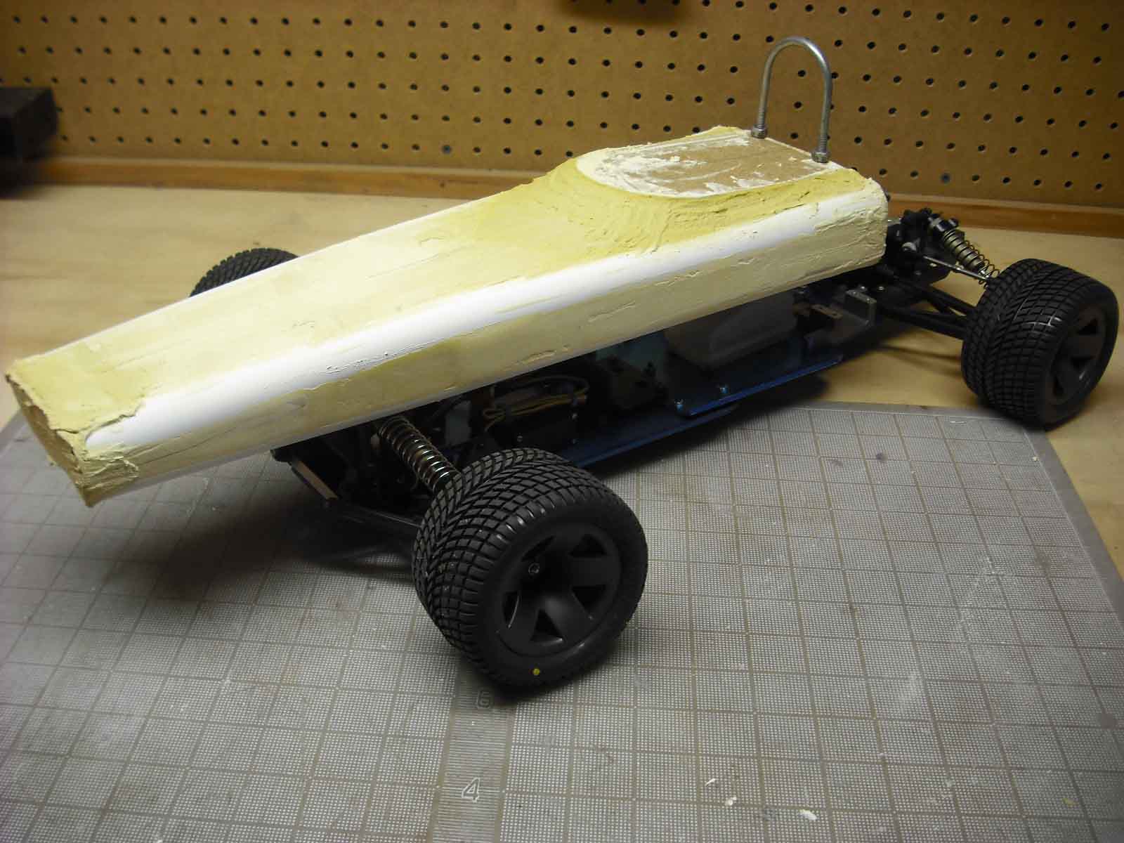

Here's the body roughed out in wood and putty. I will add flares over where the front shocks exit. Sanding and finishing will be the hardest part of this project, then a rubber mold, fiberglas, and paint. Additional parts will be a windscreen, roll bar, mirrors, and I may add a wing to partially hide the pipe and give color to the rear. I've chosen a rear exhaust engine, just haven't shelled out for it yet. The shed out back is freezing right now and my fingers have been too numb to make much progress, figure to complete this by the end of the year.

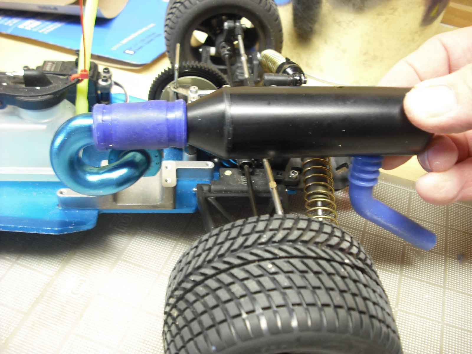

Correct. Both exhaust types provide advantages depending on where I want the pipe to live. I'll post a shot showing the pipe in a good position to take advantage of the rear exhaust setup.
Posted. This is exactly the same as the stock GT tuned pipe setup except that it's flipped upside down. Pipe will be higher than I'd like but a wing might help cover it.

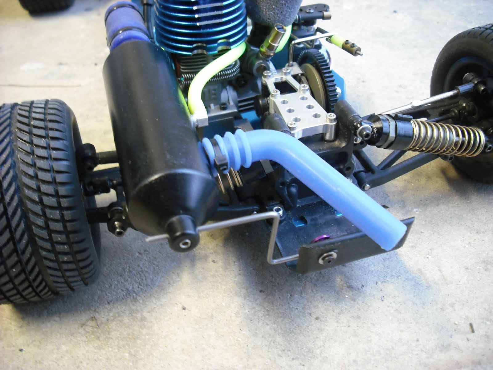

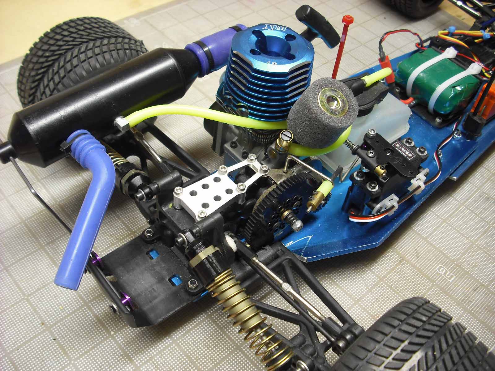

.18 engine installed with the exhaust exiting the back as it ought to. I bent a wire mount for it and relocated the fitting for the pressure line. 18 tooth clutch bell for top end. Not completely happy that the pipe is located so high but I know that a long distance between the pipe and header may cause tuning problems (later i may try a header extension to get the pipe located where I showed it earlier in this thread on the rear battery tray.) I also replaced the stock 30 degree front caster blocks with 20 degree (6214) shouldn't need that much caster on pavement. Now i must go thru it and check all the e-clips, use thread lock and glue the tires. I'll break in the engine when I get a sunny day. Is any of this really gonna work?
