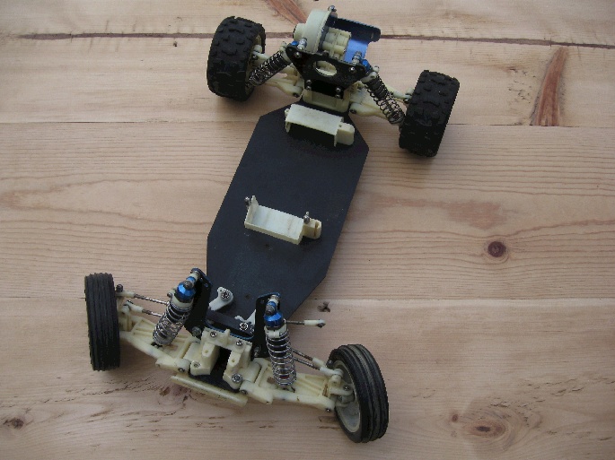

Howdy,
So I am having a revision here and am rebuilding this TRX-1. So far I've got the transmission rebuilt and I pressed on a steel top gear. It was a little notchy so I beveled the idler gear slightly and ran the trans in with a drill. It spins super-free now. I will put a HobbyWing 17.5 combo in this. I also have some parts to dye black. I have some lighter colored shock bodies and the lighter blue caps for it also.

Well so here is an update:
Slammed an LRP Indy 600 in it and I have converted the front end to SuperWideTrack. We got RPM Nitro Rustler Front Arms with TCP caster blocks, SRT knuckles / steel axles. RPM rear arms, Raborn (10T) slipper, Thorp gearset, MIP CVD, Tamiya Dirt Tuned, with a crummy pack I soldered up.
Mark
