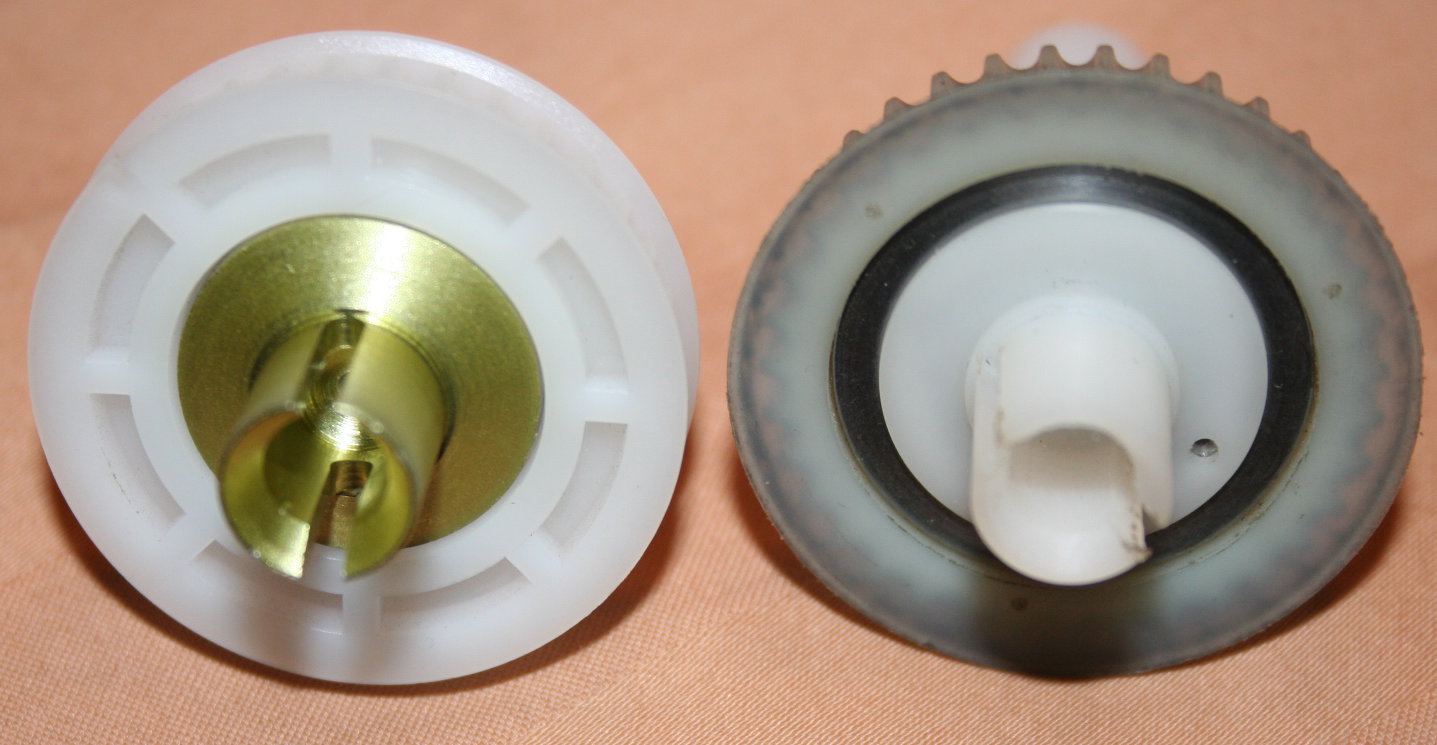

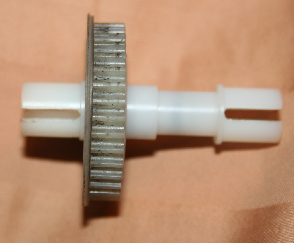

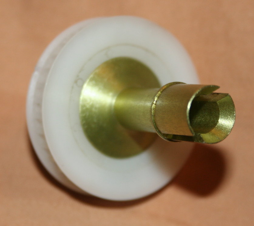

OK I posted this when I was looking for Diff parts. I recieved a couple of the ones I ordered and here they are.
On set of diff halves are made of delrin by Integy I did not have a set of the smaller diff rings to put the other Integy diff gear on the delrin diff halves so I used the stogk rear gear for now...Trying to find the YR4 rings without the D cut. The front is an Integy delrin 35Tooth pulley and team suzuki aluminum diff halves...Also looking for another Aluminum set of diff halves for my second car build.
