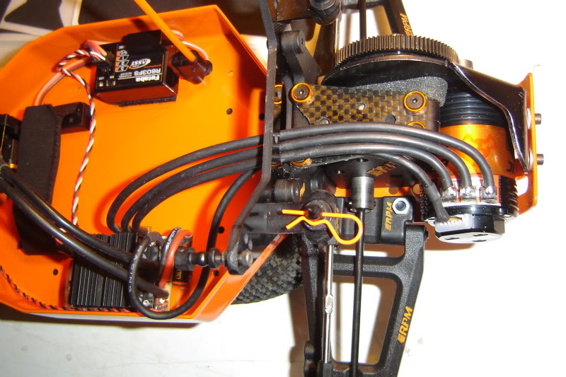

I added the Novak Havoc and Ballistic 13.5, I went with all black 14g wires. Kids.... Don't try this at home!

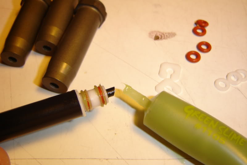

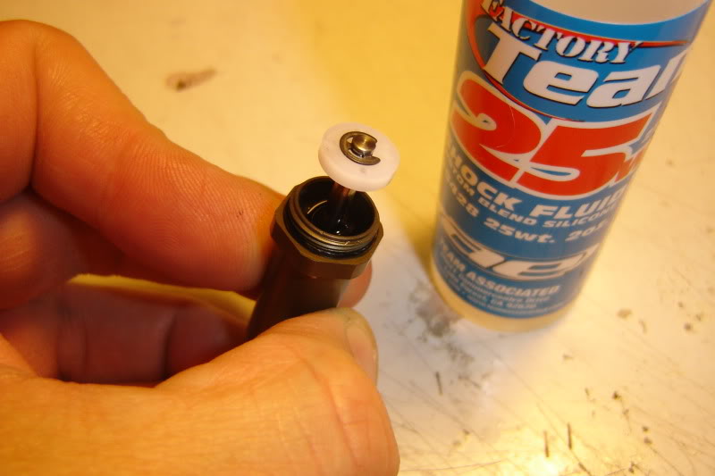

Got the shocks built this morning before going trail rigging. Here are some of my shock tips:

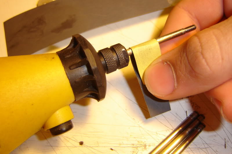

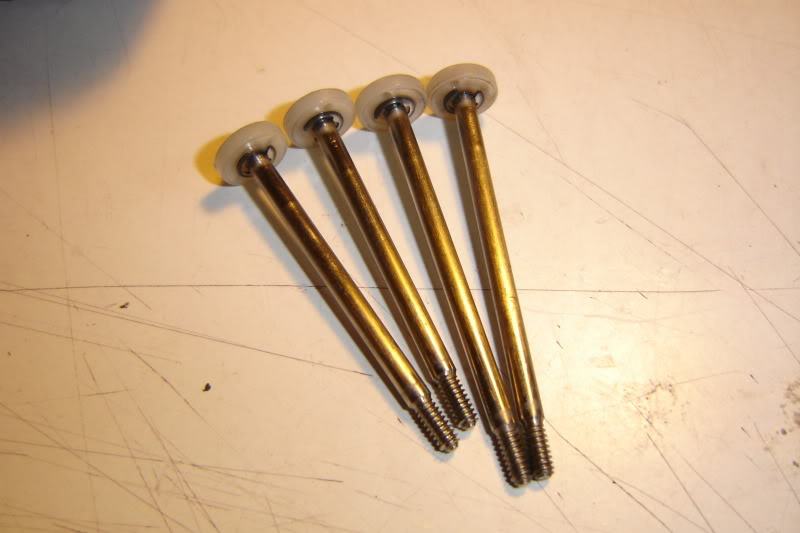

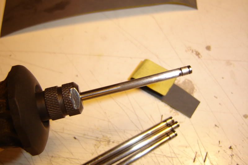

HOW TO POLISH YOUR CRUSTY OLD SHAFT
The original shafts are all crusty and pitted.
I don't have the coin now to buy new ones! So you put the shaft in the Dremel chuck and use a strip of 600 grit (or finer) sand paper and polish it!
After you polish one end of the shaft, flip it and do the other. See how the threaded end (in chuck) is shiny and the piston end is dull! I finish off with a cotton rag to realy get it smooth
USE GREEN SLIME SO YOUR POLISHED SHAFT GOES IN SMOOTH

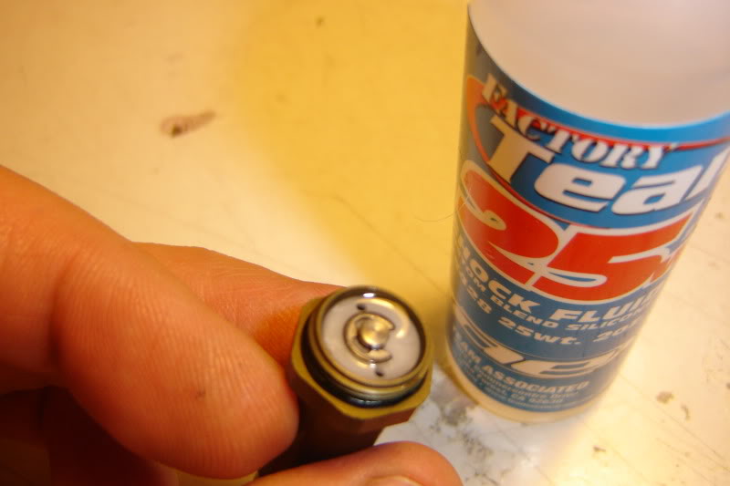

FILL BODY WITH FLUID WHILE YOUR FINGER PLUGS THE BOTTOM!
INSERT SHAFT SLOWLY WHILE REMOVING FINGER FROM BOTTOM
NO AIR BUBBLES
NO AIR BUBBLES

Yes! Try it out, been doing it for years, no waiting for air bubbles to get to the top that have been trapped under the piston!burnsmonkey wrote:Does that air bubbles trick really work?
