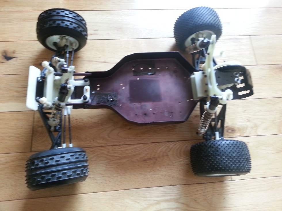

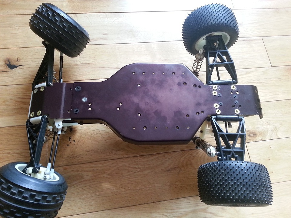

This is my new project, a 10T that I hope to turn into a relaible runner for some practice sessions on a back garden track more suited to a truck than a buggy.
Plans so far are to use GT/T2 arms and CVD`s that I have along with a B4 slipper etc
Any TIP`s or ideas welcome as this is my first T :)

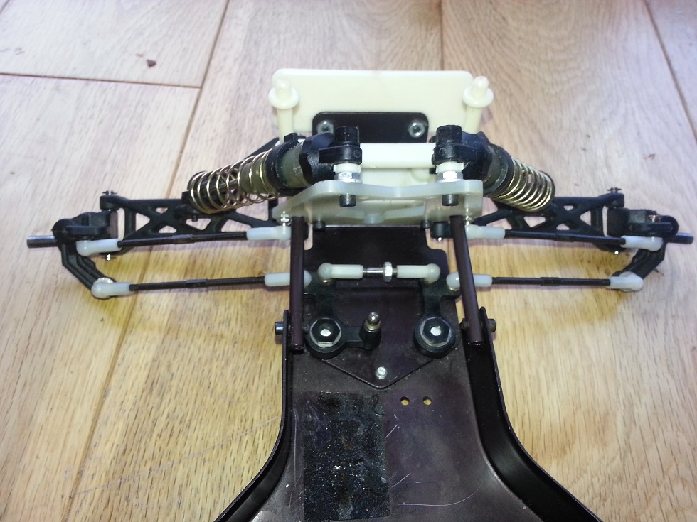

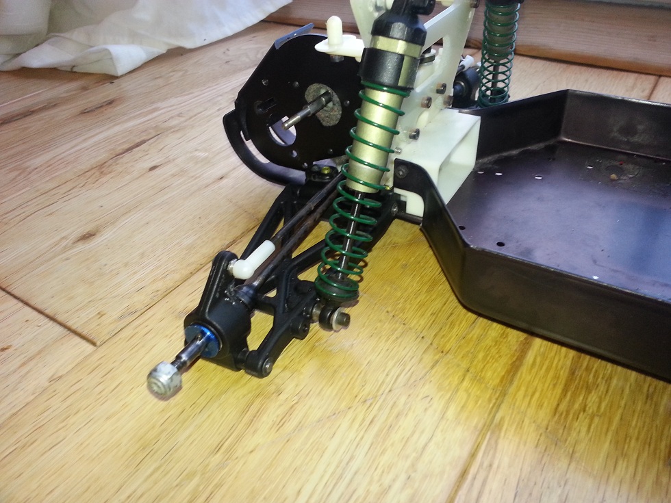

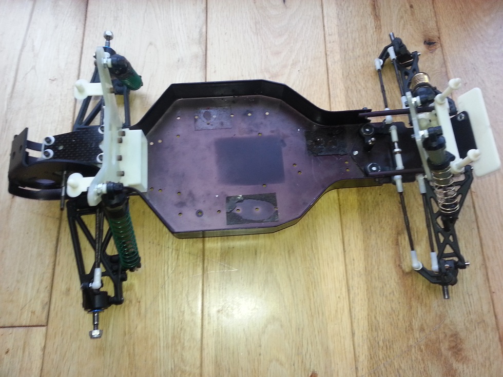

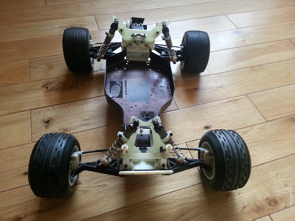

Not a bad days work...amazing what you can get done on holiday from work! :D
Got all of the major bits fitted: B4 Slipper/castor blocks/steering knuckles, GT arms/CVD`s, RPM bearing carriers and new steering assembly.
Need to figure out turnbuckles and slipper parts + rebuild the shocks next.
Posts: 9219
Has thanked: 279 times
Been thanked: 379 times
Re: RC10T Runner
If your going to use the buggy bellcranks (I do too) then you want to move them to yje front holes in the nose, and secure the nose to the chassis with 8/32 screws and lock nuts-otherwise your steering geometry is off
Rayzerp
Posts: 58
Joined: Mon Nov 28, 2011 12:32 pm
Location: Kilkenny, Ireland
Re: RC10T Runner
Post by Rayzerp »
Just changed that...thanks for the tip.
