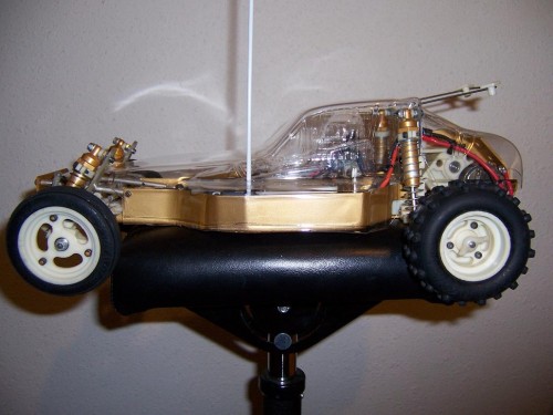

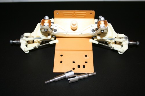

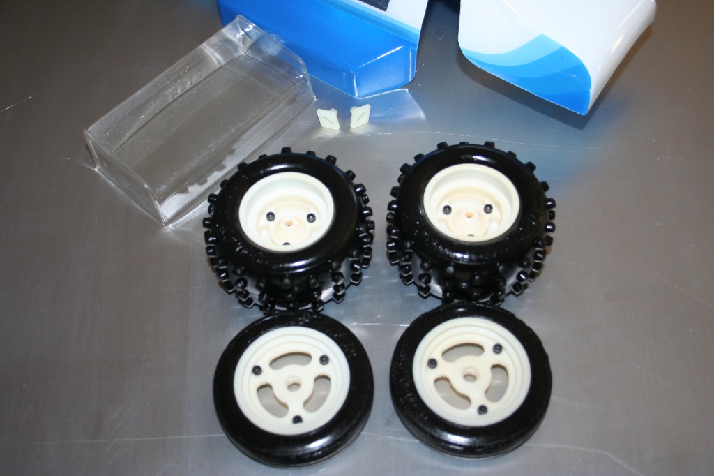

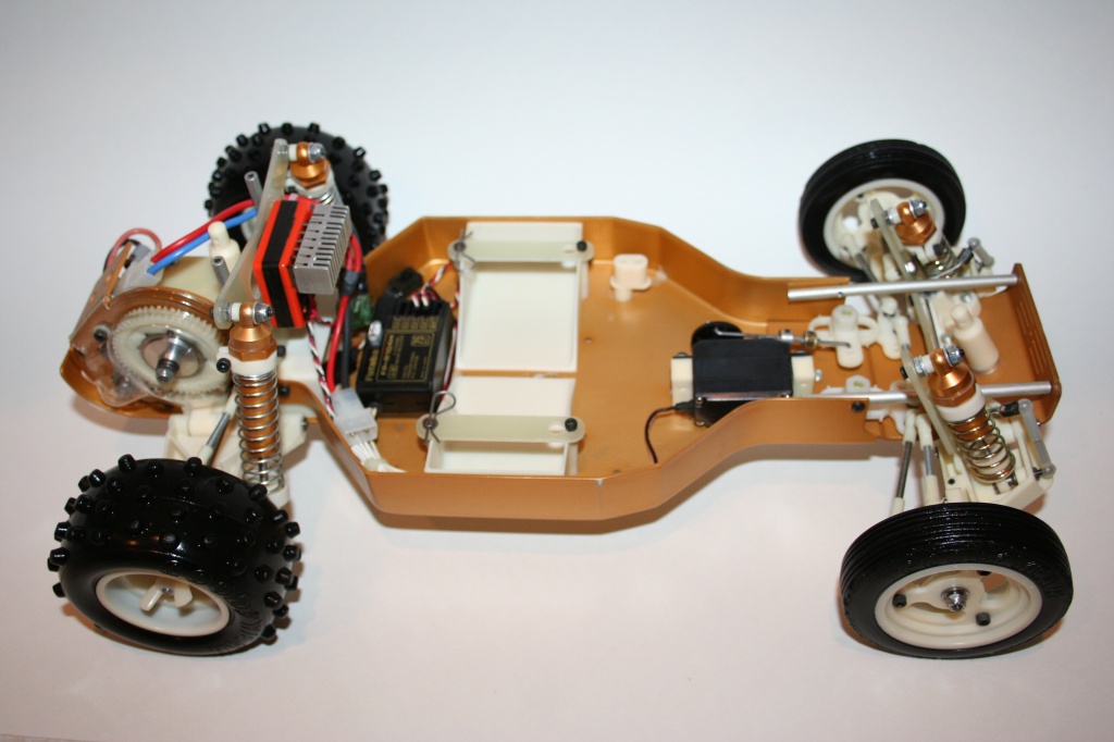

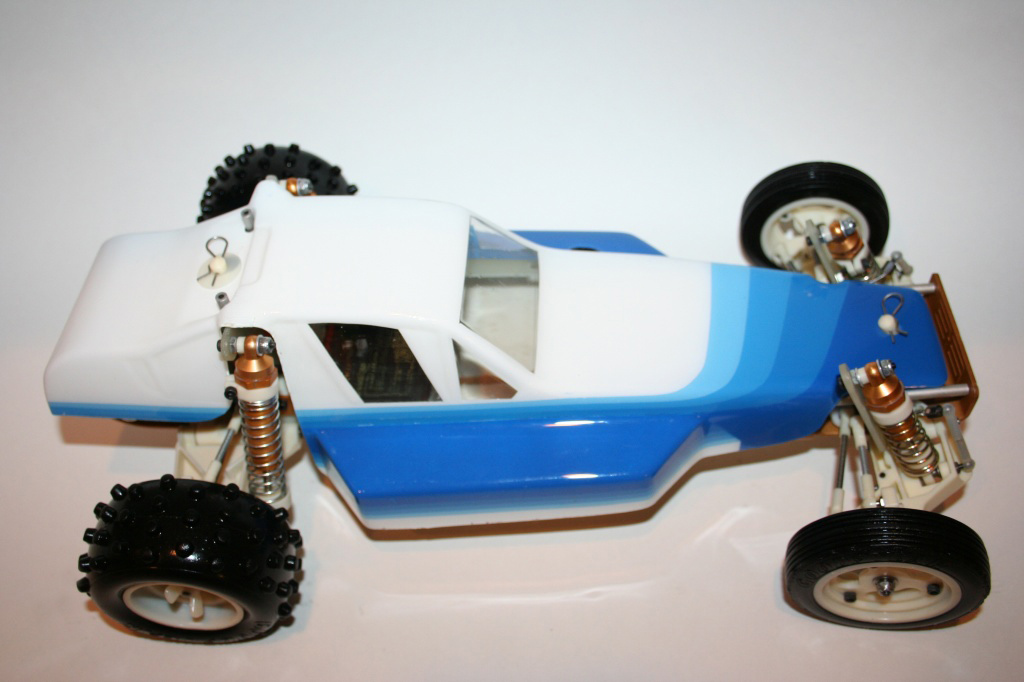

Here is this morning's effort on cleaning up the parts and assembling the front end and tires to wheels. The front end parts turned out nice, clean and white, the rear axles look new here after a lite scotch-brite pad treatment as they did not have any corrosion or wear, check out how straight the dogbone slots are!
After a week of softening them daily using food grade silicone, allowing it to sit for 12 hrs then massaging in more each day, the tires have really turned the corner here and are back in shape to put back onto the wheels, which cleaned up nicely with just simple green.

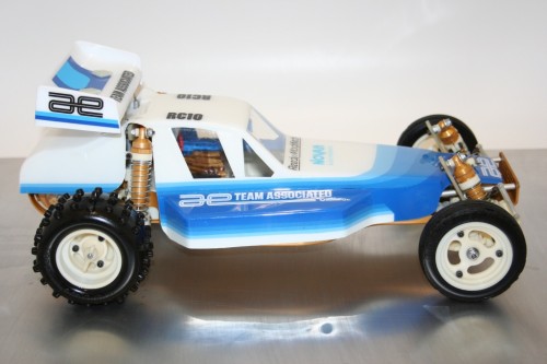

Here is a wing I just acquired from an old off-road buddy of mine that I will paint to match the color style of this body, and the pair of wing mounts I will use with this build. The wing I intend to make look close to the one slotcarrod's car has, shown earlier in this thread.
Curtis' box art car wing has arrived, so his boxter will have a proper wing soon.
More pictures to follow as the restoration matures.

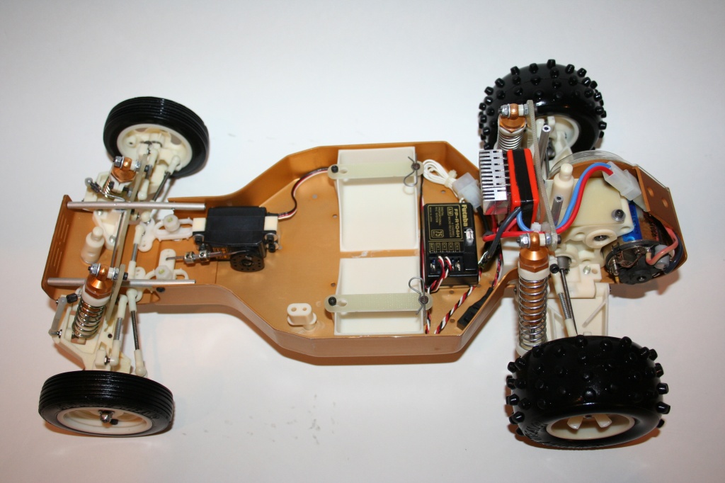

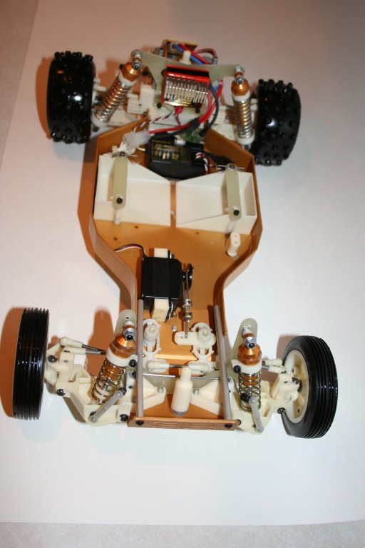

More pics as I am finishing her up, I still have to cut, paint & mount the wing, add the stickers and solder the battery pack together for the transmitter when they arrive Monday.

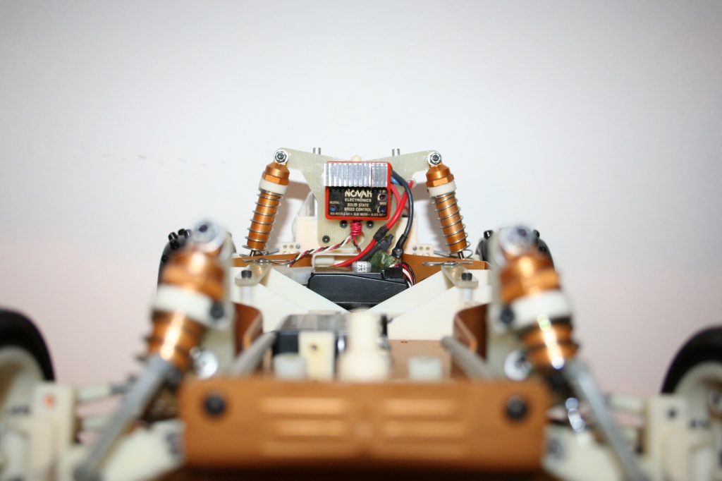

Does anyone know where I might find the instruction manual for this 1st ever Novak with 3 pots, or if someone knows how to set it up please chime in.

One thing I have noticed on your car, slotcarrod's and mine is that it seems that most all the early RC10's seemed to have the antenna up infront of the battery and on the left side. Back in the day when I ran my 1st RC10 with the stock speed control, I had my antenna going out the rear right side of the chassis,next to the controller. I must have been odd. :lol:

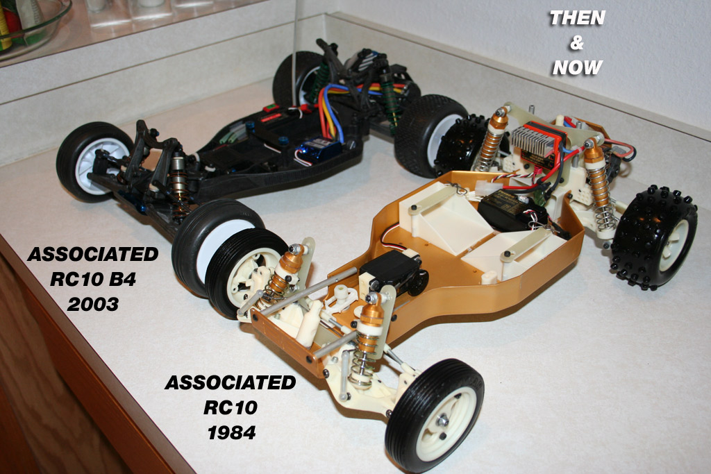

Then and Now with the Associated RC10

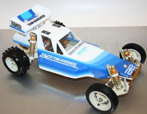

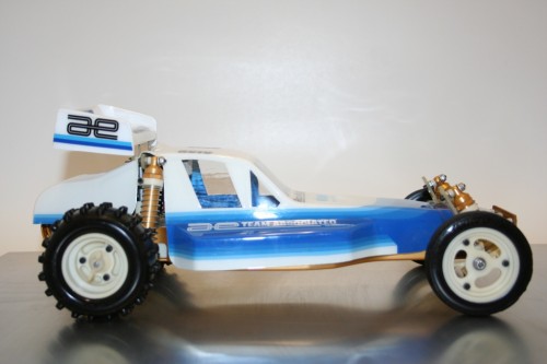

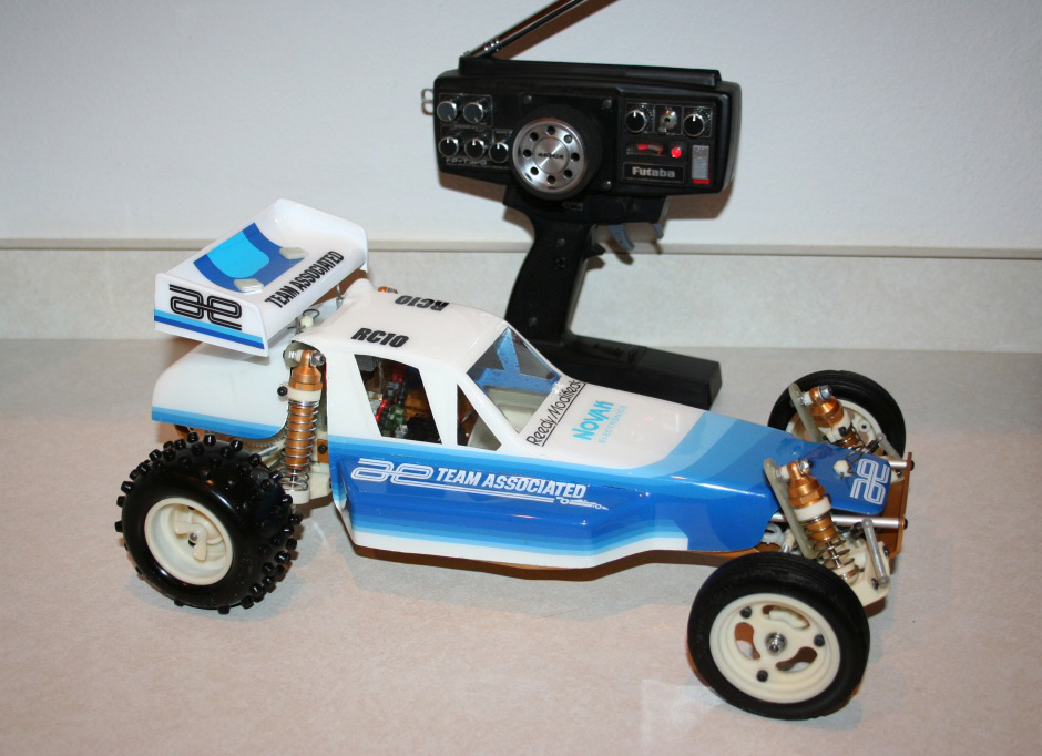

Tonight I tried to do the body that Curtis painted justice, by adding some decals from that era on it. My Wife and I love it and this is now our favorite body, looks "old school'!
We hope you all like it too, especially Curtis. Nice paint job!
DerbyDan, no the tires do not stay sticky. They shine for a bit, then eventually it is completely absorbed or evaporates but the tires remain a deep black color and stay pliable, retarding the aging process.

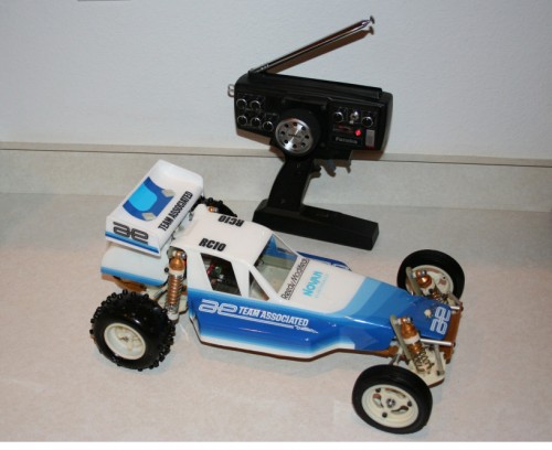

I almost forgot, that today I also put the new Sanyo NiCad battery pack together for the transmitter and she now uses the original charger and charges perfectly. As you can see in the pictures, she already has a full charge after only a few hours on the charger (cells came pre-charged), and works perfectly. The radio was also a restoration in that the battery had corroded a bit, and some of the corrosion passed into the negative wire, so I had to replace the battery cells and the wiring with Mil-Spec teflon coated silver wire for longer life. I also soldered the battery pack using the same Mil-Spec wire on all the cells.
:D
This marks the end of this restoration of a very early edinger RC10 with a "Paint by Curtis Husting" custom body and 1st ever Novak electronic speed control, and early 3 channel Futaba Magnum radio system. I even have a pack of yellow Sanyo 1200mAh 6-cell pack that still charges just fine and will run this in the house (on the rug slowly) a few times before parking it in the glass case with the others.
