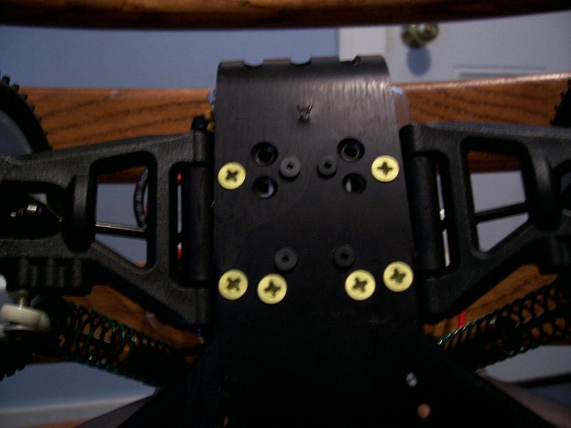

Re: A STAMP BLACK CHASSIS QUESTION
I think thats the one I picked up. Anyway I drilled it for a stealth using the stealth drill jig. I used a 3/8" drill for the counter sink .Lowgear wrote:I don't know what the market value on them is but I sold mine not too long ago and it went for $61. I thought I would get more. I suppose its all about whos looking at the time.faceman2k wrote:No! Don't do that! Your black chassis is very rare!
Oh well, one less undrilled chassis on the market makes yours even more rare!
Too bad for rc10racer, but it looks like he did a very nice job!
