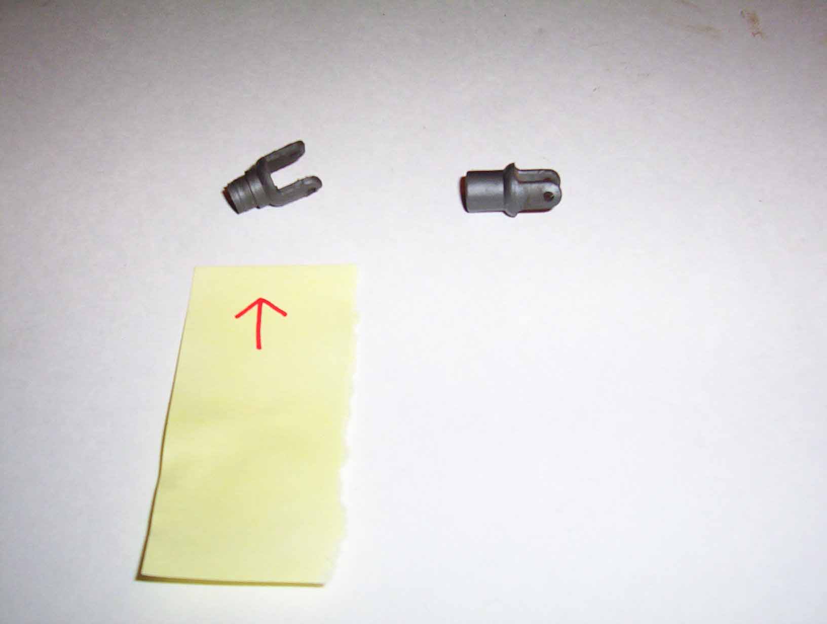

can anyone tell me the part # or what car the one next to the arrow is. I need some for a project and all I can find is the other one.

those are the outdrives from the original LRM trans found on all cars/trucks from the jrx-2 through the lxt.
Don't have the part # handy at work, but I believe they only came in the complete set of driveshaft sliders.
They were used later on as the end of the dogbone on the axle side of the bone setup, and eventually were modified to the one on the right which has a ring around the slot, preventing them from fitting the transmission side.
There re a couple versions of the part on the left, including an aftermarket set by RPM.
What are you planning for them?

I am using them to join slider axels to a 1/8 buggy raybon style. I am converting a 777 to a short course with shorter arms to match the traxxas 4x4 slash so far so good
