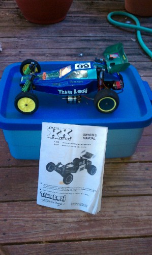

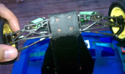

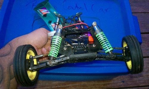

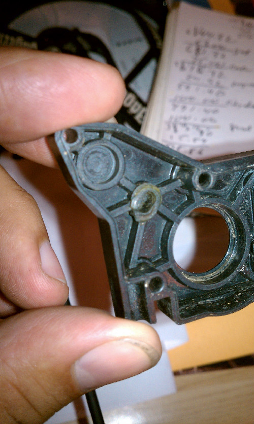

Well I got this of of thr c-list and it doesn't look too bad.Only bad thing is the transmission makes clicking noises.He told me he rebuilt the transmission because the original case got busted.He gave me the broken case woohoo!The holes that hold the middle gear shaft look like they were crushed.So I know the gear is jumping around.So will need a new transmission case.The gear ratio is stamped on the side 2:19:1?I did check out the RPM website they show pix of everything I want for the car (except a new trans case)but they are discontinued.
He did give me a crate full of stuff with it though.Check it out.Sorry about the pix they are off my phone my camera is trashed.

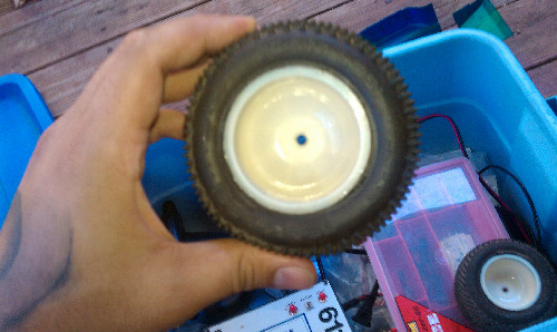

- a pair of truck tires?
- Picture 010.jpg (59.11 KiB) Viewed 1735 times

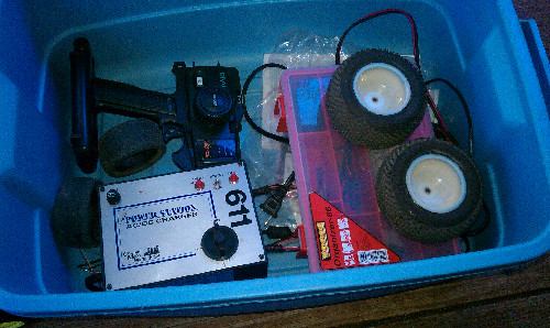

- Box full of stuff
- Picture 009.jpg (85.35 KiB) Viewed 1735 times
- Box full of stuff

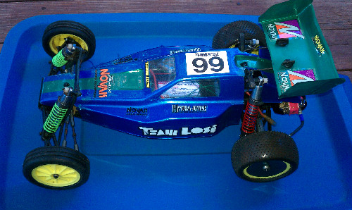

- Front plate is trashed I need an RPM bumper!
- Picture 004.jpg (53.92 KiB) Viewed 1735 times

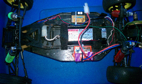

- Brand new Novak explorer
- Picture 006.jpg (93.46 KiB) Viewed 1735 times

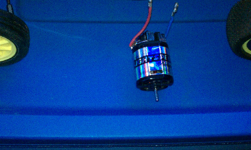

- Brand new lightspeed motor
- Picture 002.jpg (62.28 KiB) Viewed 1735 times

I'll post a pic of the damaged case tonight when I get home so you can see what I am talking about the smashed hole.

Re: craigslist LOSI XX
In most cases lol no pun intended.The shaft the idler is on falls out of place in assembly if not done on the cases side to keep internals from falling out of place.When it does and isnt noticed and tighten tranny screws to motorplate it destroys the inner case.Don
heres what the inside of the case looks like.just wanted to post this so you could see.
That was the original case with the broken mount
