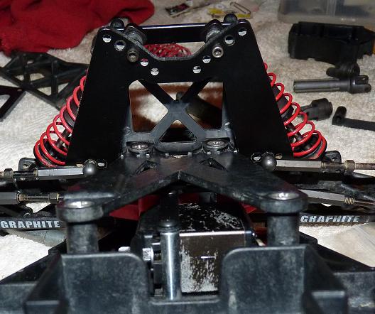

Actually, you can get away with just one steering block (rear...near to the battery cup). I'm trying to remember why I didn't use one for the front...I think it may have been a space issue.adam lancia wrote:There aren't any holes in the chassis but it's certainly not mint. I think I'll be drilling a pair to mount the servo instead of taping it down. Thanks guys!

Hhhhmmmm, interesting idea. Pics pleasehighwayracer wrote:Actually, you can get away with just one steering block (rear...near to the battery cup). I'm trying to remember why I didn't use one for the front...I think it may have been a space issue.adam lancia wrote:There aren't any holes in the chassis but it's certainly not mint. I think I'll be drilling a pair to mount the servo instead of taping it down. Thanks guys!

I used the Blue Aluminum ones from a T4 on mine their small enough to fit both

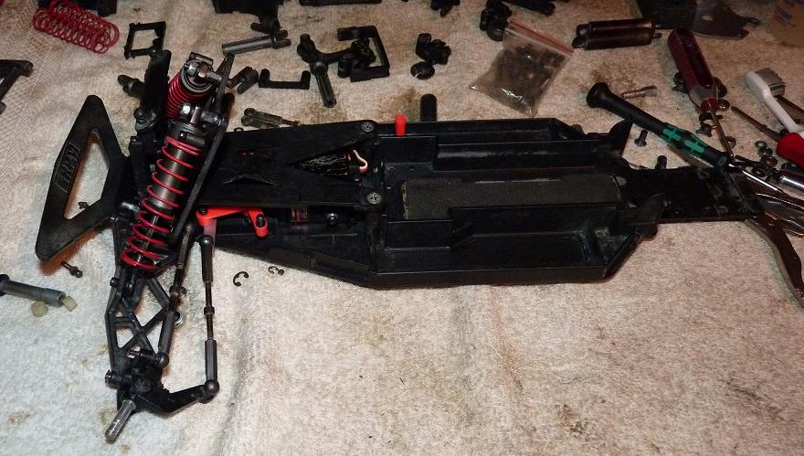

Just a short update a long time in the making.

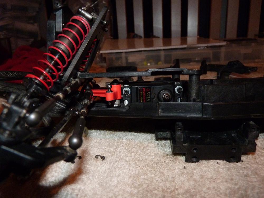

I picked up the Jammin' servo mount and brace set and a wheelbase extension kit (thanks Paul!) but the truck is still sitting in very dirty pieces. I should hopefully get a little time this weekend and on the weekend to start on it but a few more questions have come to mind in the mean time.
Are there any tricks to getting the LRM differential smooth? I've never had any luck with a differential that uses Belleville washers but I'd like to give the transmission a chance, if only because it's got an A&L Power Clutch on it
I think I'm going to give the stock sliders a chance too, but in case I'm not digging them, could someone post the correct part number for the MIP axles? I've got the bones already, I just need the axles. Or, is there a combination of new rear hubs/CVD's that would allow me to use newer, more readily available parts?
I'm going to do a little digging through the Losi section here and have a look at the various LXT's to see if there's any information there to be had. In the mean time, if anyone has any information to ass, I'd greatly appreciate it! Thanks!

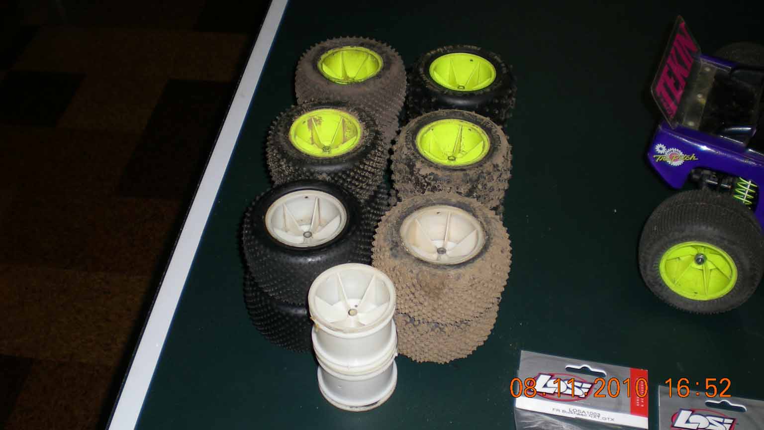

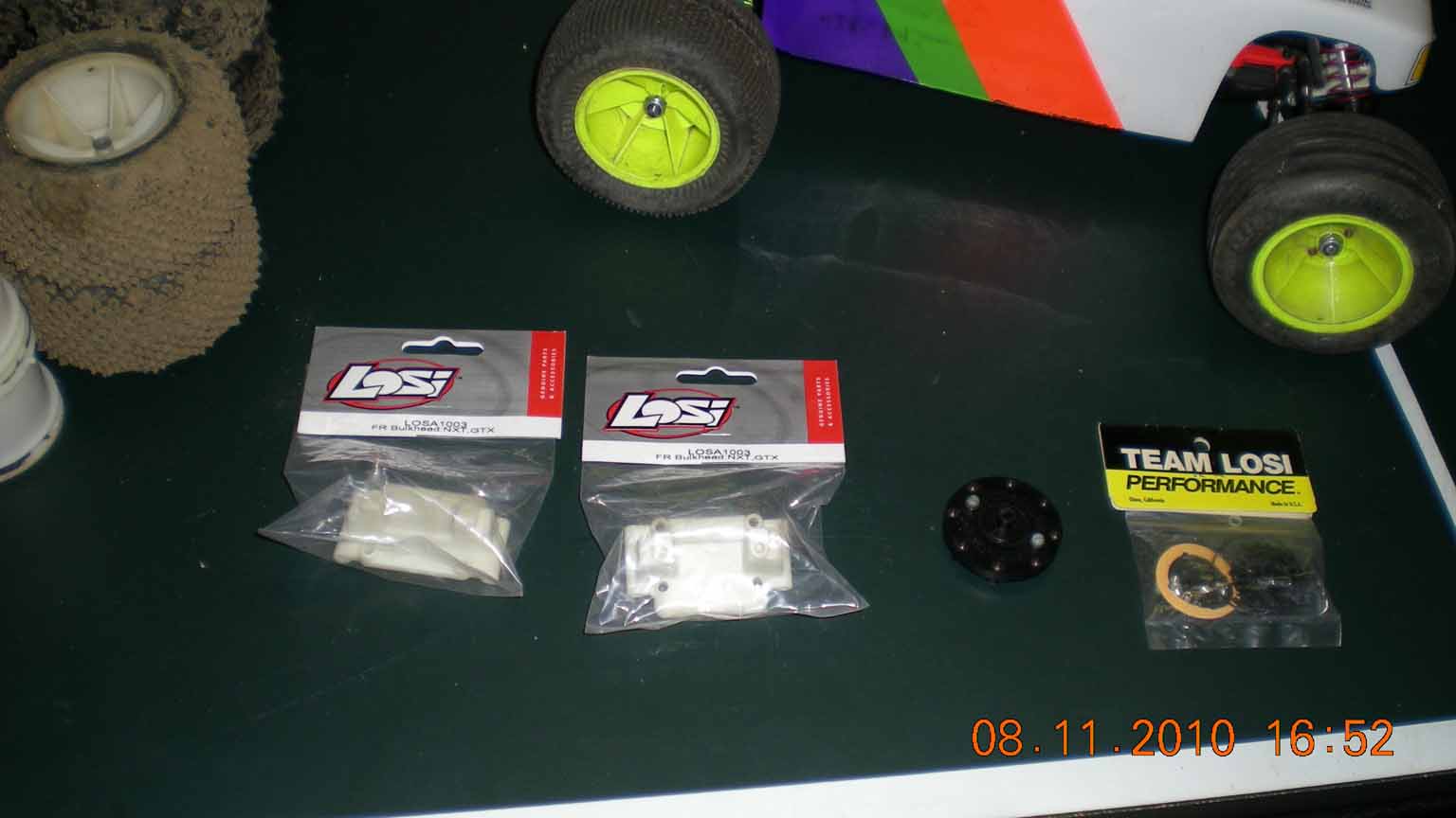

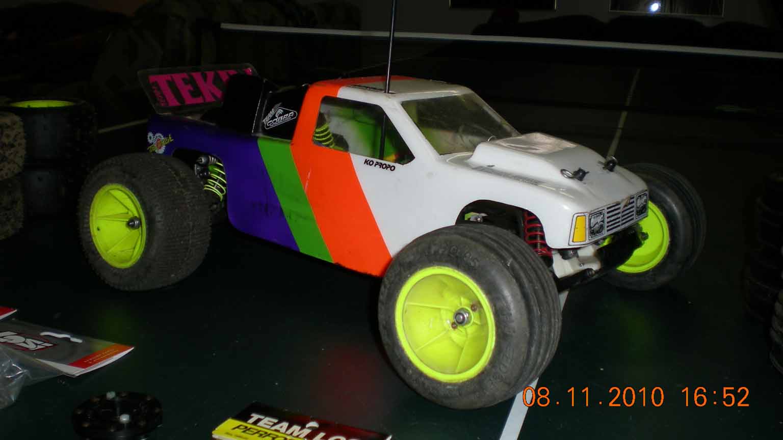

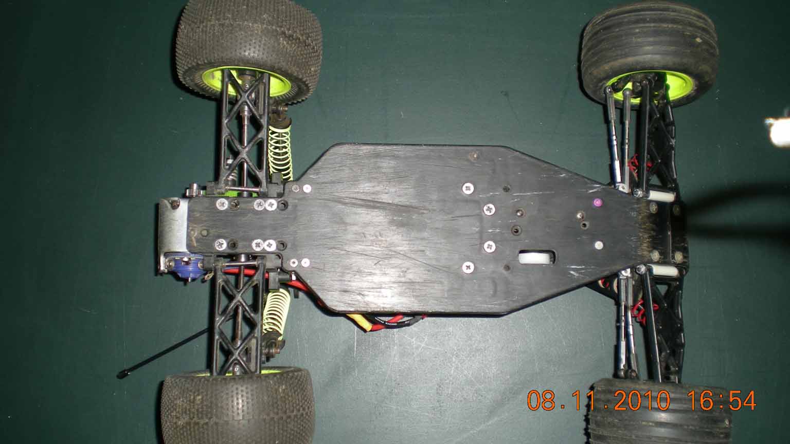

If your looking for another roller for some spare parts and a XX retro fit trans. Here are some pics of what i have. Everything is included except the electronics. The only problems it has is the front body mount needs to be replaced and the battery hold down strap and the chassis has been cut to accept 7 cells. I think that I have some odds and ends that are not pictured. If you have any questions you can just PM me.

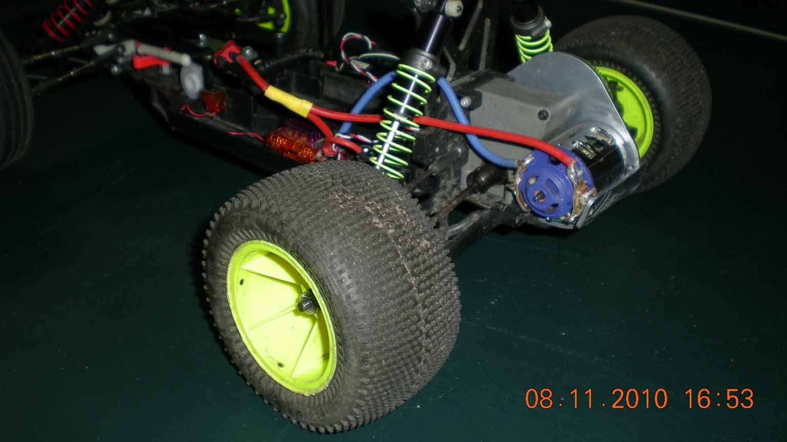

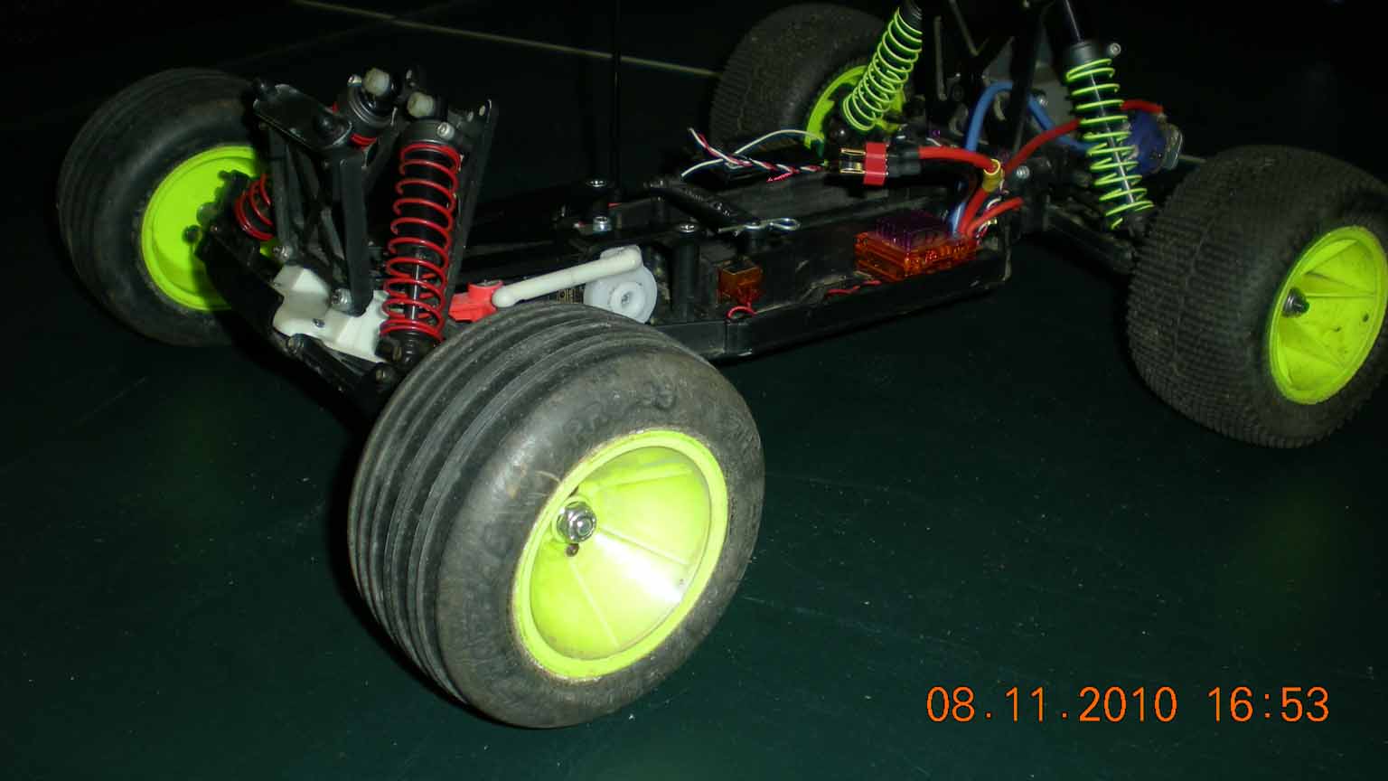

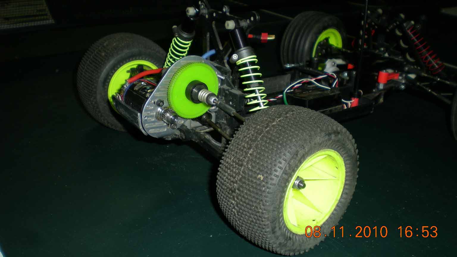

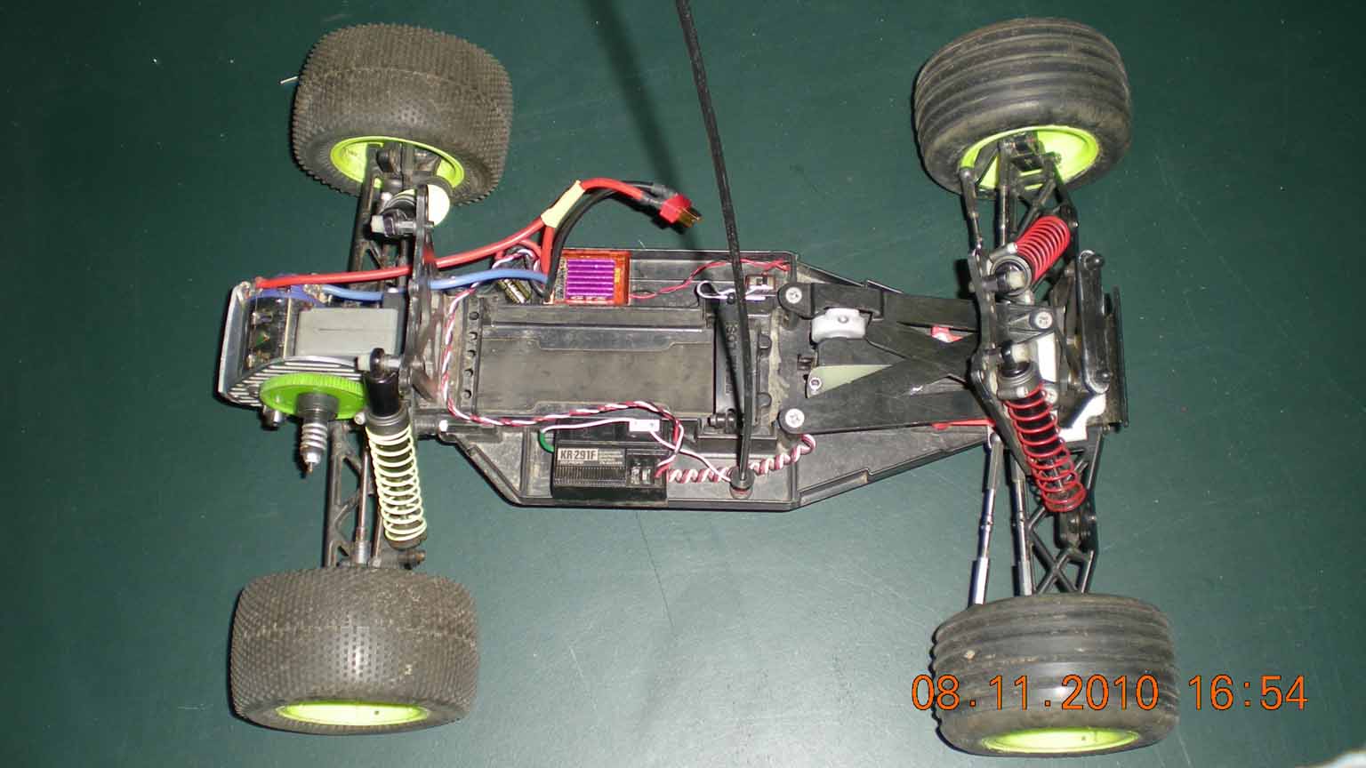

Here are some progress pics of my LXT (finally!!!). I could have it all slapped together but I need a right rear arm to get it completely together. I am working on getting several of those though, hopefully soon. Enjoy!
