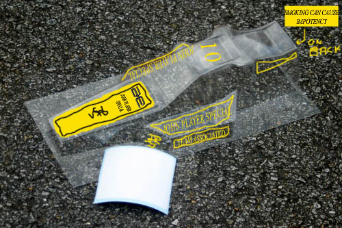

Mr. ED wrote:it's begging for John players special paint job!
It's been growing on me
here is what I came up with so far :lol: :lol: :lol:
mrl-rcps copy.jpg (75.66 KiB) Viewed 1649 times
I think Eau Rouge can paint that to a tee :P
And you are absolutely right about the motor situation :D
