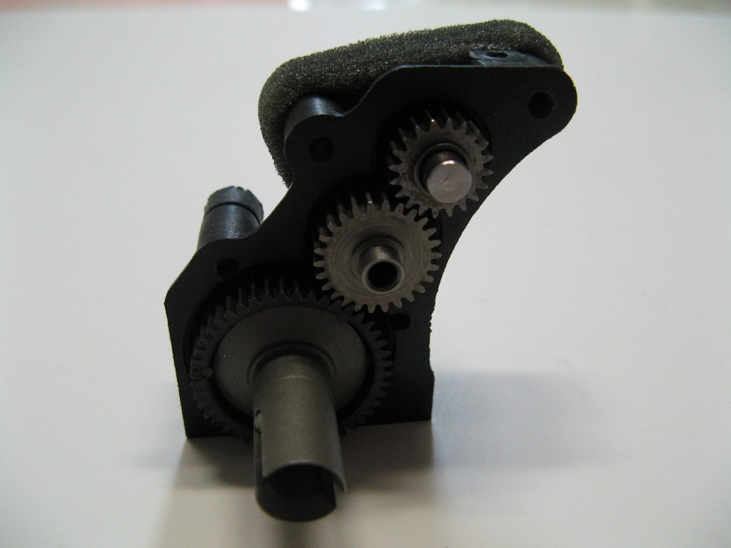

I'm sure these have been done before, but I would still like to share:
Tried a set of Thunder Tiger Phoenix CVD (Part Number: PD9000) and they could be used as replacement for the RC10B2 CVD.
http://www3.towerhobbies.com/cgi-bin/WTI0095P?FVSEARCH=pd9000
Also the Robinson Hardened Steel RC10GT Idler Gear (Part Number: 2213) will fit inside the RC10 Stealth Transmission.
http://www3.towerhobbies.com/cgi-bin/wti0001p?&I=LXPZ87&P=7

HI!... So does anyone know if Robinson's #1513 hardened aluminum diff gear will fit in the vintage RC-10 Stealth trans?
http://www.robinsonracing.com/catalog/gt.html
![Image](http://www.robinsonracing.com/catalog/images/1513_small.jpg)
I sent Robinson a e-mail a few weeks back about the #2213 steel idler gear, and they said 100% that it would not fit in the stealth trans. I guess they were 100% wrong lol!

no, the GT uses the 2.6 diff gear, same as the T2. It is larger in diameter than the 2.25 diff found in the original stealth.THE H.P FREAK wrote:HI!... So does anyone know if Robinson's #1513 hardened aluminum diff gear will fit in the vintage RC-10 Stealth trans?

RRP #1513 diff gear, I believe, fits the B4/t4 tranny.THE H.P FREAK wrote:HI!... So does anyone know if Robinson's #1513 hardened aluminum diff gear will fit in the vintage RC-10 Stealth trans?

HI!... O.k thanks. The original Stealth trans has a 45 tooth diff gear. The Robinson one has 52 teeth.
So their steel idler gear WILL fit in the original Stealth trans?

Yes it will.. T2 and original 2,25 Stealth gearbox used the same top shaft and idler gears
Oh and the Traxxas TRX-3 and TCP uses a 45tooth diff gear ...same pitch too
