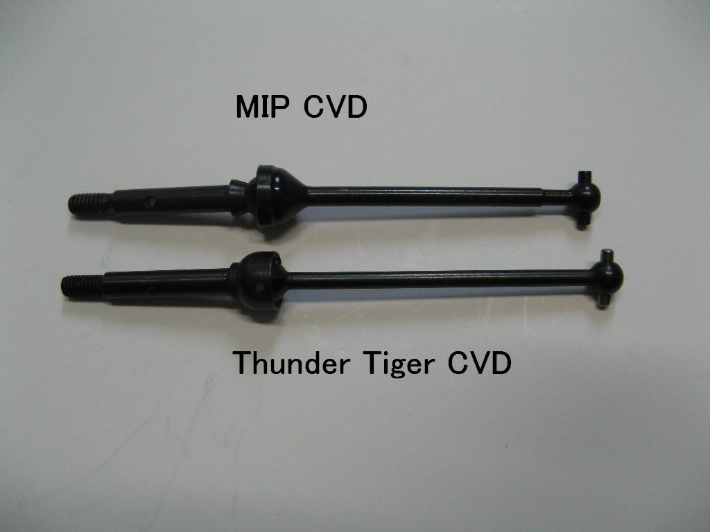

Tried a set of Thunder Tiger Phoenix CVD (Part Number: PD9000) and they could be used as replacement for the RC10B2 CVD.

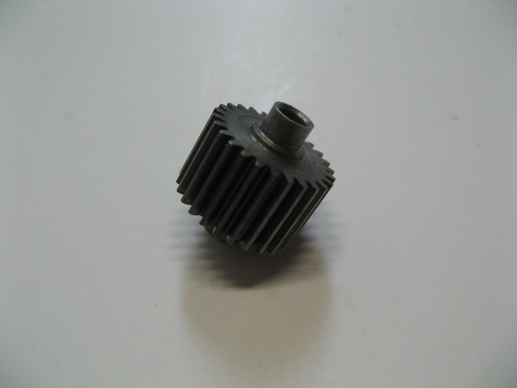

Also the Robinson Hardened Steel RC10GT Idler Gear (Part Number: 2213) will fit inside the RC10 Stealth Transmission.

HI!... O.k thanks. The original Stealth trans has a 45 tooth diff gear. The Robinson one has 52 teeth.
So their steel idler gear WILL fit in the original Stealth trans?

Re: Thunder Tiger Phoenix CVD & Robinson RC10GT Metal Idler
Yes it will.. T2 and original 2,25 Stealth gearbox used the same top shaft and idler gears
Oh and the Traxxas TRX-3 and TCP uses a 45tooth diff gear ...same pitch too
Morten

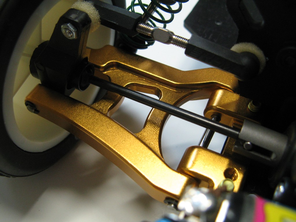

I have a question about the cvds. These will work with the stock length rear a arms right? I just installed a pair of rpm arms and would hate to have to change them again just to run these cvds. Second question is will these axles work with the original rc10 wheels? I have a set of hpi wheels on my gold pan and the current stub axle is tapered where the pin is on it. Thus the wheels have a larger opening where they meet this taper, same goes with the wheels I bought from treehugger. So basically I'm asking if these axles are the same diameter as the center hole on the rims I have?

1:
Yes they will work with the stock arms, The Phoenix is a B2 clone and
the RC10 and B2 used the same length CVD
2:
I used a bearing spacer, from my B2 hub, in the older wheels
3:
No but easy to solve with the spacer in the wheel
Morten
2:
3:
Morten
