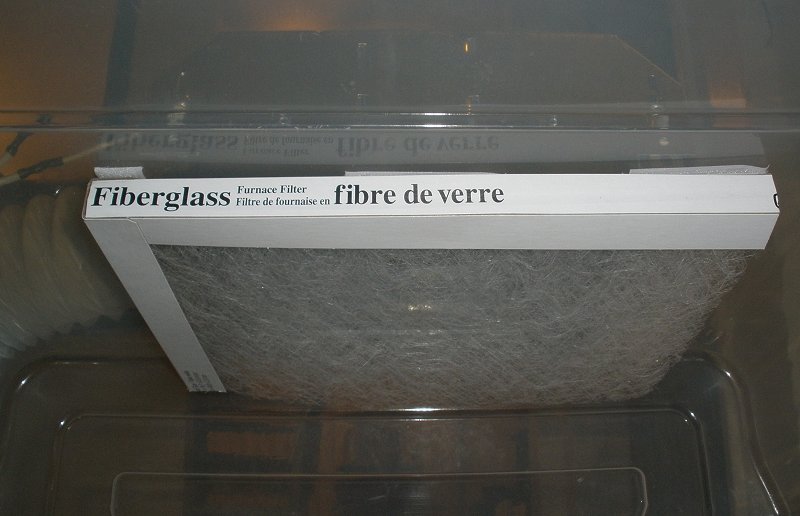

11. Cut off a section of furnace filter to more than cover the hole cut out of the plastic tote. I attached it with Velcro at the corners, for easy replacement. I attached the filter section to the underside of the inside of the tote.

Detail pictures of the completed assembly
Post by Coelacanth »
Some close-ups to show the construction.
