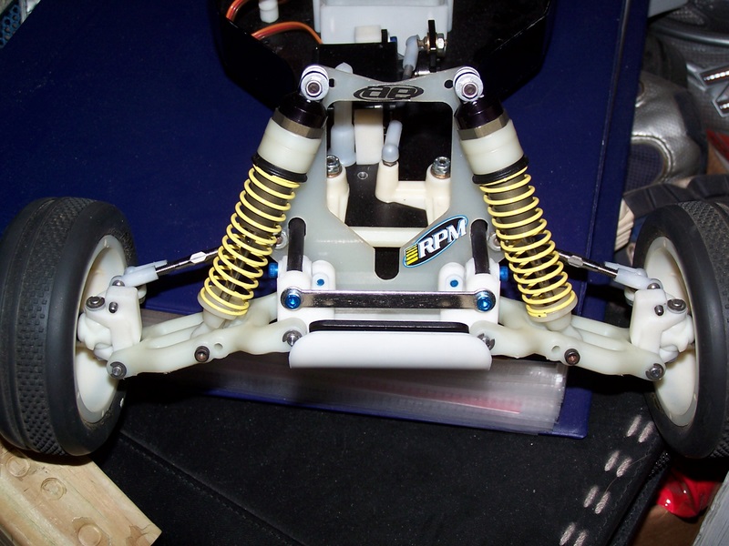

1.02" shock bodies with the .71" shafts would be the same length as 1.02" shocks when compressed, and then approximately 0.31" shorter than standard 1.02" shocks when extended.

Makes sense as to why I can't find any .89" shafts then...scr8p wrote:there is no .89 shaft. the .89 shocks use the .71 shaft. the b44 front shock shafts are .80 (i think). would a .71 shaft in a 1.02 body be the right length for a worlds front end? i don't know, never tried it.
now would a pair of b44 front shocks be the right length for a worlds front end? maybe, but the shock bodies are still too short, so you'll end up putting uptravel limiters on the outside of the shock to compensate for it.

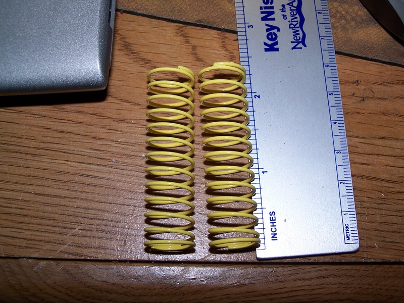

I just picked up 2 pairs of the yellow RPM springs too, $4 per pair, shipped loose with no P/N. FYI...if anyone needs a pair, email RPM tech support (asking for the yellow springs that go to the worlds front end) and they will tell you how to order them.
