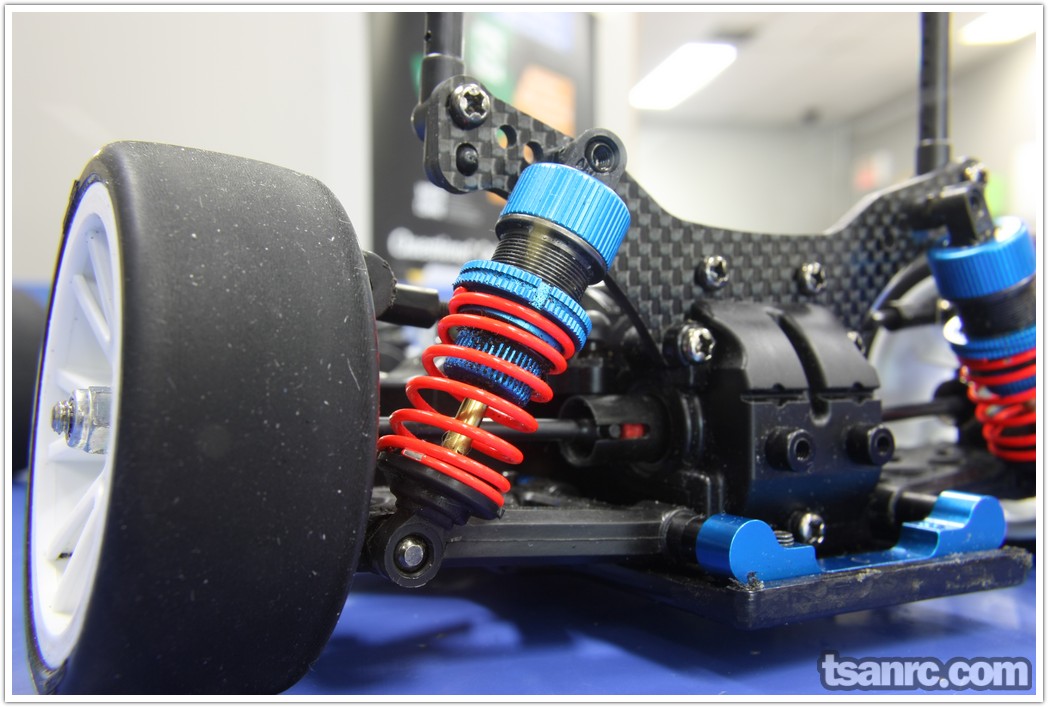

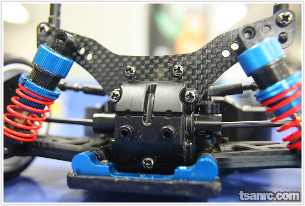

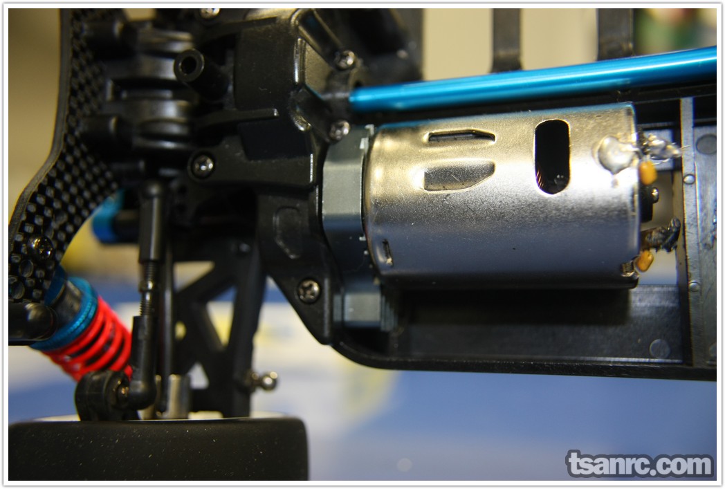

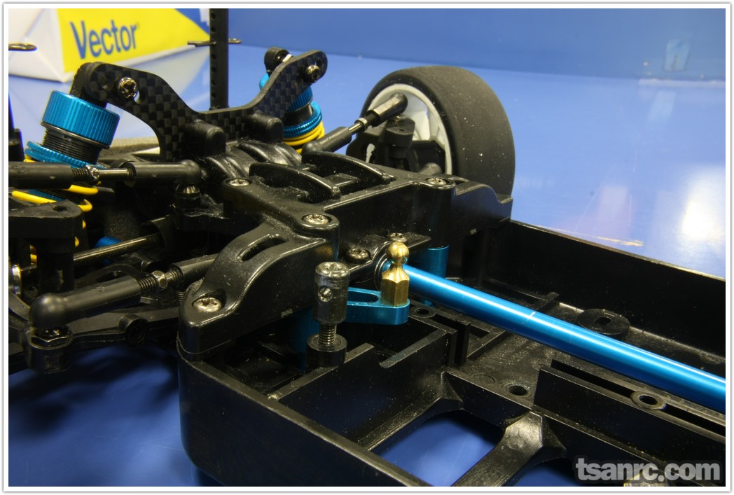

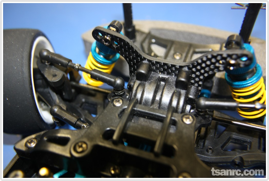

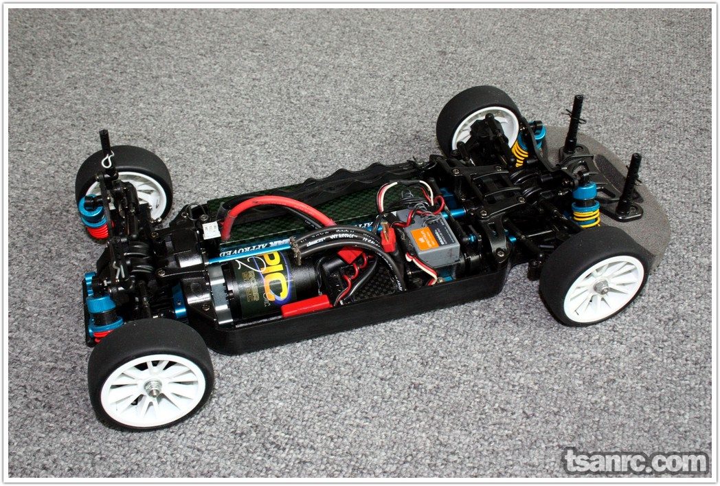

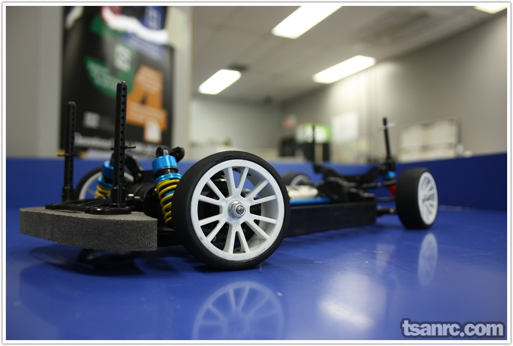

Here are a few more pics of the chassis. Not shown, is a box full of spare parts, 3 bodies (2 used, one brand new) and some old rally tires/wheels. Also not shown is the carbon fiber strip along the bottom of the chassis.
It's too bad about the gearing. If I can't modify it to run 48 or 64dp spurs/pinions, I may have to off load it to buy something else.
Anyone know if the TB03 can reach an FDR of 4.0 to 4.25?

Here's a look at the TB, ready to run tonight:
Not the tidiest of wiring jobs, but when I have a bit more time (i.e. sometime this weekend) I'll sass it up, and hide all the wires. I didn't have time, as I wanted to get it up and running for tonight's impromptu open practice at the Depot track.
Although I have a new un painted Mazda Speed 6 body at home, I just drilled some new holes in last year's super-well-used body. Hopefully this weekend I'll have a chance to get the new body ready for next Sunday's racing.
