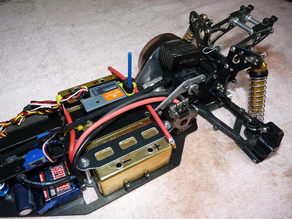

I started building this when I wandered into a LHS that had a bunch of Rubbermaid tubs full of old Kyosho parts. I was originally just looking for a few things for my Optima Mid but when I realized how much stuff they had I decided to try and build a Lazer out of what they had. Well, I would probably put a couple more of them together with the parts I have but I'm going to keep it to one with lots of spares.....for now.
After breaking the rear shock tower mount in a very light roll over, I didn't have another one to replace it with so I had to get creative. After dinking around for a few hours (days!!!) I figured out a way to stabilize what I had left without moving any of the mounting points out of place. In the mean time I've found a few more mounts but will always stabilize them as shown in the pic. That is until Jake machines me a couple out of 7075 ;)
I've got some sort of aluminum bellcrank system on there now but that will be getting swapped out for the blue Kyosho bellcranks I have on the way (thanks jamin!). I've also got a full set of aluminum front and rear arm mounts, plus enough plastic ones to stone the entire Roman army. I stabilized the wing stays with aluminum standoffs. I'm not sure if it's necessary but I like how it looks and I don't think it can hurt any. It's also got a ZXR slipper which I'd like to get a couple of the RW spurs for, just haven't got the Paypal funds right now (also can't find them on the website, any help...?).
In order to get the LiPo's to fit nice and sung against the rear bulkhead I had to remove the 2 outside mounting bosses for the upper deck. I plan on fabbing up a pair of 90* pieces to attach the upper plate to the rear bulkhead from the top rather than from the bottom as it is originally. I've got a set of aluminum rear hub carriers for it but they've got really sloppy bearing bores. I'm going to stick with the stock plastic ones for now, not much can happen to them sitting there with no drive shafts ;) That's also another Paypal issue, as soon as funds are replenished I'll be picking up a set of the proper length CVD's.
Enjoy the pics!

That's an interesting idea for a shock tower brace, Adam, but I wonder if it will be very effective as the ball-ends will allow it to flex. Maybe you could take off the shock tower and use it to trace out on a scrap piece of carbon fiber or something a reinforcing brace like in the diagram, and just bolt it right next to your existing shock tower beneath the wing mount. It would provide extra strength and prevent side-to-side flexing which is what probably caused it to break during the roll-over. Just an idea--this is something I'm planning to do with my Barney Optima because the aluminum Optima shock towers are notorious for bending.

Good idea but it's not the shock tower that's breaking, it's the plastic mount/rear bulkhead that's breaking. There may be a little bit of flex at the ball ends but it's an insignificant amount. Besides, too rigid and it's just going to break something else, like the shock tower.

Must be a common piece to break. Check out this solution. The piece is still broken, but is being held together.

Strange, I raced the Lazer back in the days and I never broke that part. Did Kyosho made this in different type of plastic?

@ daverc: Actually no. I broke the original shock tower mount in 2007 when I started back at racing. No LiPo or brushless then for me, I was running NiMh cells with a 14 double. I got clipped in the air over a long triple, landed squirrely and then the car flipped. Shock mount broke then... Since this mod I haven't had any problems with it.
