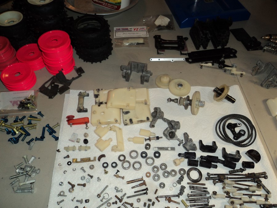

I just started a YZ-10 restoration and after some cleaning found this: :shock:
The front diff is super-glued together! I assume I can soak in Acetone and break it down...but would you do it in the first place? Poor man's posi?

RedScampi wrote:Poor man's posi?
yes. Some of the guys locally have been doing this in their slash 4x4s. Its ugly and leads to more problems down the road though...

I have seen this done to the rear diff, but it doesnt make the car work better than a properly functioning diff. other than it never comes loose and causes the car to push like mad. BTW that is a rear diff pulley.

Justjoe wrote: BTW that is a rear diff pulley.
oops, yes, you are correct! My bad.
Thanks for the info guys. It's soaking in acetone now.

I had a yz10 that had the glue treatmet as well. I gave it an acetone bath and found that there were no diff balls. I guess the previous owner didn't want to buy them.
Actually, your car looks like there's a lot of potential. You have some mugen bull dog tires on it. If you decide to acetone tohse, let us know if the tires survive. There's another member that had questions about acetone and those tires.

Hey guys, thanks for all the replys and encouragement. I've decided to turn this into a build thread. I agree about the satisfaction of bringing these back from the dead. It's more difficult by far than building new. Each piece has it's own special challenge. The Bulldog tires were toast upon arrival unfortunately. They basically fell apart in my hands. This car is rough but it has good bones. :lol: Thankfully I have amassed *ALMOST* enough parts to do a reasonable restoration, I think. I need a backbone (for the car!)
The chassis was hammered but I was lucky to find a really nice one on evilbay. The front magnesium bulkhead was broken too, but I have a replacement. I have several plastic front and rear bulkhead covers in varying condition. None perfect but I think I can make one of each work. One of the cover screws is broken off in the rear bulkhead, pretty much flush. Does anyone have an idea of how to get it out? The diff freed up after a day or too of soaking in acetone. I washed it with soap and water then sprayed it out with WD-40.
Here are some current state pictures. This probably will not be a box-stock rebuild. I just want it to be a nice example. 8) Let me know your opinions and any suggestions.
