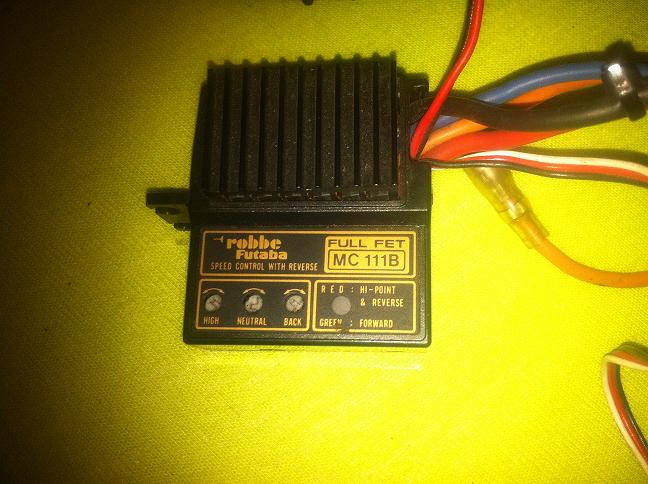

hey i have an mc111b ,
its been a wile sinds i ran it , but as i remember it would only go neutral or w,o,t
is that normal or is it in the settings of it?

W.o.t? With oy throtle?
You need to set tyhe neutral first with the tx srttings set to middle.

It's not normal. I had one of those or similar long ago.
It sounds like you got the neutral set up right but the 'high' needs ajusting. Or: you have set it up backward and need to flipt the trhttle direction of your transmitter.
The settings to the best of my memories and with help from your picture:
0. put your car up so the wheels can run free
1. with a tiny screwdriver turn all 3 potentiometers to their stop (counterclockwise)
2. put your throttle trim to zero and leave the trigger/throttle in neutral
3. turn the middle potentiometer ('neutral') clockwise till the wheels start spinning fwd and the green led comes on
4. now slowly go back counter-clockwise till the green led goes off
5. disconnect one or both moterleads
6. trigger/throttle to topspeed
7. slowly turn the first potentiometer ('high') clockwise to find the spot where the green led turns red
9. from that point give it a tad more; just a few degrees, clockwise
10. let the throtle go and verify if the neutral is still ok: led=Off (adjust if needed)
11. give a little throttle= led turns green
(If you don't see a green led you got it setup backwards and need to switch the moterleads and flip the throttle setting on your transmitter.
12. full throttle: led turns red
13. time to set up the reverse: my memory is vague on this. Either the 'back' potentiometer sets the timedelay between forward and reverse or it sets your topspeed for reverse. just connect the moterleads again , pull the throttle full reverse and turn the 'back' potnetiometer to see if it affects the s topspeed for reverse

Re: robbe mc111b
Great!
Glad I could help
Don't forget those were on the market when batteries were only 1200mah. If you use modern packs with double , triple or more run-time make sure to regularly check the ESC heatsink and take a break when it starts getting really hot.
(I destroyed mine trying to make it run for 8, or was it 5, minutes back in the days at our clubraces)
Glad I could help
