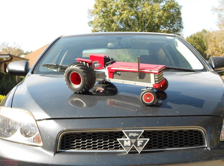

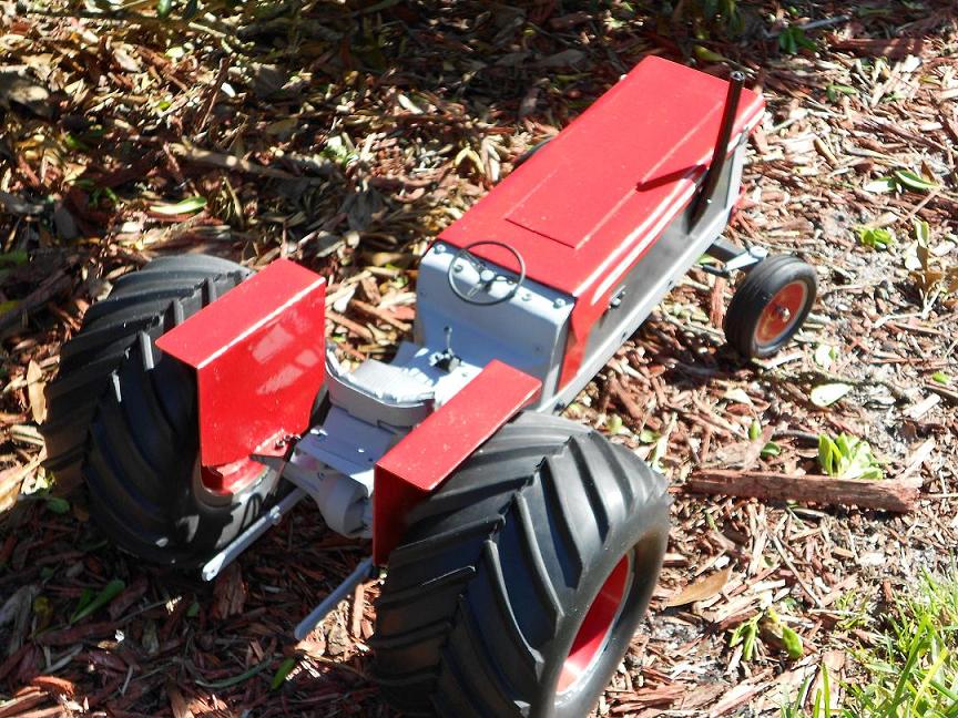

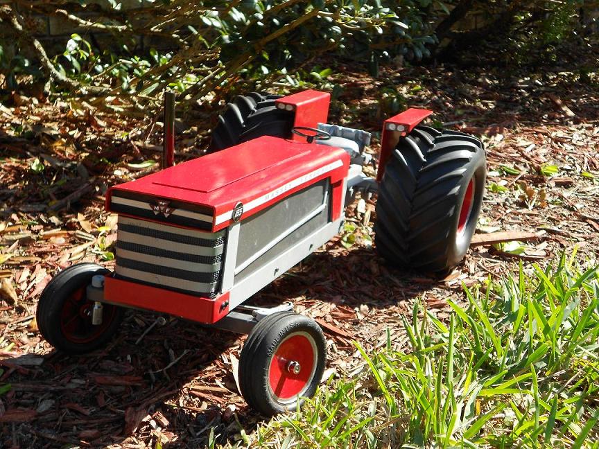

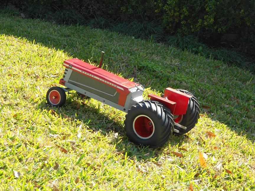

Here's my final RC project...A 1966 Massey Ferguson 165 ag tractor. It's entirely hand-built using a dremel, with metal from K&S and the local hardware store. The front axles and steering linkage are from DuBro. The hood is styrene plastic, and I used a gearbox and rear end from an Axial crawler. The motor is a Venom 50-turn crawler, with an Associated ESC and Futaba radio gear....It runs about 6-8 mph (it's a tractor, what do you expect?), but it can climb a wall. I figure it was a fitting end to my RC hobby, since I sell parts for the REAL ones. (Maybe someday, I'll consider restoring another RC10.)...Enjoy!!

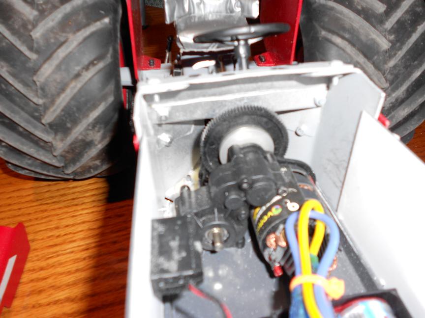

Hcp22: Here you go...
guts2
guts2
guts1
guts1
The driveshaft is slightly angled to line up with the rear end. The yokes are steel, with set screws on both sides. It's too much of a pain to take apart (I hope I never have to). The antenna runs up through the stack.

I found an engine pic for the sides while looking through Bing. That really finished it off. I'll have to bring it home and take a couple of pics... Right now, it's on the counter at work. The boss loves it! He drove it all over the parking lot and yard, and was like a little kid...He mentioned bringing it to the next Ag show when we have a booth. But first I need to make a Bush Hog mower to tow around....and I thought I was done.

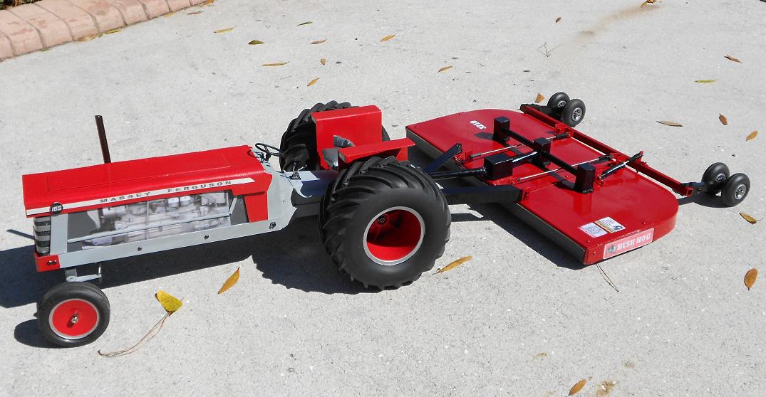

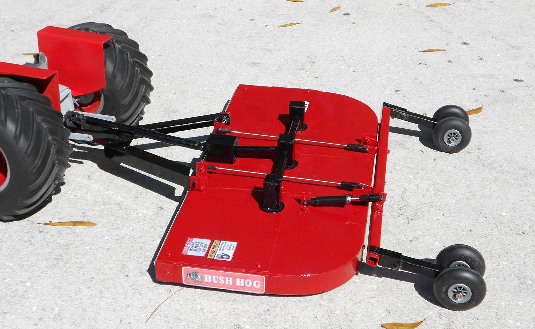

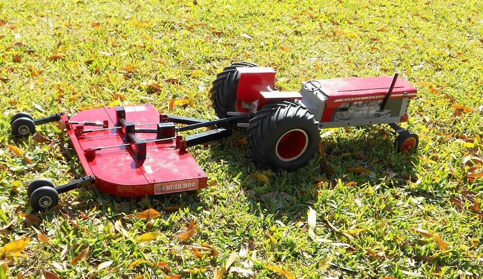

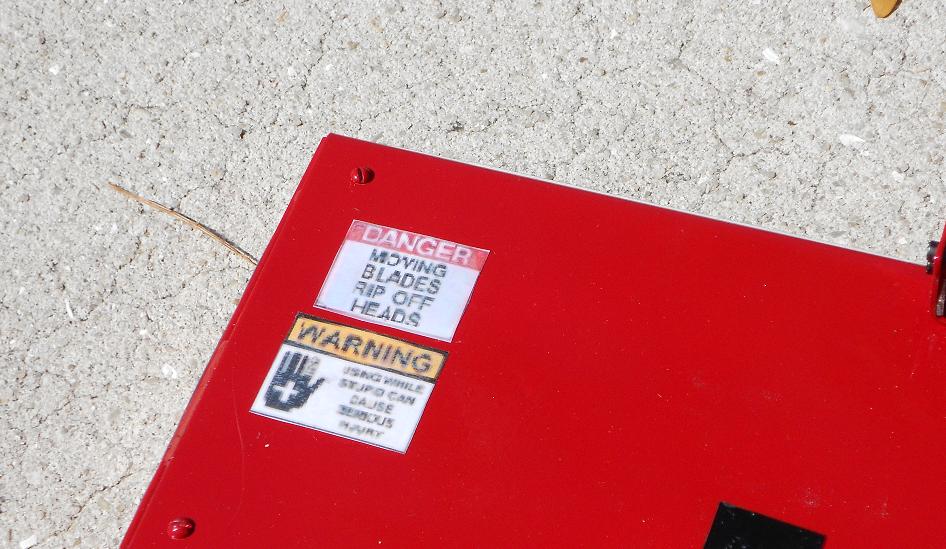

OK...NOW I'm officially finished. My boss thought it needed something to tow, so here it is...(no, it isn't functional.)
I had to add a drawbar and PTO housing to the tractor in order to make the connection look right. Note the engine pic added to it.
...Still no luck on the Daisy Duke doll.
