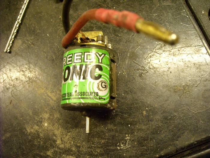

Does someone have any knowledge on this one?
I found it in my secret forgotten put-away hidden box and hoped to put it on a mk I Ultima.

I HAVE TWO REEDY Competition stock motors that have SP on them and two blue associated stock motors one with ST and the other has a 2 ON IT.I always wonfered what this ment.DON
The marks im referring to are on the shaft end of the can and mine are yokomo end bells too.

That'd be an 11 turn quad according to my old Reedy motor sheet. Unfortunately I can't attach the .pdf file. If anyone wants it, PM me with your email address and I'll send it to you.

Thanks for the information -adam lancia wrote:That'd be an 11 turn quad according to my old Reedy motor sheet. Unfortunately I can't attach the .pdf file. If anyone wants it, PM me with your email address and I'll send it to you.
I guess 11 Quad is a bit too agressive for the Ultima. So I´ll dive in to the pile again

It should be fine. 11 quad sonic is not that hot a motor. six cells BITD, a 10 turn was very common for 2wd. -Jeff

Thanks - I´ll give a shot thenJay Dub wrote:It should be fine. 11 quad sonic is not that hot a motor. six cells BITD, a 10 turn was very common for 2wd. -Jeff
