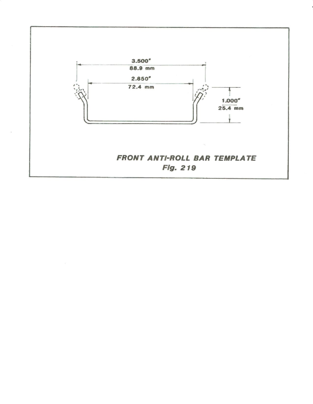

Hi all,
Does anyone have a list of all the parts needed for the antiroll bar assembly? I know there's the bar, the ball cups, and the ball rod ends. Where can I get the ball cups? They don't look like the regular ball cups. What about the ball ends that go into the a arms and attatch to the antiroll bar? I got a short-arm late Edinger off ebay that only had 2 of the four ball cups and a broken antiroll bar.
Thanks for answering noob questions!

here are the cups and the screw, ball end.

So those are the ball ends that go into the a arm, it looks like. I'd also need a 4-40 threaded rod, easy enough to find. The antiroll bar can be found on ebay. But the ball end that goes on the bar has a solder cup attatched. What's the brass thing for? Great find, thanks!

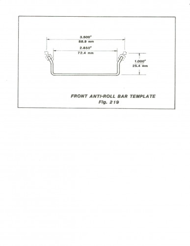

This will work for the solder on ball link. The brass parts in the kits aren't used.
Tower also has the wire and the pattern for bending is in the manual .

Can I use the tc6.1 antiroll bar wire?
