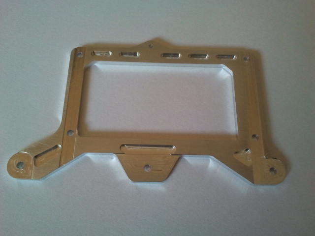

I know in Germany a few guys run axle spacers to get to full width. Although VIP Performance in germany used to offer a special lower pod plate to facilitate a true 235mm conversion, as many do not like running the CRC adapters - they cause an imbalance, add weight, and are just overall a bad solution. Oh and this is based on the fact that they run 7.4V Lipo and low wind Brushless on Asphalt.
VIP can be found here: http://www.vip-rc.com/start/
