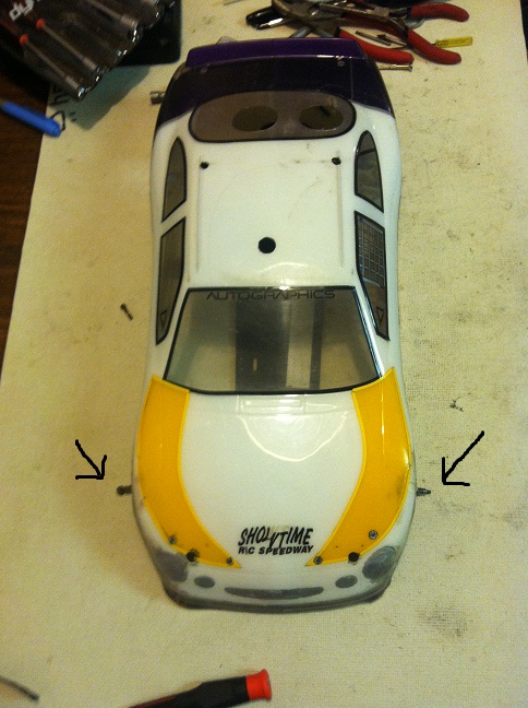

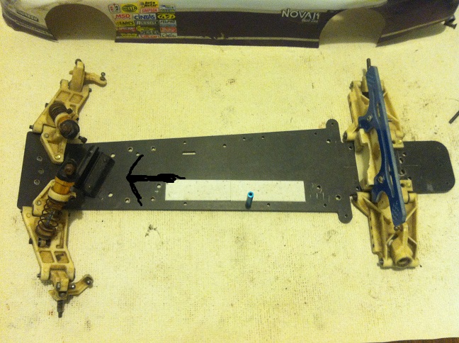

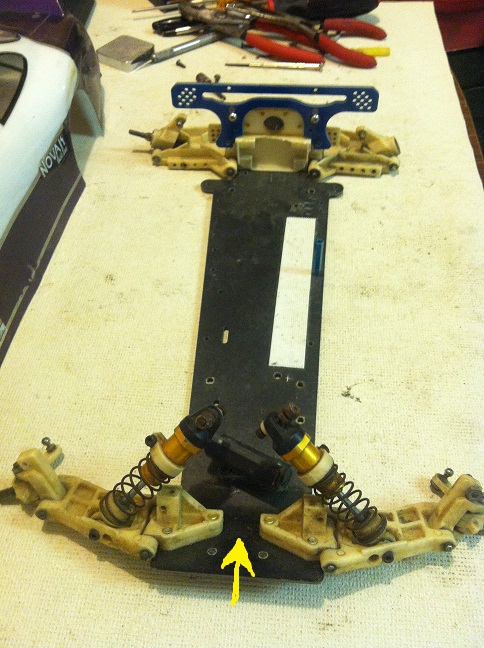

OK so im a pure offroad racer, been all my racing life with a little sedan here and there, i have raced oval a few times. Not by choice more like went to the track expecting to race offroad but they where racing oval , so i raced it and thats about my racing extent for oval. well the other day i went to the track and they where racing oval,i just went there for a part. While i was there one of my offroad buddys was there racing his sprint car and he asked me to drive it. I said hell ya (any chance to drive something im all game) so i grabed the radio and started doing laps. It was cool than he told me my lap times where on top of class, i said no way ,and he showed me the lap times average lap for sprint class was 5.8 to.6.1 i was running consistant 5.8 to 6.0 with even a few 5.7 no joke! I was pretty stoked. I havnt even driven on a oval for at least 10 years. So we started talking about me racing oval. i said well lets see what i have at home and lets see what i can come up with. I dont want to start racing oval with any seriousness but if i can throw something together, cheap than hey i might show up and race every now and than!
so this is what i have that i think i can throw together for a late model class.
so here are my questions
as you can see from the pics the front end sticks way past the body, im not stuck on this body its just what i have is there any way to narrow the front end other than moving the front mounts in,and cut the chassis a lil to allow the a-arms to swing. I will be running foams
for that seems to be the tire of choice.
or is there short oval arms that i can get to fix this. i will be making a custom shock tower
also do they still make oval rims and foam tires that can bolt on 1/4 cvds in the back and stock fronts
are would it just be better to get a wider body,this body is 7-3/4 wide im guessing i would need one about 9"
also thinking about running front shocks with limiters all the way around
in the one pic there seems to be some type of slider steering rack that will be gone
so any help, ideals, advice etc etc
thx farmer
also mods we dont have a oval forum so if you feel this needs to go somewhere else
thx farmer
thx farmer
thx farmer

Don't cut that chassis!
That body is for narrower pan cars and you just need a different one....a wider one built for a 235mm/9" track width. McAllister sells some you can use, or you can get a Latemodel oval body from Custom Works.
Honestly that chassis should be used to build a sprint car...especially if you're going to race against sprint cars. If you want to build a street stock oval racer a tub will do the job. There's more than a few oval builds in this forum that do just that.

I agree with Phin, I would not cut the chassis, I think there was some short arms made but im not sure if they are easy to find nowadays. I hasve a set of andys short arms on my Ascot Sprint car, Here is a picture of them, Its actually for sale on ebay at the moment so its all boxed up and i cant get any better pictures lol. (Not trying to sell is in this thread, just the only car i have with short arms for a sprint car)

these 9 and 10 inch bodies will fit plenty underneath
http://www.mcallisterracing.com/index_files/Page801.htm

i would leave the slider rack on. they are great for saving room on the chassis.
i agree with phin, that chassis was made for sprint cars so you might as well.
sprint cars are the most fun you can have on oval imho. the best racing too.
if your stuck on a street stock/bomber class a gold pan chassis or even just a hacked out, home fabbed g10 chassis will get you going plenty fine.
what would you say your price range is for getting the car built? ive built stuff with cobbled parts for no more than 20-30 bucks and ive seen guys drop a grand on the track trying to beat 30 dollar cobbled cars.

regular old gold pan will work just fine actually. that chassis is in good shape and not super rare but atleast still pretty desirable imo. if you had the cage parts you would have something special.
we have a 17.5 latemodel class that is based around 2wd buggies and atleast 60% of the class is gold pans and graphites. turning same laps as the b4's and what have you.

farmer, the original stock short arms would bring the front end in quite well for ya
I think you would still need a wider body.
