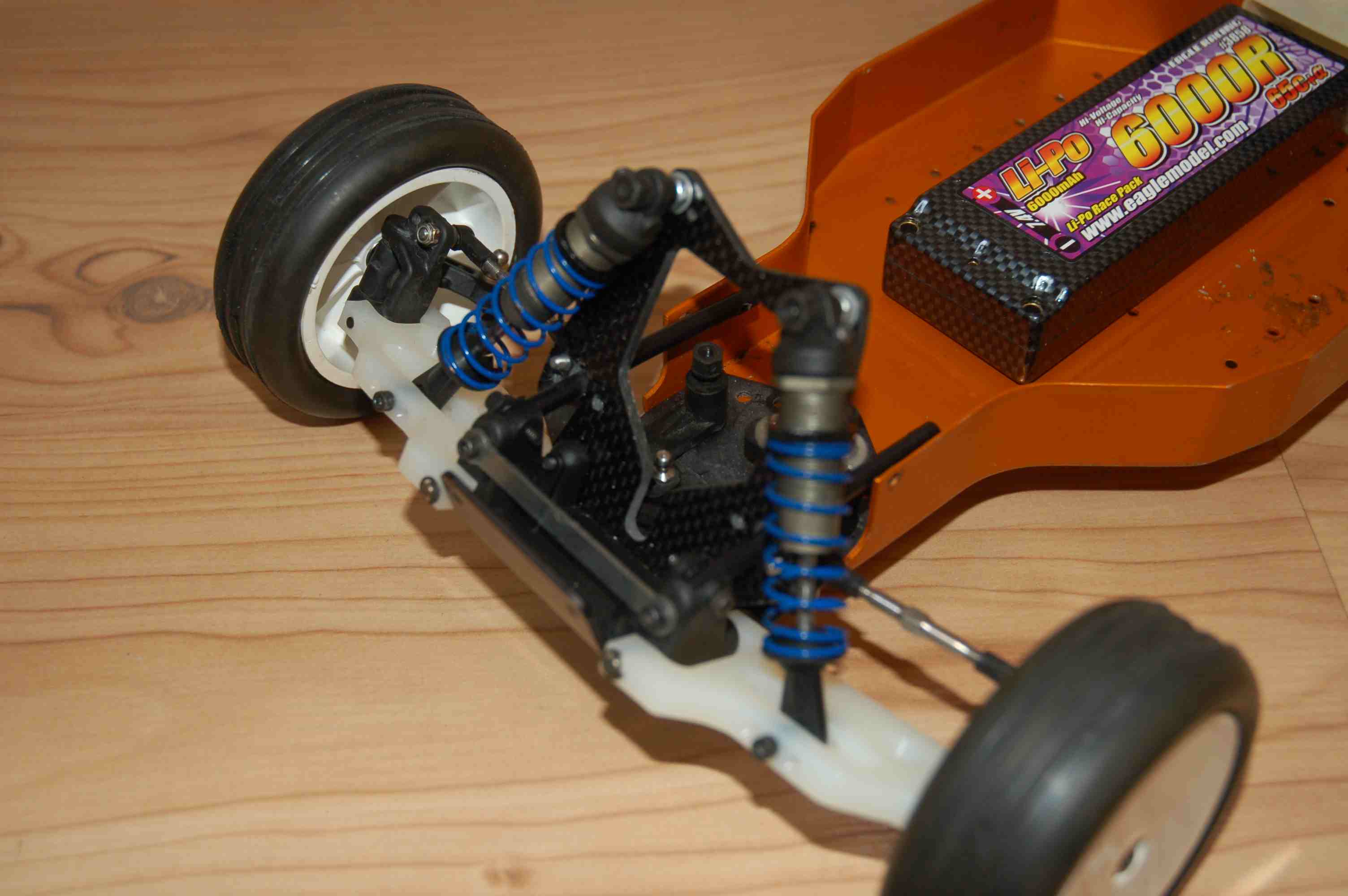

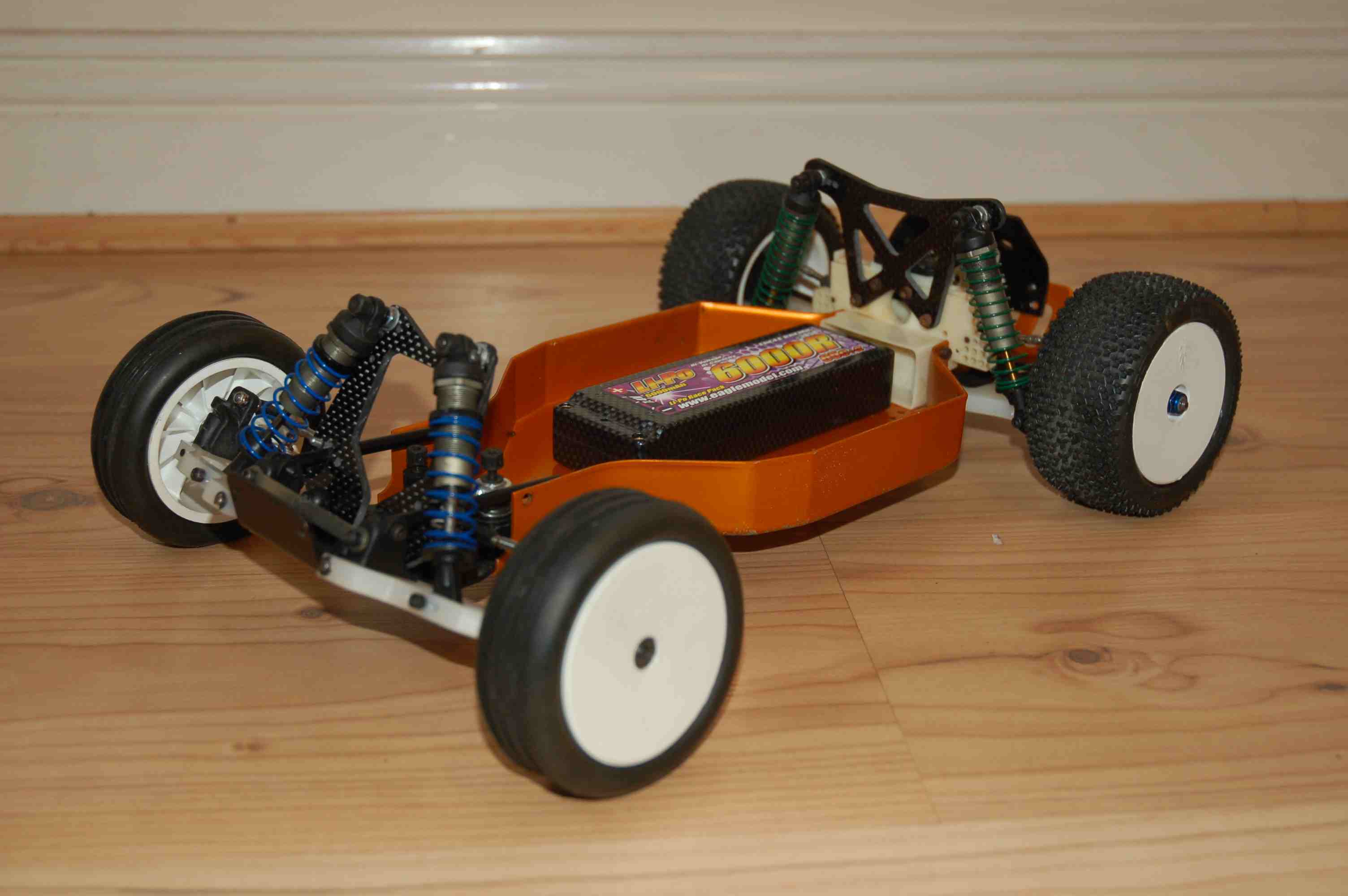

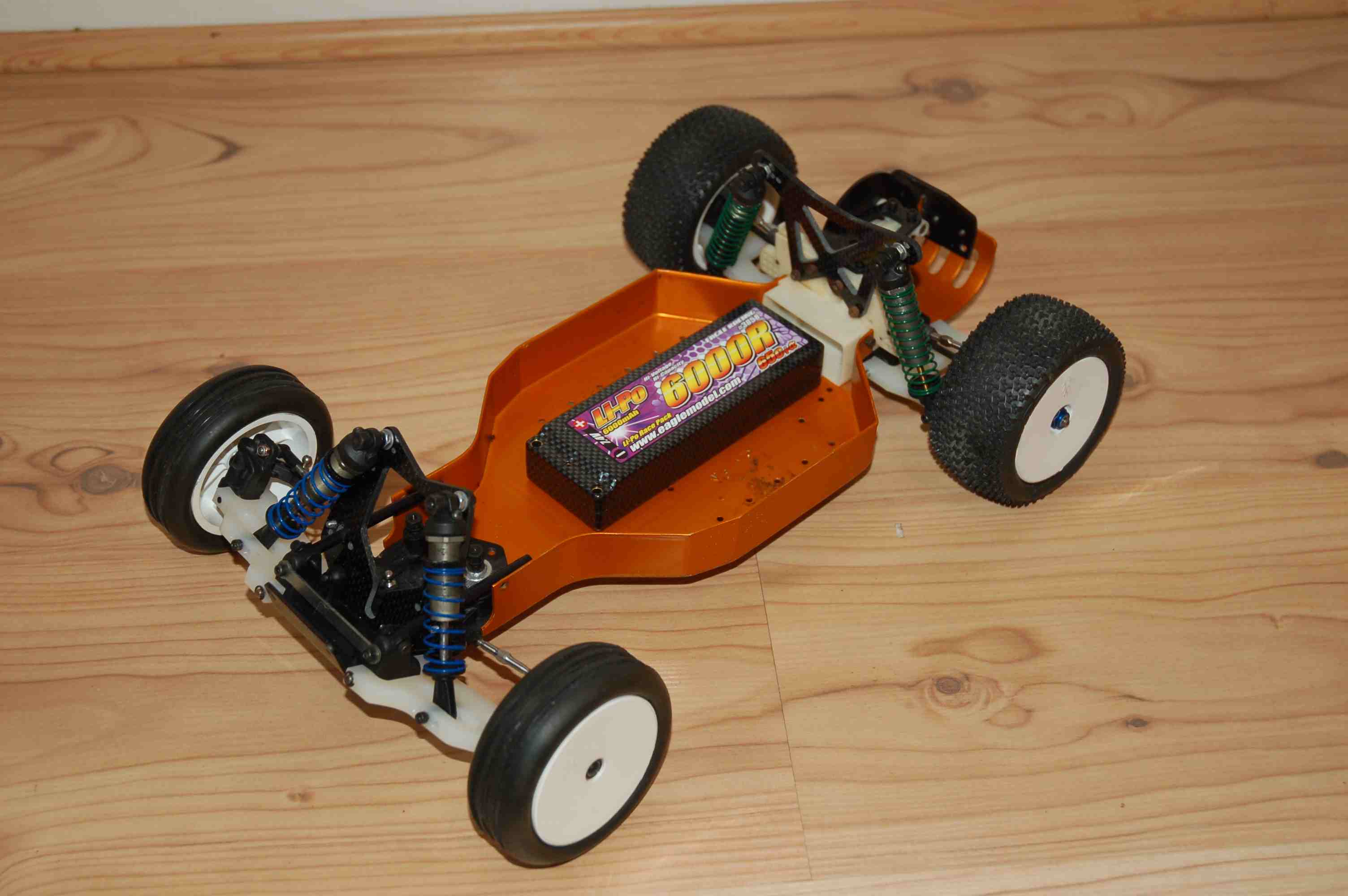

Some pictures of a rough first assembly to see how it all fits together and what parts I am still missing

Looks good. I'm hoping to do about the same to my goldpan over the next year or so.

Looks great, you and I have similar builds with Dynotech arms and Fibre Lyte parts.

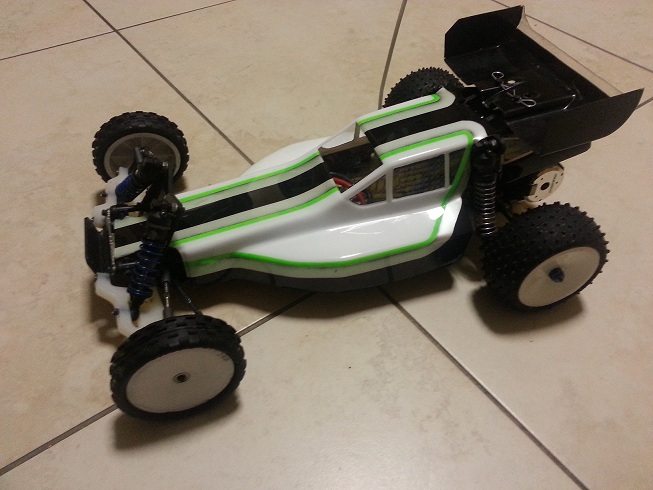

The Fibrelyte and Dynotech parts work great, Goldpan has been up and running with a while now, just need to tidy up a few bits and will post some more pictures. I am pleasantly surprised at how it handles compared to my Vega B4.1 conversion on grass although grip roll has been tough to dial out.
