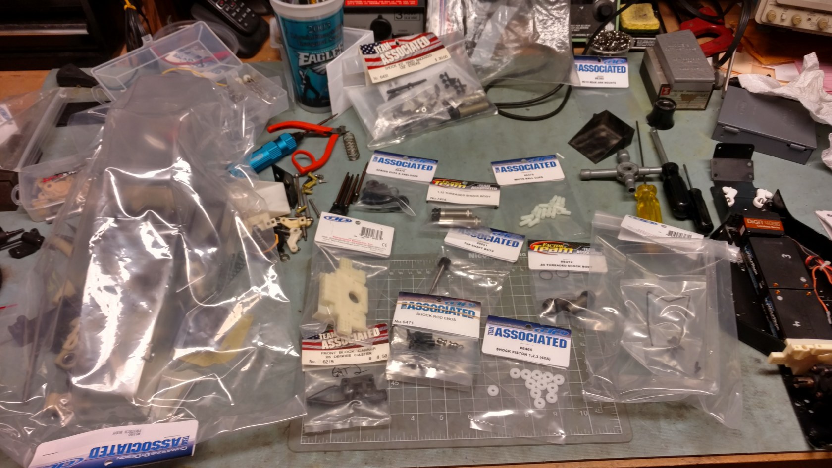

Here's a quick pile 'o parts pic, to be continued............

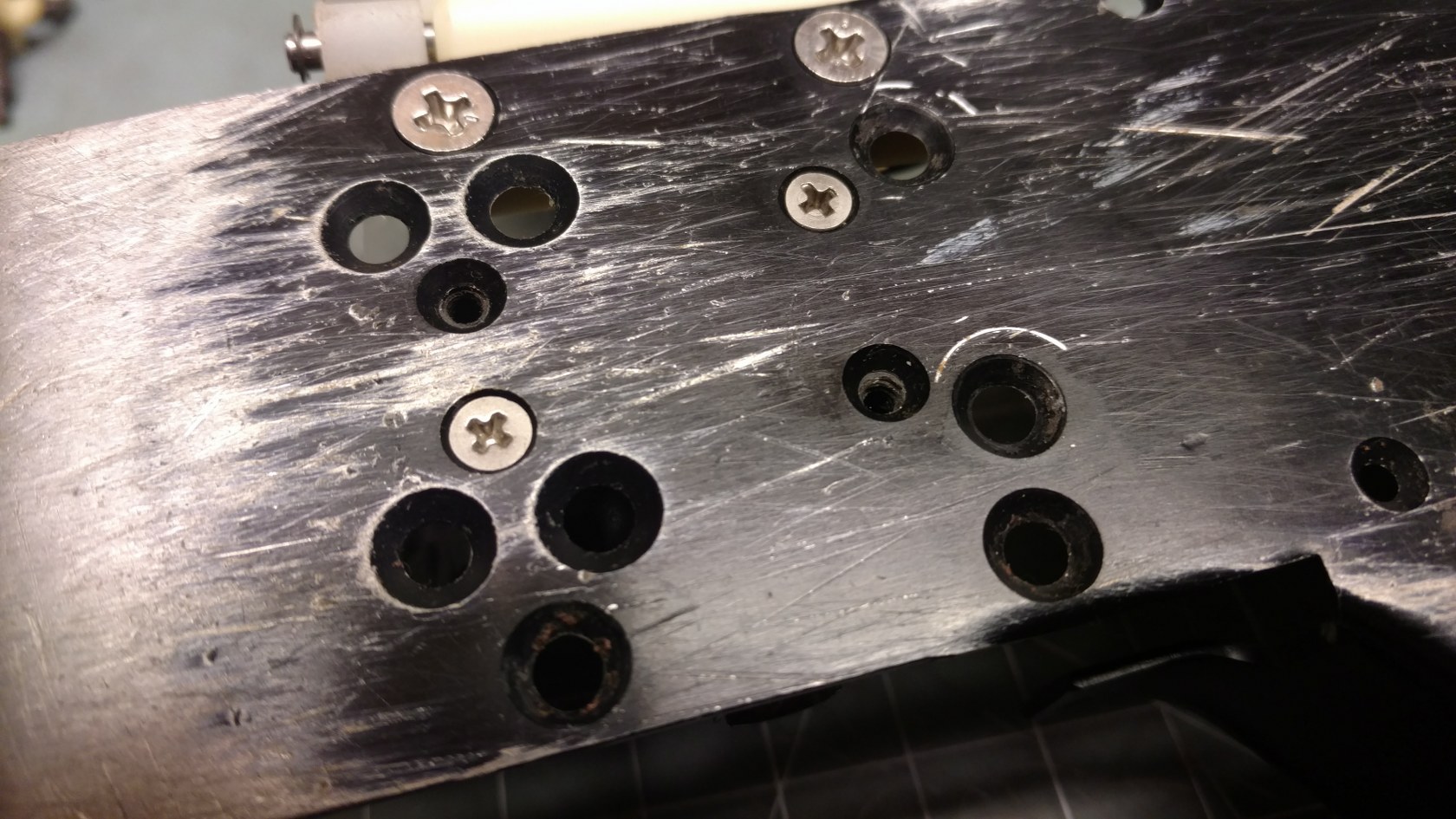

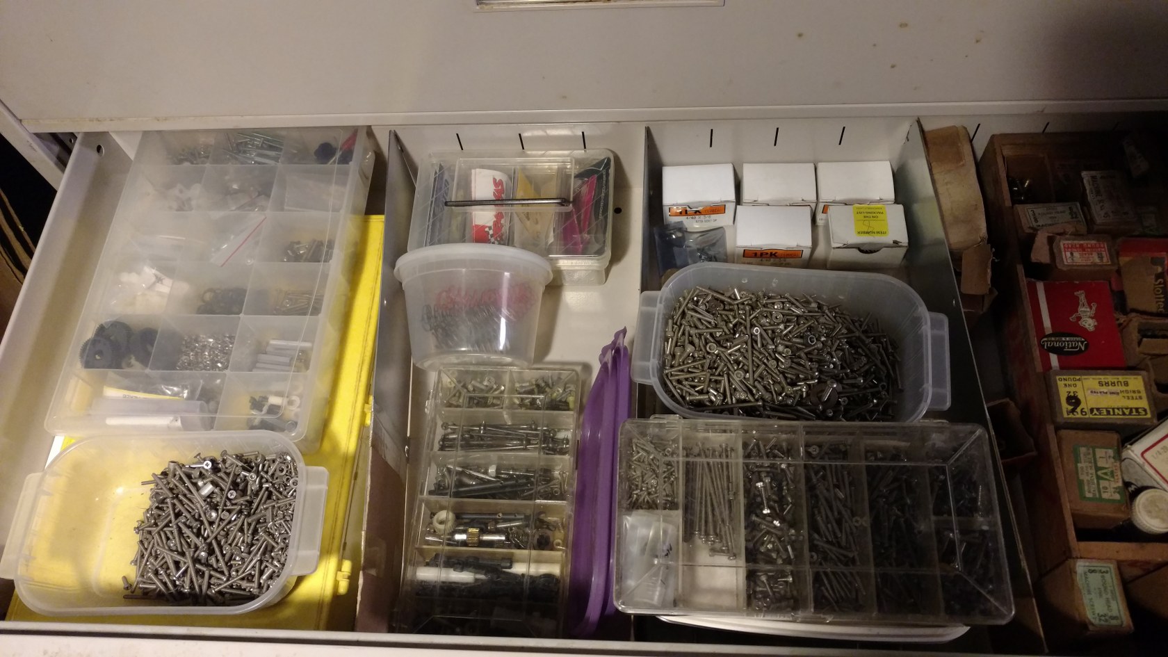

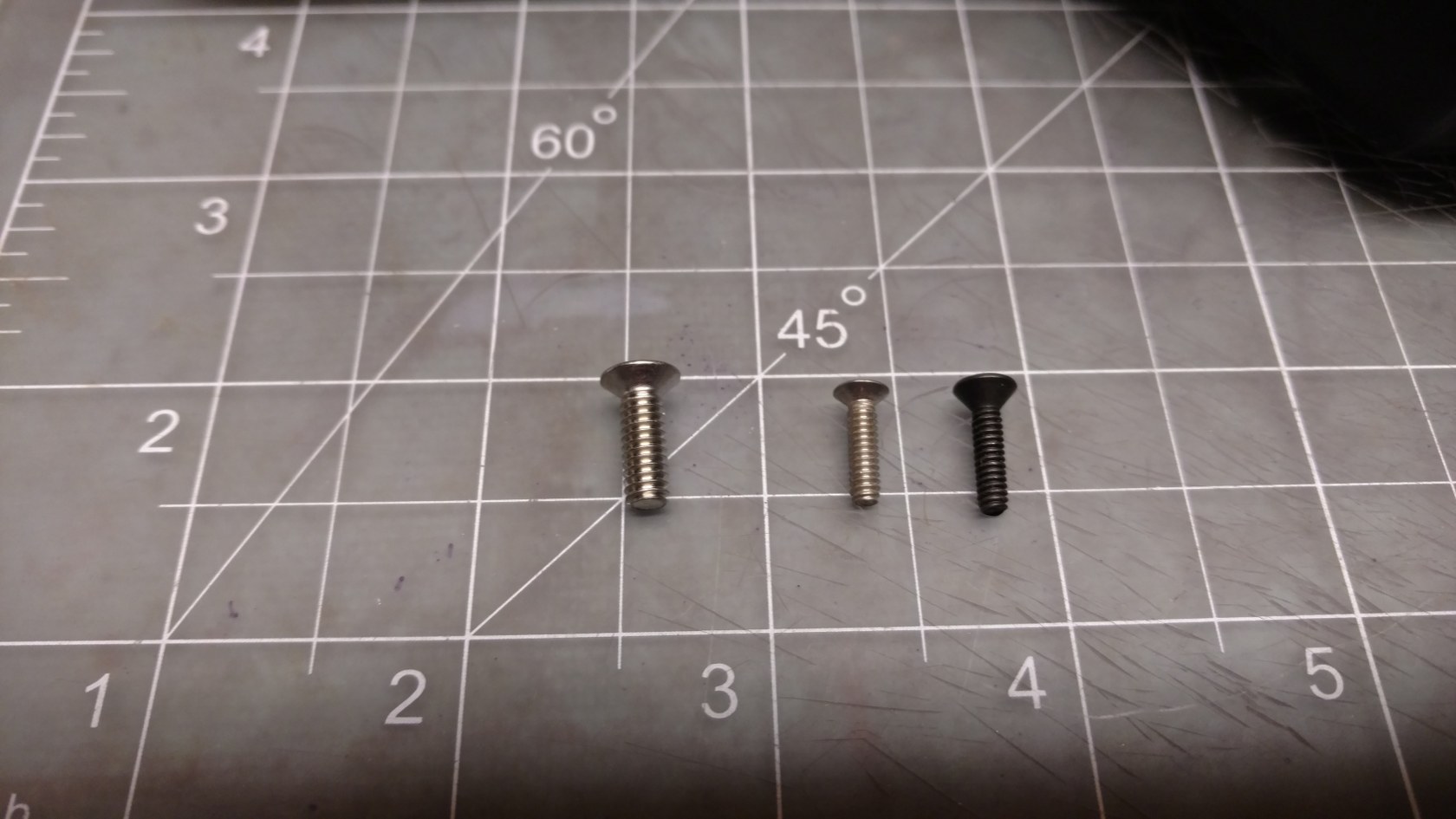

So normally I don't use much of the standard associated hardware: one, I don't like rust. two, I have a bunch of stainless hardware. three, I hate how the #4 screws fit in the countersinking. four, I don't really have 'new' kits so bulk hardware is easier.
Most of my hardware is either old stock that my dad gave me, or from mcmaster-carr as much as possible. certainly, there are some specific stuff that I do get from associated.
pic of the screws I use vs the original HW and how they fit in the countersinking:

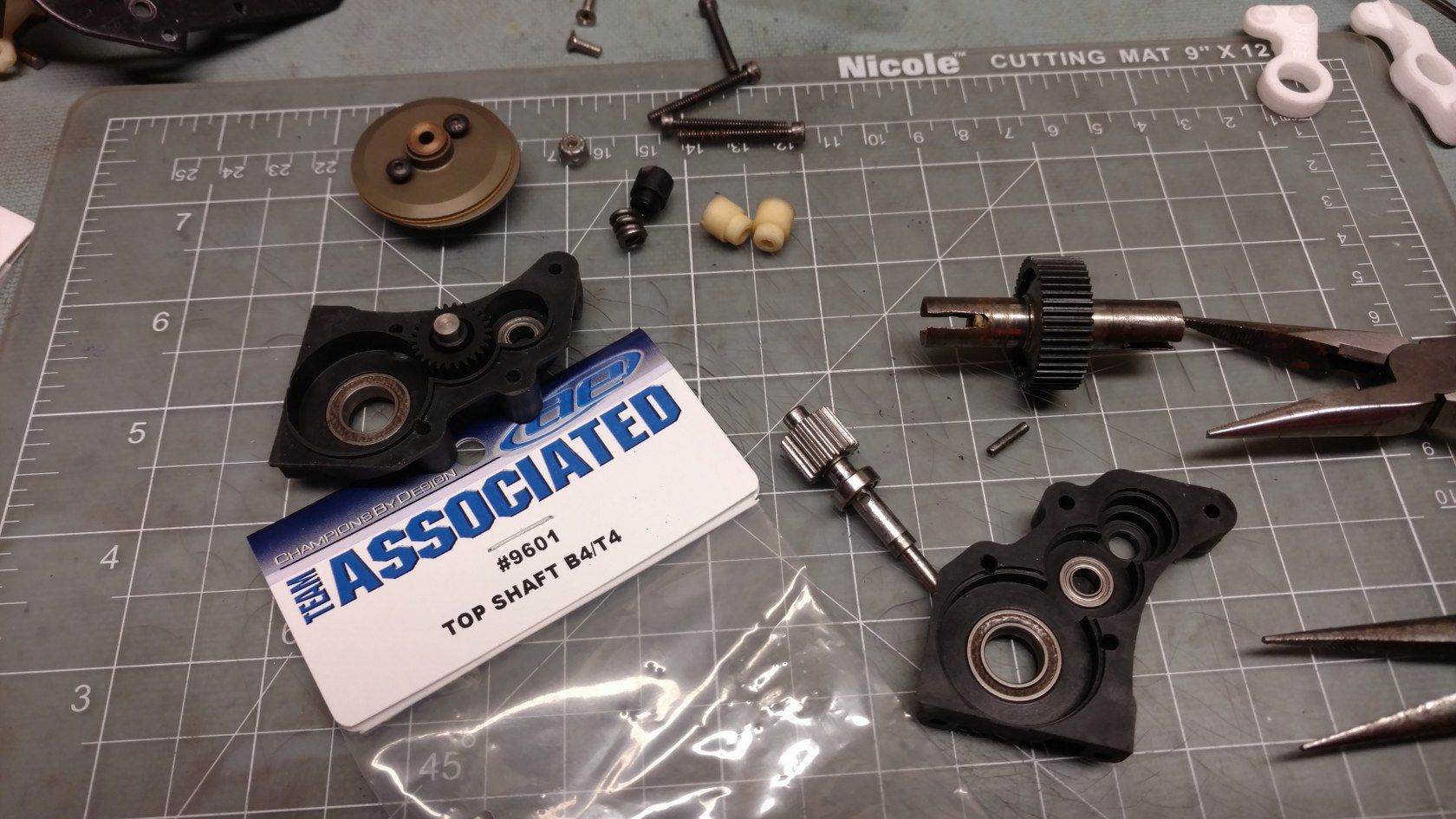

On to some build pics:

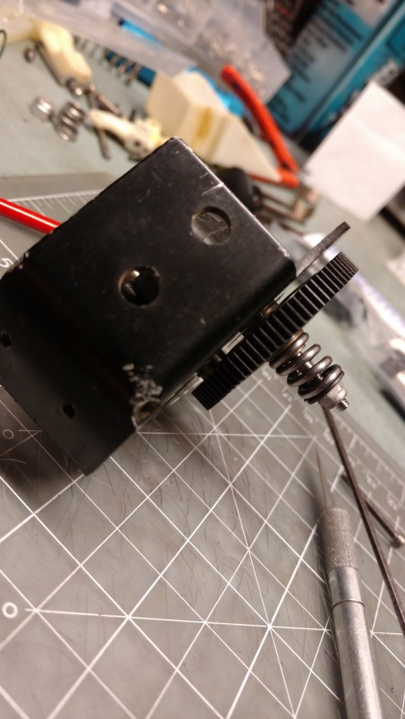

popping the trans apart to update the top shaft, all looks pretty clean and new. No need to do anything except swap out the top shaft and check for clearance to the motor plate. everything checks out great.

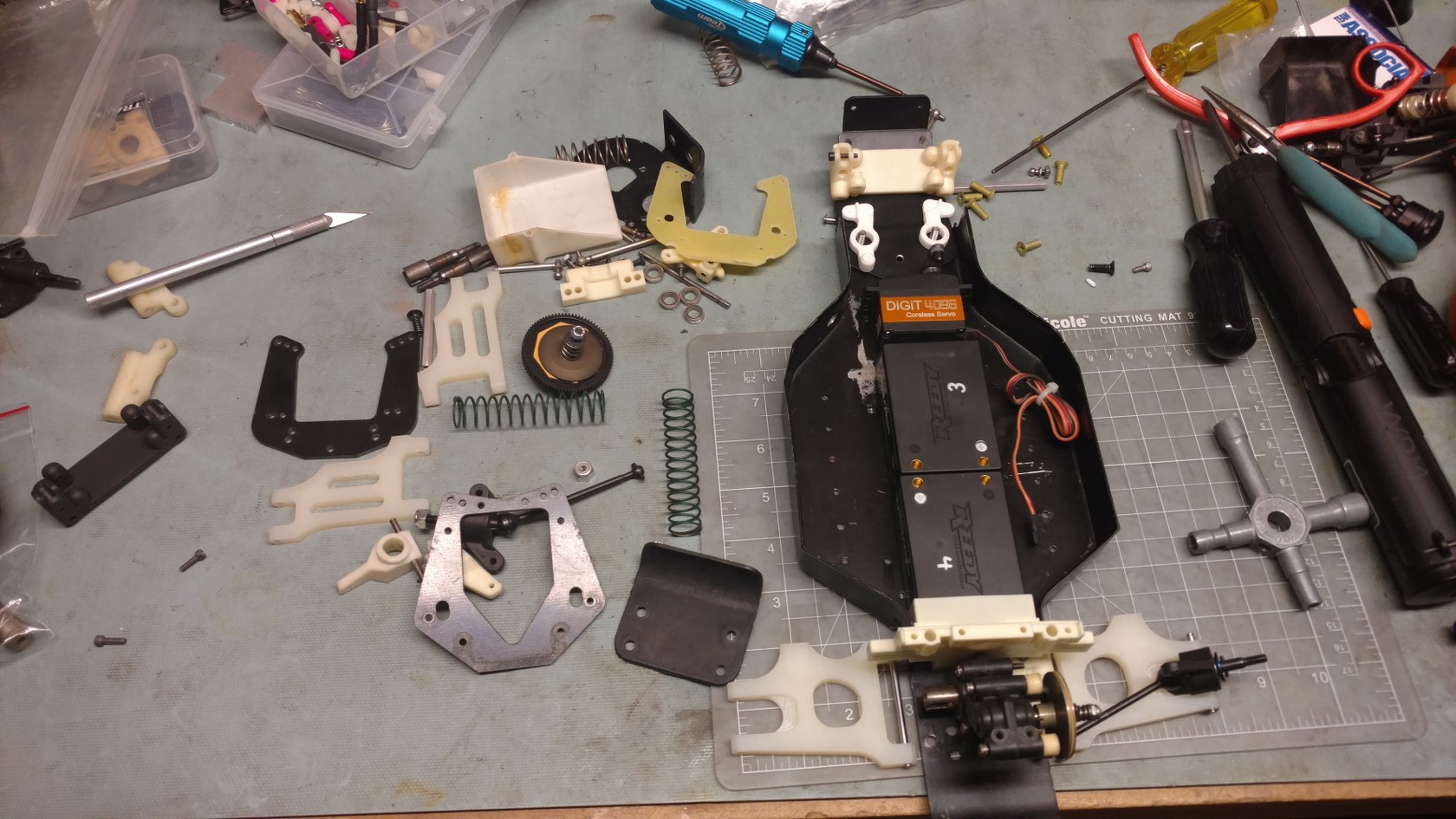

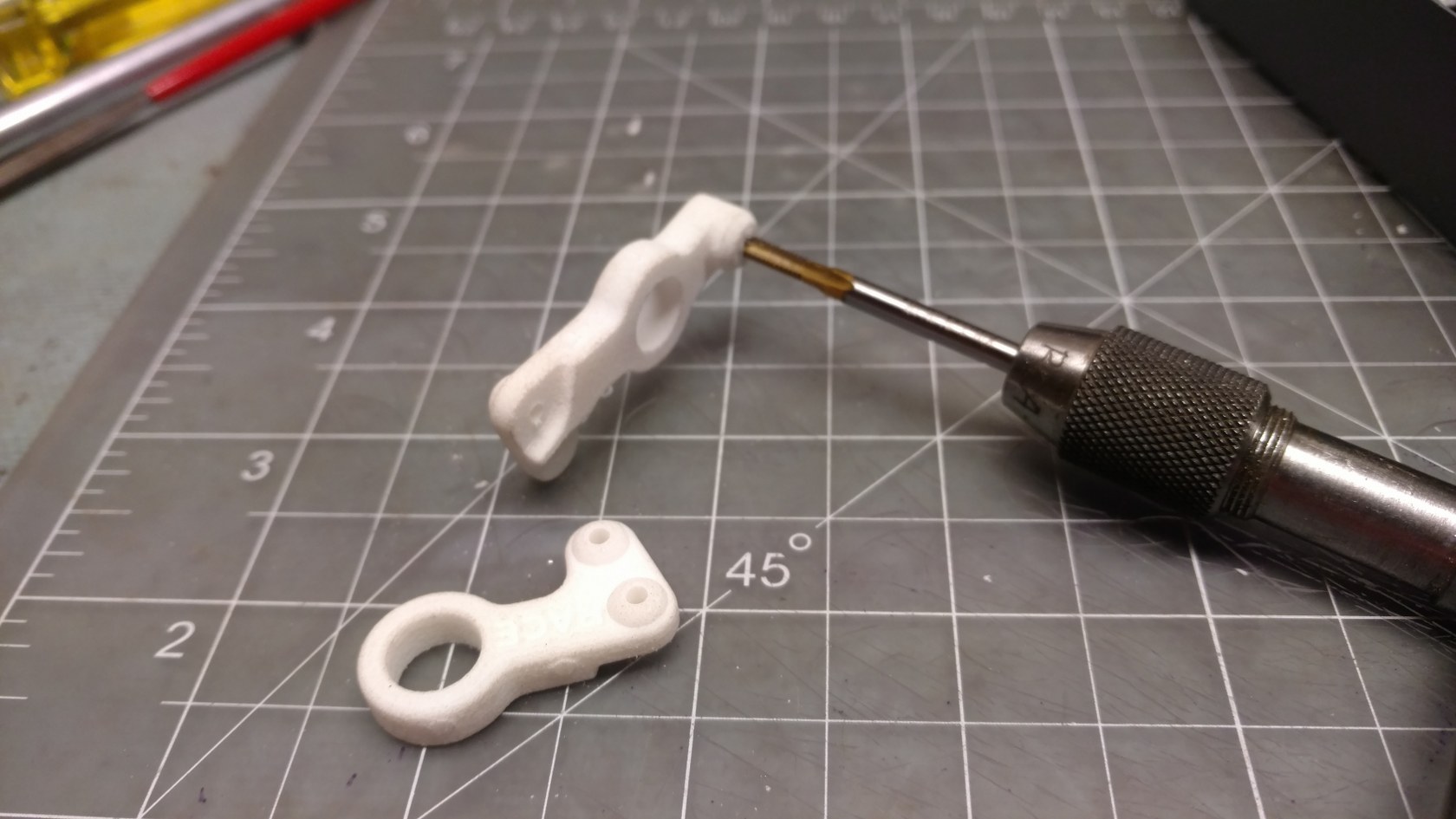

the steering rack I plan to use is from shapeways, a NIX product, allows you to mount the servo east-west and tuck it up forward cleanly. To keep the parts strong, I reduce stress from threading and the bearings, quick ream for the bearings, and tap the holes about halfway(this way you get some nice fit, but reduce the internal stress.) At Vonats they seem to hold up pretty well with my rough driving, so we'll try it again. These are labeled 'race' parts.
The battery cup I trimmed for two reasons: one, the cup was already cut up in front. two, I didn't want to drill any more holes in the chassis, the lipo packs I am using need about another 1/8" clearance up front.
With the forward part missing, the battery strap will have features to prevent the battery from walking forward. I applied the same method to the 2wd car I ran.

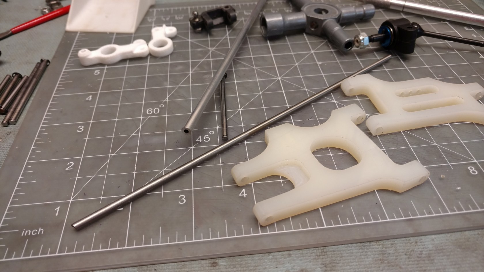

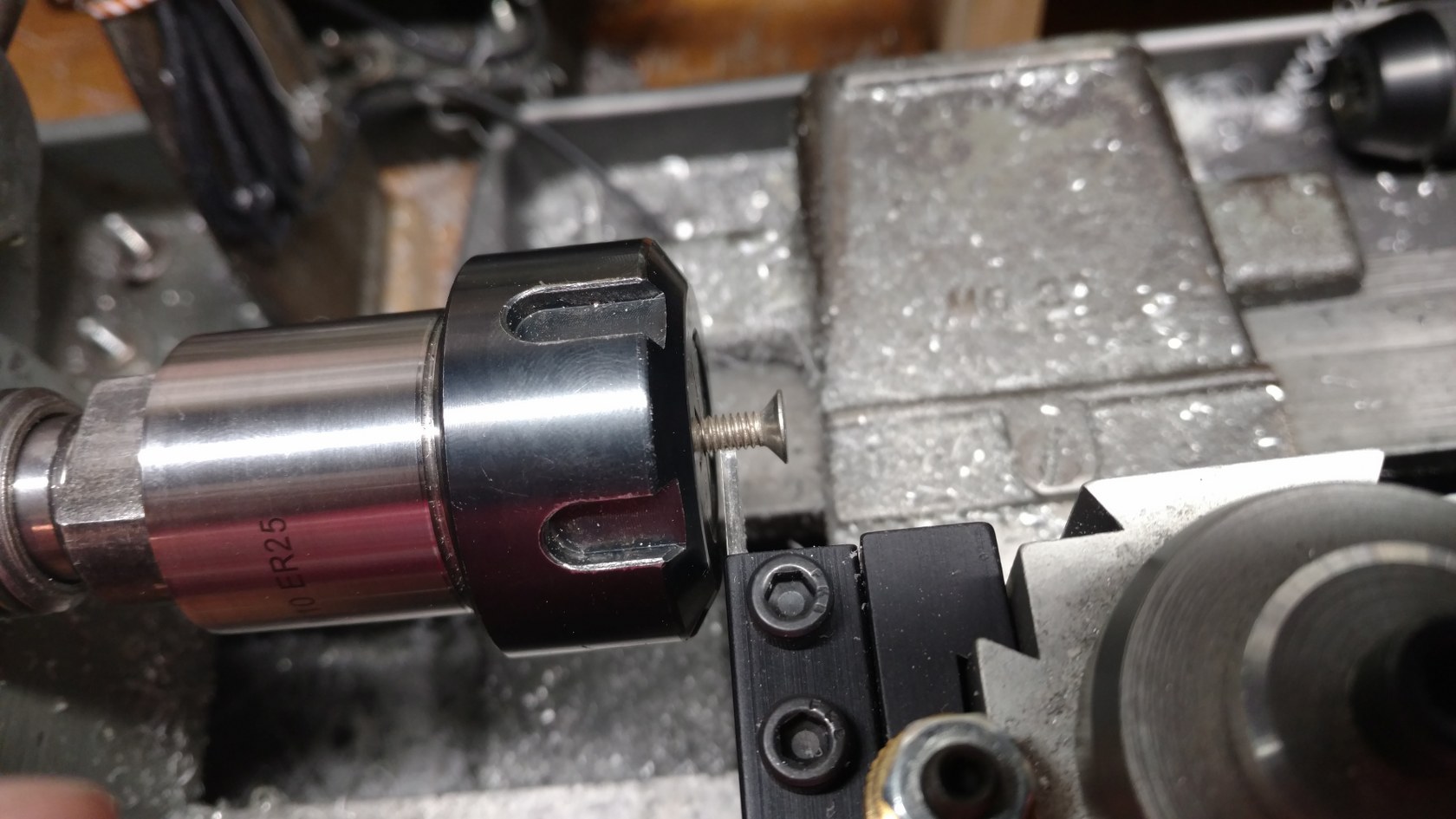

First opportunity to fab something: I don't have the shorty 8-32 screw for the nose plate. Throw a screw into the lathe to part off:
Second look at other items, it turns out I only have some hinge pins. I know I will be making wing tubes possibly, as well as new brace tubes. For these parts, I use 1/8" titanium stock and cut to length and add e-clip recesses. The tubes are from K&S, 3/16" tubing they refer to as 'tappable' with a ID perfect for tapping a #4 screw. Again, mcmaster for titanium, tower or similar for the K&S tubing.
