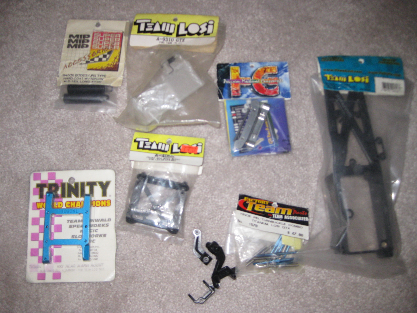

Mip part # mc-200Chris K wrote:What kinda' shock cartridges are those?????
Kinda rare actually, im still looking for a pair to finish off this set.

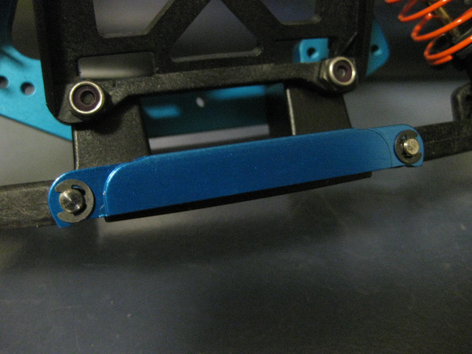

build update!
front end-
jrx rpm bulkhead and trinity tower went together very nice, but the trinity arm brace DOES NOT FIT !!! bummer... anyone have any ideas?
the stock A-1003 bulkhead is the same on the jrx cars, so does the rpm bulkhead have a wider pin spacing?
front end-

Re: Lowry's next build? NXT Graphite plus
Oh dang, I saw this issue comIng up and forgot to say something.
Your problem is that you didn't get the version of the brace that comes with the longer hinge pins.
http://sabulatech.com/storefront/product.php?id_product=1116
When I have time tonight I will compare the ones that come with to other hinge pins I have and see if there is close match.
yea the part numbers are not the same.. i wonder if tk3069 is wider than tk3008?mytimac wrote:Oh dang, I saw this issue comIng up and forgot to say something.
Ok, all i was looking at was hinge pin length. Sheesh, on my iphone i didn't see the right side of the bulkhead.
Maybe the RPM one is wider, i was thinking you thought deeper until seeing picture on my computer now.
If it is any help, i found the a2161 from XXX/T/NT to be just about the right length hinge pin. Just little on the long side, but not by much.
its 1.97 on the trinity part center to center and the bulkhead is 2.16 center to center... damnmytimac wrote:Ok, all i was looking at was hinge pin length. Sheesh, i on my iphone i didn't see the right side of the bulkhead.
Charlie don't surf wrote:Redrill and gold e clips!!!
i think that's what I'm gonna do, i just don't want it to look hokey
but ................
its a half a hinge pin width off on each side!!!!!!!!!!
NOOOOO!!!! Don't hack it, new losi bulkheads are easy to come by, that brace is more difficult part to find.lowrydesign wrote:Charlie don't surf wrote:Redrill and gold e clips!!!

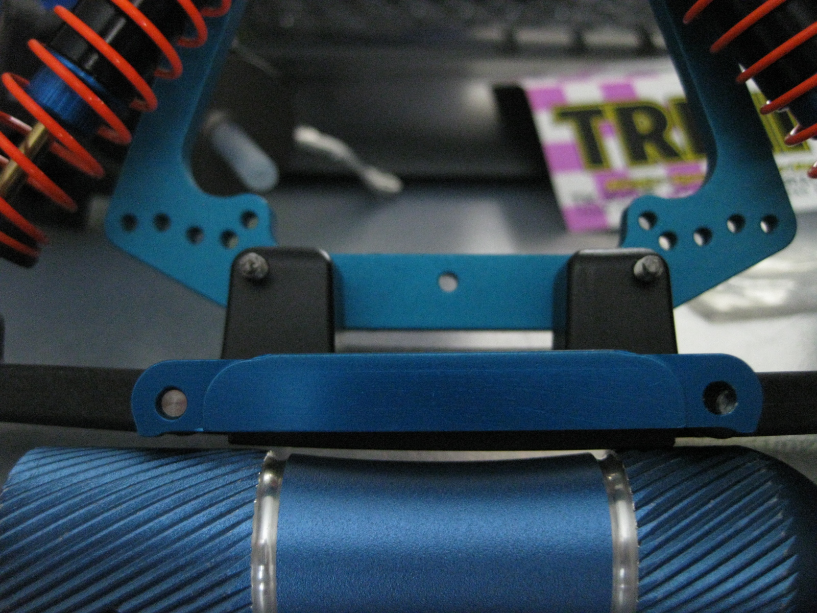

elongated the holes, cant really tell after the E clips are on
thanks Reggie for the motivational push to file on a brand new part..
mytimac wrote:NOOOOO!!!! Don't hack it, new losi bulkheads are easy to come by, that brace is more difficult part to find.lowrydesign wrote:Charlie don't surf wrote:Redrill and gold e clips!!!
dude i got it from has like ten of them
too late, plus i really wanted to keep the rpm bulkhead
