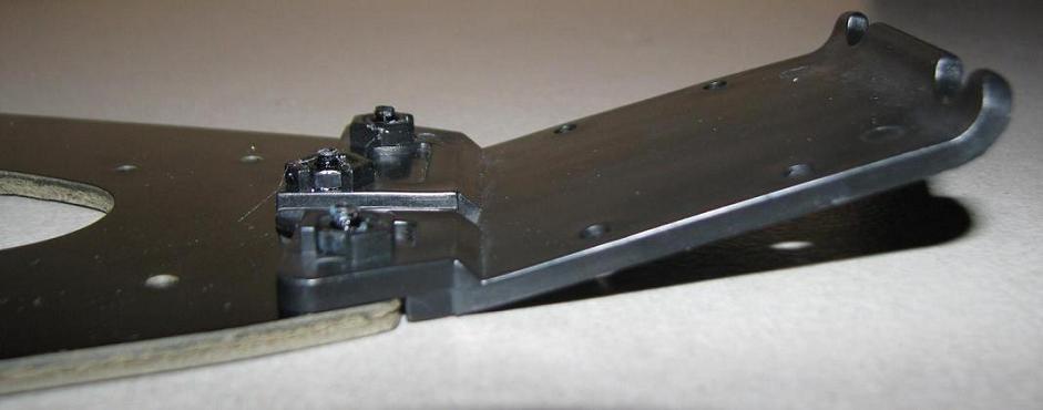

Here's the chassis. Unlike some of the other parts I only got 1 in those boxes. It's made of a very shiny composite with bakelite (an early plastic invented by a belgian called Baekelant in the early 20th century).
It looks a little more 'pro', but I guess it's not as good as the the blank GF10 chassis of the Wyvern. The Wyvern EX was priced a little higher than its pro brother, only because it contained the Mabushi 540 and an MSC Talk about poor marketing A separate nose piece with built-in bumper in souple nylon Mating can start the nose piece adds a nice kick-up upfront and gives more clearance for landing from jumps: thumbs up Check out these arms: nice and wide, made of fiber reinforced plastic Hinge-pins with E-clipses, classic pain in the B The front gearbox; they sure know their plastics and mouldings at Academy The front end put roughly put together and ready to take the diff, but let's get on with the rear first

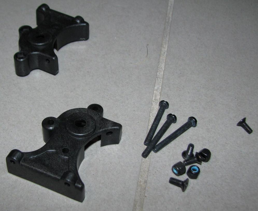

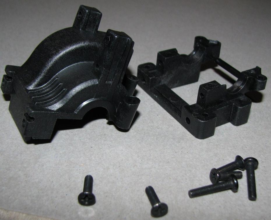

The rear end: gearbox casing with built in arm mounts with fixed caster.
I hope you're enjoying the ride

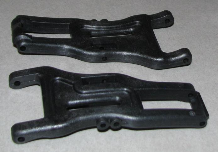

Another pair of nice arms (yes I know they look like yokomos). Note the spared-out area for the diff cups.

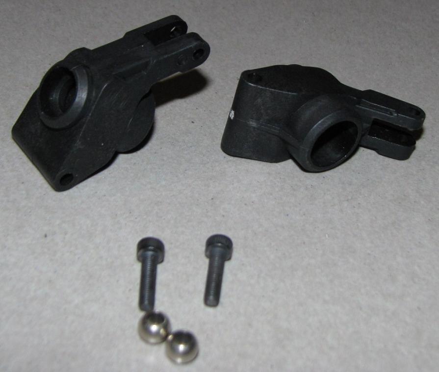

The rear carriers look like yok's too; but they have the axle nicely encapsuled
10x5 bearings and U-J's are optional here and these optional U-J's are way shorter than Yok's: the diffs outdrives are further apart= centering right above the hinge-pins
Getting that butt ready

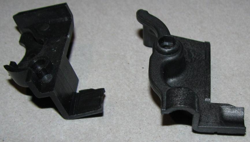

the "center" gearbox:
and inside:
Far from the prettiest part in the kit, but metal and functional
Ok, I'm tired, we'll continue the story tomorrow. I hope you're enjoying the ride

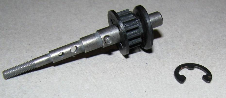

The center shaft: special edition as included and needed with the slipper kit. And the top pulley, and ... uh-oh: I had to dig in other stock to find a fitting E-clipse as that wasn't included Strange: 2 different pulleys with the same part nr? I used the black one since the white one has a smaller inner diameter.
I think the white one is the alternative for the one-way front-belt pulley when using the slipper shaft. Still strange to give it the same partnumber as the standard rear-belt pulley though. the one-way front-belt pulley: Partial assembly. see that open window on the front of the gearcase? Beats me why it's there. Surely something I'll have to fix in the future.
