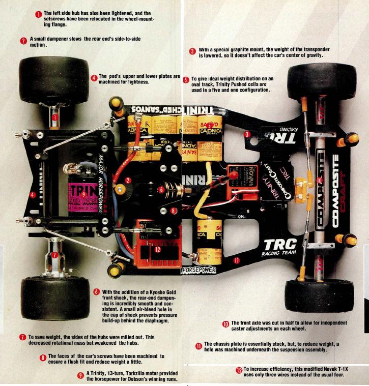

I search info on the rear damper additional on the pivot arm ball for the TRC LYNX 2
Like on the Andy Dobson car.
Pics or manual ?
Thanks for help.PRP

prp, is this what your after?
If so and you need more pics just let me know.

I think PRP means the damper disk as used with the RC10L. This was additional and seen very rarely. This is a RCCA scan I found some time ago what shows Andy Dobson´s Lynx II. He was using the damper disk but this is black so not easy to see.
The damper disk was sold as an option part and even not found at the expensive Lynx II Elite kit.

Thanks V12 , you'ra too fast, exactly that the n°2, if any body have information on.
I don't think thgis is a disc from RC10L or 12L, no nerf lign on the Andy disc.
Thanks Pierre PRP
Thanks Pierre PRP

I didn´t mean it is a disk from RC10L or 12L, just the same system. I know a damper disk was sold for the Lynx as an option part, but Andy Dobson was a team driver and maybe also used a prototype part what could look different than the production part.

Apologies for resurrecting an old thread. I just picked up one of these and am looking for more info on Andy Dobson's car from that article.V12 wrote: ↑Thu Oct 11, 2012 4:52 pm I think PRP means the damper disk as used with the RC10L. This was additional and seen very rarely. This is a RCCA scan I found some time ago what shows Andy Dobson´s Lynx II. He was using the damper disk but this is black so not easy to see.
V12: Do you have the full article scan or know which RCCA issue this is from?
(Edit: Found it! Now to start gathering parts..)
