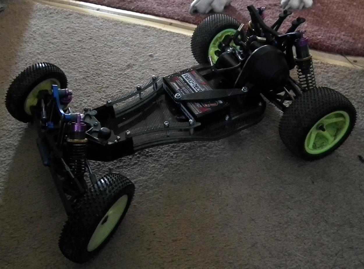

Don't have a current pic, I've got the side pods built up now, using shorty lipos, sideways. Fits a treat, I'll get a newer picture up tomorrow.

That must be a pretty unique car! Whats the idea of using the B4 front end? Have you driven any other mid-motor cars for comparison?CON2 wrote:Don't have a current pic, I've got the side pods built up now, using shorty lipos, sideways. Fits a treat, I'll get a newer picture up tomorrow.

1 of only 3 made, not 100% sure but, I may have another chassis coming soon......Then I'll have 2 of 3 made!!!
Only mid car I've ever driven, must say it's awsome, I only use it in my garden (field) where I built a grass track, local club runs V12's and SCT's, so I don't race it.
If I was being picky, there's a slightly off camber hairpin, always understeers, everywhere else it's the best car I've ever driven.

Ha ha ok! - looks a cool car for sure!CON2 wrote:Only mid car I've ever driven, must say it's awsome, I only use it in my garden (field) where I built a grass track, local club runs V12's and SCT's, so I don't race it.

Wow - throw some Kyosho, Tamiya & Yokomo parts at it & you'll have all the main (racer grade) manufacturers represented in one car!CON2 wrote:Current set up, Schumacher big bore shocks, very nice.
