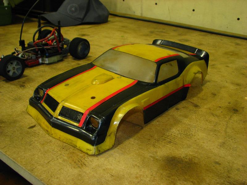

Time for some pics of the current state:
New are the 5mm steel axle with SG Prosso rear wheels and the spur bolted direct on the wheel. The spur is pretty much standard but 64dp just because I bought a bunch of pinions by mistake on yahoo auctiuons years ago. Pitty I had to loose the diff (be it geared) but now I won't have troubles sourcing new cheap spurs at least.
I also used the SG front wheels to get a matching look: on 1/12th steering knuckles and axles from an unidentified Schumacher. Disadvantage: no more bearings in the front, but the longer arm on the knuckles helped taming the steering response down a bit.
The speed demon also helps taming things down to a level I can keep (more or less) from hitting the walls too often. How does a speed demon help, you ask: just check the winding marked on the can.
The moter spacer helps to bring the weight of the moter just a little closer to the center line. But I still had to add some lead to the opposite site too to get a more even pressure on both rear wheels.
The low profile shorty is also moved a little off center: the connector side being lighter and all... yeahyeah, I'm trying to do the best I can; even with this 25, or so, old girl.
The top reinforcment rods were replaced by a thick strip of FRP on the chassis: closer to the original design. And the wheelbase was re-adjusted for the new body of course. The foam bumper was added to protect it a bit better: Mardave class can get pretty rough... worse than my bumper could remedy I found out soon enough.
The body I had carefully stripped from paint both on the in and outside, and repainted, is already cracked badly in several places.
The old lexan is way thicker than the beetle shell but the age seems to have made it brittle. Possibly the dot 4 threatment hasn't helped and 'dried' up the lexan, but that's just a guess.
