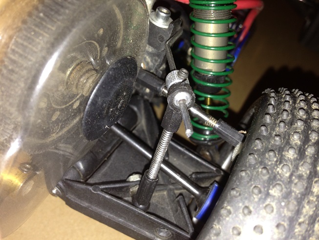

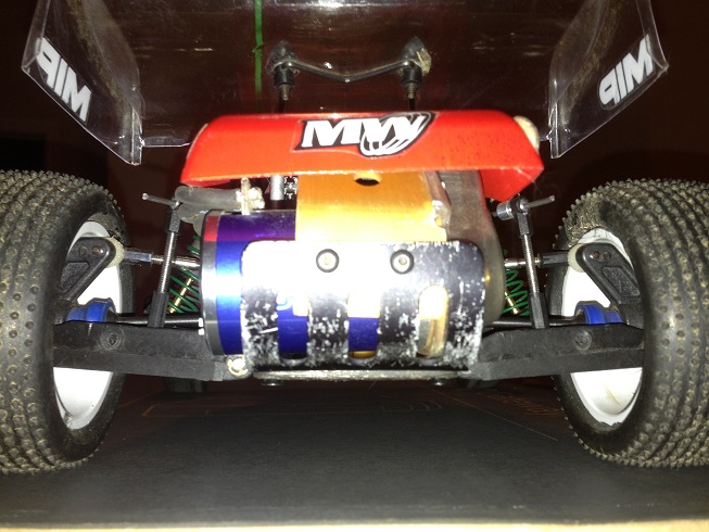

Anyone do anything similar or better. I'm always looking to improve. This car is a runner, and it is beginning to hold its own with the B4's on the clay.
Used .062 music wire on the back.
Used .055 music wire on the front.

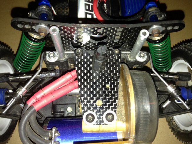

I added a rear one and it made a huge difference
http://www.rc10talk.com/viewtopic.php?f=35&t=27396

I think the sway bars made a big difference at the track, especially the rear one. The links I used are B44, but I' pretty sure they are the same as the B4.

The clay track I run on is very sticky, so when going through corners, the rear inside tire would lift up and cause a roll. That problem has been alleviated now. The car was much faster around the track and much more manageable.

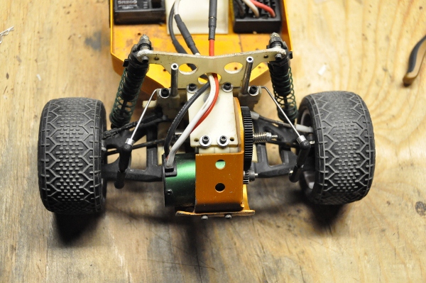

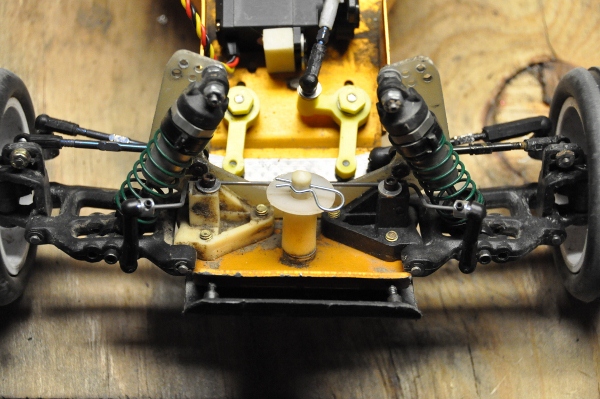

another way to do it without side play from the sway bay.

That's a very nice setup. I'll have to look into doing something like that with the RPM arms. Thanks for the pics.
