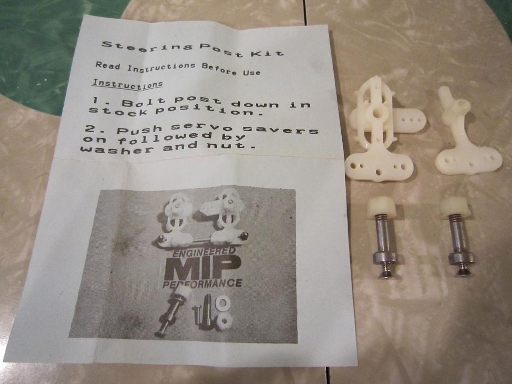

I've had this new TQ chassis for a while now and decided to sit down and build it. I'm trying to make it fully stock with the exception of the steering. I added some MIP steering posts as I always thought they were cool bitd. Anyway here it is so far.

I completed more with this build. My goal was to build the chassis to look exactly like the manual pictures and use the correct T-4 esc, Futaba FP-S132H steering servo, Futaba FP-R102-JE receiver with a channel 70 crystal, Reedy SCE power pack and #6502 Reedy competition stock motor. I'm currently working on cutting out a new Andys Heathen body for it. My goal for the finished buggy is to look like the Ad for the TQ in the Jan. 1990 issue of RCCA magazine which shows a TQ with a red Andys heathen body. I'll post more pics when I get the body completed.
