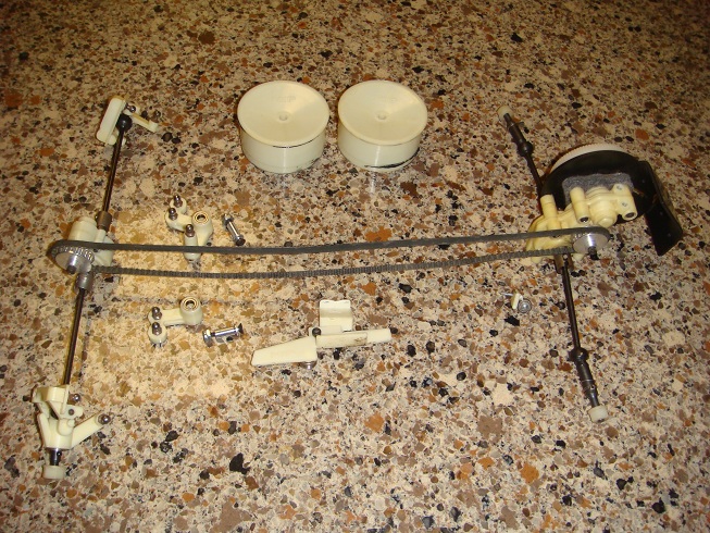

Ok guys. Thanks for the info. I have torn the buggy down since my last visit and have some new pics to share and a few questions. First off, pretty amazing design this is. it's pretty cool how the one way diff is made and works. The ends of the drives are cut in such a way that they act as the catch for the bearing. if you changed them around the diff would work backwards. this leads me to ask this. if you can switch the drives to work in reverse, can you flip the front diff case around to the front of the tower, flip the trans around, and run it like that?

Please show me what you meant by tensioner (from the manual). I think I have one or two. we can make arrangement if you need them

IT SEEMS I NEED THE REAR ROLLER, MOUNT, AND BEARING IF IT'S AN ODD BALL SIZE. 3/16X5/16 IS A COMMON RC-10 REAR BEARING RIGHT? SORRY I DON'T KNOW ALL THE TECHNICAL SIZES AND ITEM NUMBERS. I'M JUST A DUDE WHO BUYS, REBUILDS, AND FINDS A GOOD HOME FOR THEM. I WOULD DEFINATELY LIKE TO MAKE AN ARRANGEMENT BUT I JUST JOINED SO I CAN'T B/S/T QUITE YET. I DON'T THINK MY KIT IS GOING ANYWHERE SO GIVE ME A LITTLE TIME TO GET MY PARTICIPATION UP THERE AND I WILL ASK THE ADMINS. THANKS.
