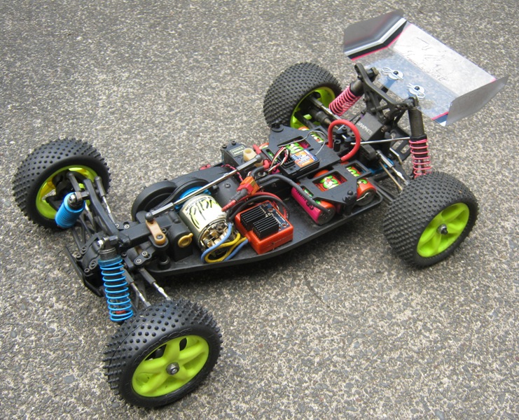

Well it must be time for me to finally post some pics. Ive been having a blast running this around my place. Still a few things I want to change but happy for the most part.
mamadoesntletme
Posts: 542
Joined: Thu Dec 02, 2010 3:03 am
Location: Japan
Been thanked: 16 times
Re: OPEN losi xx4 discussion
Post by mamadoesntletme »
cool!
Are you gonna use a shorty lipo...or..?
slapshot1979
Posts: 928
Location: GTA Ontario,Canada
Post by slapshot1979 »
A full pack hardcase battery fits....with this 5700kv motor. that said I had a 6900kv motor here that Ive never ran and was curious to how it would perform. I installed it but the wires exit the motor on a angle slightly lower to the chassis and the battery was a tough fit up against the motor wires. I did take it for a run and wasnt blown away but an increase in speed. So I went back to the 5700, for ease of battery install.
Previous owner cut the belt guard just behind the antenna mount so you dont have to remove rear end to access Mid belt for changeout. The thickness of the battery slightly lifts the belt guard when using the battery clamp. I was thinking of making a small plate tab off the two bolts in that area to hold cover down and keep somewhat ridgid.
I will use this car for just basic entertainment as there is no track to run it on in my area. I have read the argument about using a saddle pack to keep the cars proper balance, but I think I will calculate weight for other side and will save me from buying a pack just for this car.

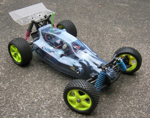

This is the XX4 I am building, still needs many thing to be done.

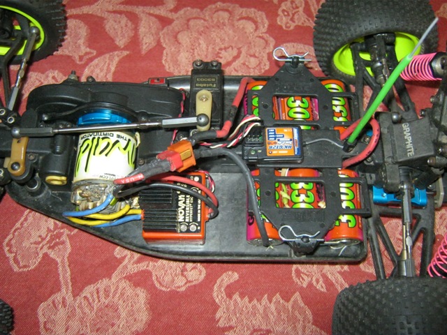

Slapshot-your car looks spooky close to my 1st XX4.
I wound up trading it to Joey K and replacing it with a Yokomo MR4-BXF,then I replaced that with a B44...And am now running a XX4,again!
Can't beat 'em.
I now have two,both uncut chassis style,I'm slowly upgrading one to W.E. specs,so I can have one of each.
The Tough Racing belts seem to work real well,haven't noticed any stretching at all.
The Trinity XX rear pivot block is a killer upgrade.
Managed to find a Trinity rear sway bar,that works well,too.
Love to find a few Trinity front bulkheads. :roll:
Been running this one with all vintage running gear and it flies. :D
Anyone got a spare Lunsford steering turnbuckle?
My second car has 'em all 'round,but is missing the steering one...

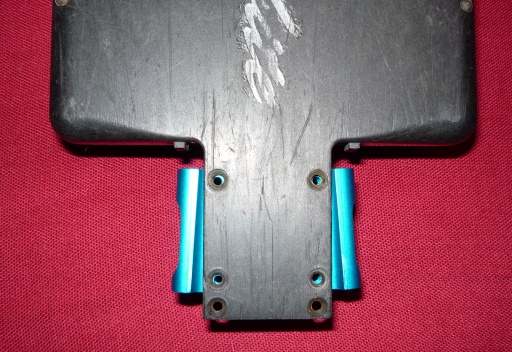

I am loving these things puts a smile on my face when I wrench and I drive. The trinity rear pivot block upgrade is a xx part that is changed to fit correct ?? I have the part, but havent had a chance to take apart and look.
FasterLouder
Posts: 1097
Has thanked: 13 times
Been thanked: 59 times
Post by FasterLouder »

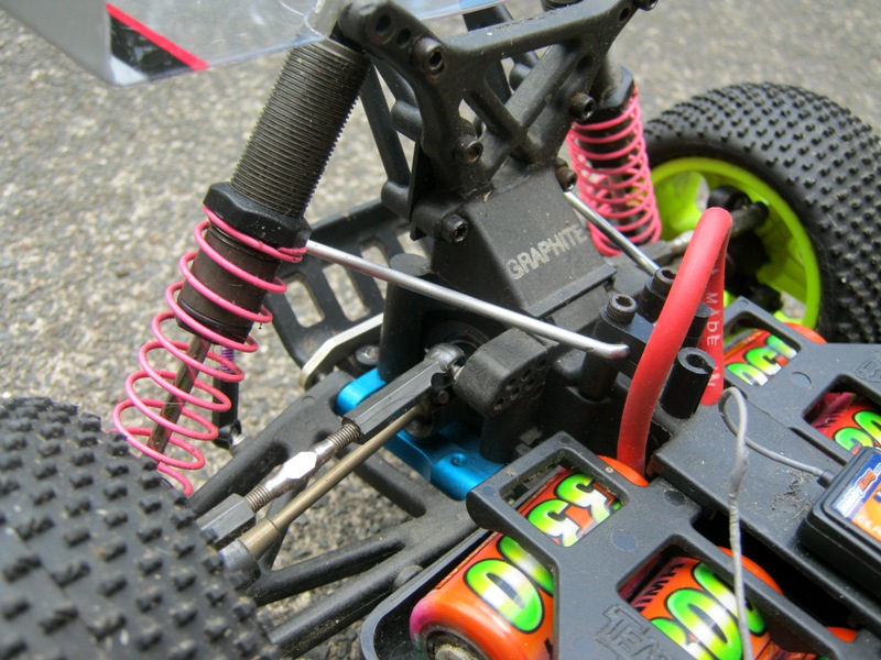

There are two ways to fit the Trinity XX rear pivot block.
The easiest way is two cut the two support ribs off it and bolt each hlaf to each side.
The second way is my favorite and is the way I always do it.
Remove the front rib from the block.
Make a cut into the rear chassis of the XX4 and slide it in.
I have pics,I think...Just not one of the block,after the cut.
You just remove the front rib,so it can slide in,easy.
All The Way Alive

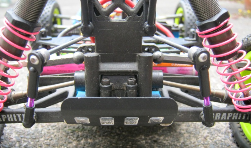

Here you go,I painted over the front rib you need to remove...
All The Way Alive
slapshot1979
Posts: 928
Dremel here I come. Thanks for the pics. :D
