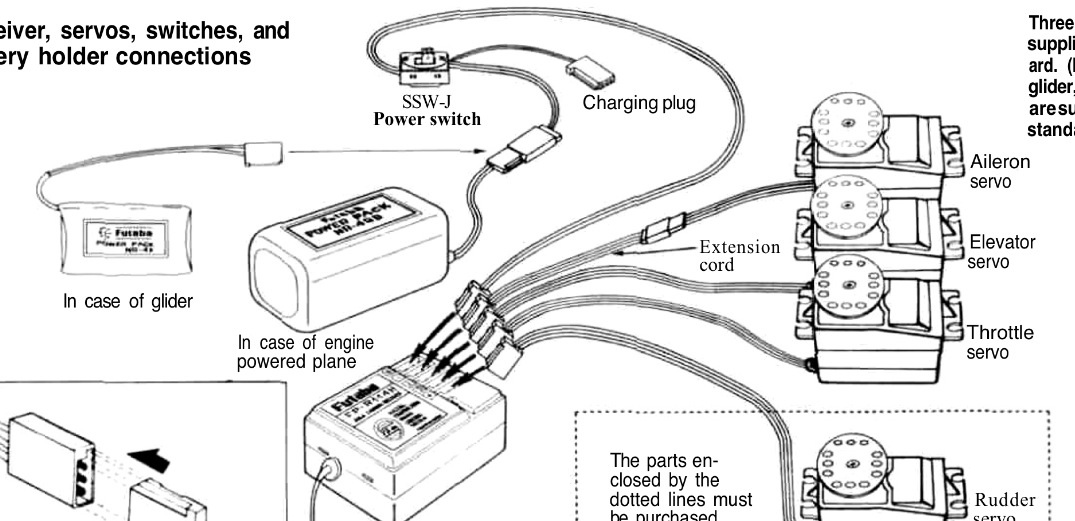

Justin428 wrote:
slotcarrod wrote: The new switch I got today has 3 connections. The one shown on the right in the pic, a female connector (I assume for charging), and one that looks like the left that's plugged into the receiver. Then there's the batt, as shown on the left.
Tried searching for that adapter, no luck. Will continue looking.
Ok...the switch you have should have one female and two male (shown above).
One male plugs into the receiver. Sometimes it is red in color
The lone female accepts the battery pack
The final male is for charging.
If there is a tab in the way of plugging the connector in, carefully trim it off and align the colors
Posts: 12214
Has thanked: 1084 times
Been thanked: 3762 times
Re: Do they make an adapter for this?
Here is a sample

gomachv wrote:Here is a sample
Got it. Thanks
