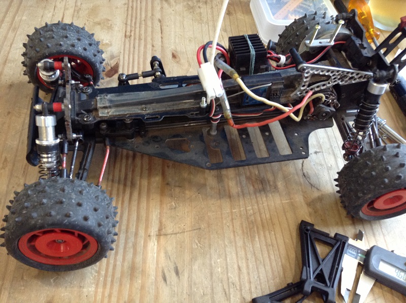

I have just modded the front end by inverting the front wishbones and using a longer stroke shock:

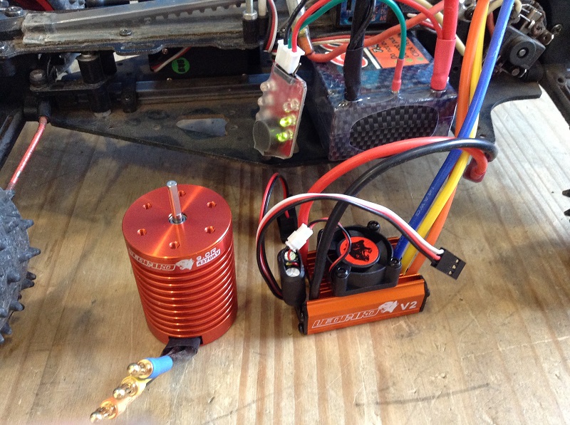

I have bought a 60A ESC, 9T brushless motor and a 6000mA Lipo but can't use it as the charger has not arrived.

I like your choice of ESC & motor; I chose a Leopard 12T for my build, though. 9T is a lot of oomph...
I found the Leopard electronics in my car very nice and smooth, the fan was almost silent too. So far as I can tell, those are some nice electronics at a very affordable price.

Wow, an endorsement indeed! I haven't used a brushless motor before and don't really know what I'm looking for.

How mental would that be in my car? Would I be over doing it? I have seen vids on Youtube where the cars just wheelie constantly which looks really boring.
Also, will that motor shaft fit my pinions?

That's for a 1/5 scale car. You want to put that into an Optima Mid? You'll probably melt your gears. That could probably power a lawnmower.
The lower the "T" rating of a motor, generally the more powerful it is. I probably wouldn't go lower than about a 10T or 11T in these old cars. Going stupid fast *is* pretty boring, if all you're doing is high-speed runs down the street and a tap on the trigger makes your car flip over...it's uncontrollable. Uncontrollable & too much power = smash-up derby.
