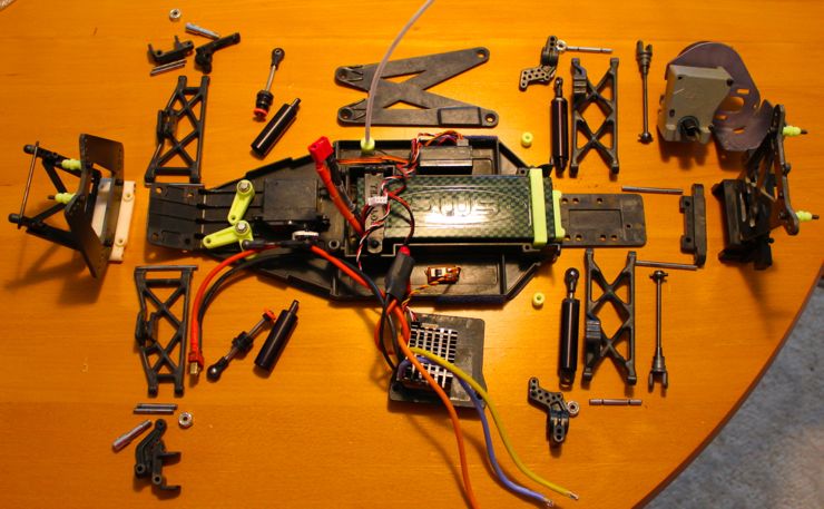

Tried to test some parts this weekend on the LXT, but the races got rained out. Moved the bell cranks that I had tested on the Jrx Pro SE the previous weekend to the LXT. I will probably head back and just run this week without a race and then race it another weekend.
Here is a shot of the build for the LXT. All the yellow parts are 3d printed Fluorescent yellow.
New LXT extended wheel base chassis parts designed.

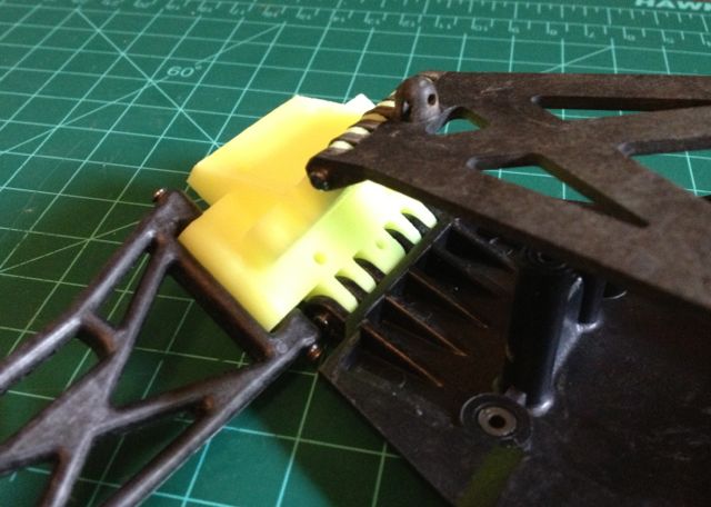

Finally printed out the whole XX bulkhead yesterday.
I am go to go test on track next week, but not real hopeful for its long term strength around the chassis and brace hinge pins. This is ABS as well, the Nylon might be better, I will try that at later date.
Still think new injection mold is probably the best answer for the future.

Good work, it looks clean and polished for a printed part!
Keep us updated on the reliability
