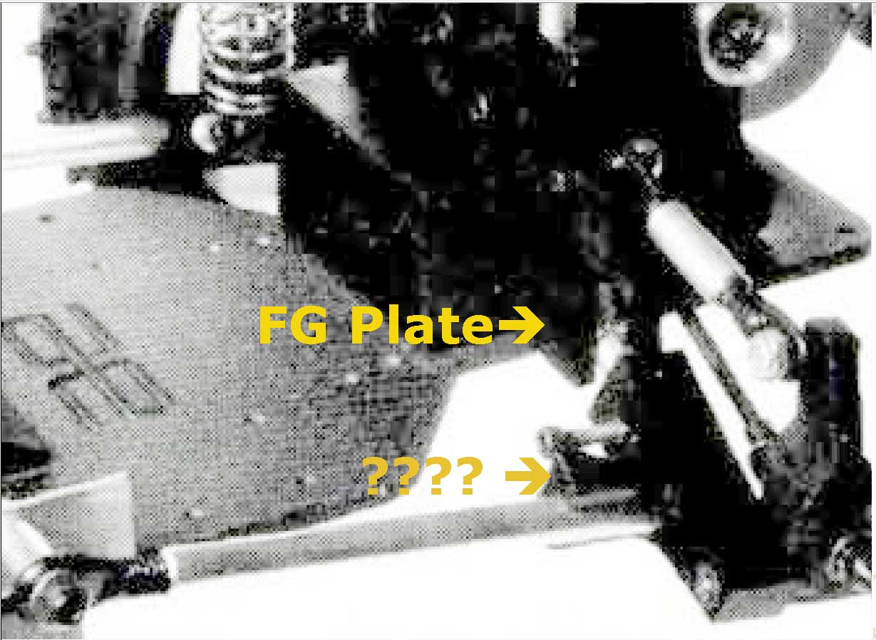

Ran the ad photo through Photoshop to see if I could get more details:
Looks to be a piece of fiberglass or graphite underneath the camber link holes, which is probably screwed onto the back of the rear bulkhead, and that's where the bottom arm link attaches.
Both the link that attaches from that FG plate, and the long link coming from the side of the chassis, seem to be inserted directly into the delrin/nylon block...and I assume the links are held in with screws through the block.
I don't get what that bit of delrin that hugs the side link, where it meets the arm block, is for. Is it just for added support or is there something else it's supposed to do.

It appears to be suspension limiter to keep from forcing it to break the delrin arm under acceleration,The links are quarter inch same used for monster trucks.Don

It has been almost 25 years since I have seen one in person and even then it was only on a car on a shelf. I never saw one run. I'll try to describe the layout the best that I can from what little memory I have of seeing it. First off I don't know what the mystery part is with the question marks. No idea. The general layout is a 3 link suspension. There is a plastic or delrin piece that everything screws into including the shock mount. The rod that comes forward to make up the actual trailing arm part is just a rod that is bolted into the plastic part, so it doesn't swivel there. Only the front of the trailing arms link at the front mount does. The stock hub carrier attaches to the plastic piece with a kingpin and is only supported at the front. The upper link mounts to the bulkhead in the same fashion as it does when it is on a stock a-arm so that component doesn't change. The lower link however is much like the forward trailing arm link. It has a rod end on it as well. It attaches to small plates that attach downwards from the bulkhead which is the piece that you are pointing to. The lower arm can be made longer or shorter or attached higher or lower for a wide range of adjustability. I think there was only 1 shock mount location though and it was fairly far inwards compared to the stock arms.
I "think" that's how it all worked. As I said I only remember looking at one on a shelf in the shop a very long time ago so I never saw one run and never knew anyone that ran it. It shouldn't be all that hard to recreate this setup.
