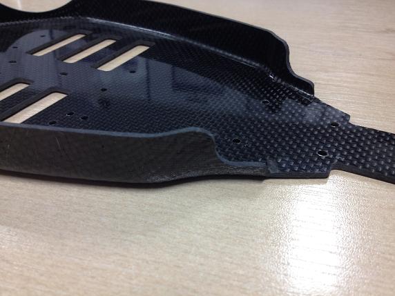

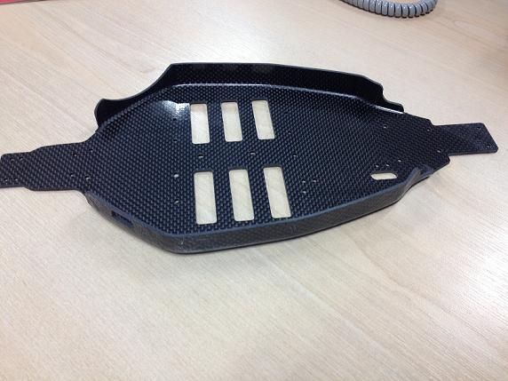

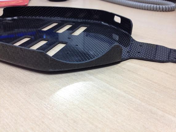

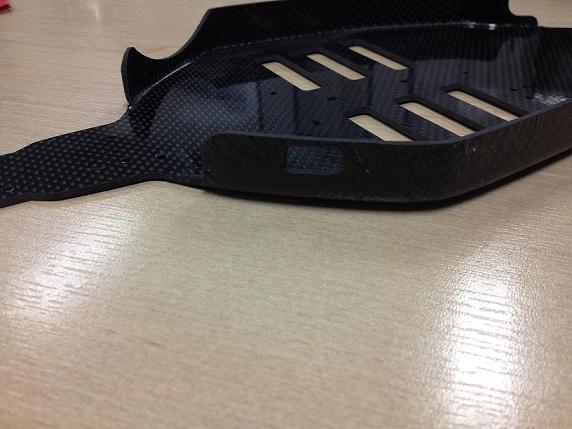

Ok update, first chassis went back for modifications. As the mold was based on my original chassis which was broken you have to accept that it may not be exact for the first made from the mold.
The front pivot rear block section on the chassis was a bit to far out and stopped full travel on the wishbones so asked for 1mm to be removed.
The side walls going around the back hit the gear cover so asked for one side to be 2mm shorter and both sides rounded off.
The side walls were too high compared to my original so asked to be milled down to 20mm in height from 23 as the shell doesnt fit correctly at the front due to the height of the sidewall.
In a few days its back and being refitted so soon will update you all.

Re: LAZER ZX / ZXR Tub Chassis being re-released
Ok had my chassis back after a few mods and its back. Now to build it. Its looking much nicer now.
The top looks good. The base however seems to have the usual FL lumpiness and creases. Fine for a basher but not ideal if you want a display shelfer. I think this is because they use a bag or cloth to make the "mould" on one side.
