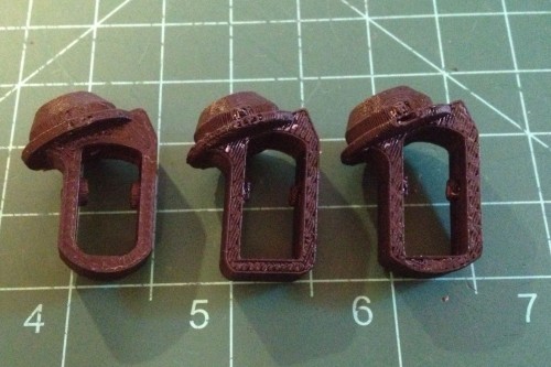

New prototypes
JK Racing
Posts: 4619
Location: Placentia, CA
Has thanked: 139 times
Been thanked: 246 times
Re: New reproduction and Protype parts
Post by JK Racing »
mmmm, those look nice. could you make me a set that fits 12mm springs 8) 8)

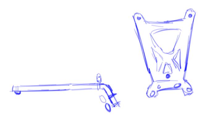

Hmm, I was just thinking... what about a replacement top brace for the XX series that did away with the upper hinge mount? It would be useful to basically get more life out of a front bulkhead with a broken top hinge.
Put design it to go far enough forward to clear the xxt shock towers and include spacers to take up this space for the buggies?
I will add a rough sketch of this to this post from my tablet.
It should be able to be cut from a sheet of graphite or fiberglass if you could find it with thew right angle... It could be a "XX bulkhead saver brace" as it would save all those previously useless front bulkheads. As as it would use through bolts, for extra strength you can add a small thin nut to the slightly longer 4-40 screw to really reinforce things.
Chris

clm wrote:Hmm, I was just thinking... what about a replacement top brace for the XX series that did away with the upper hinge mount? It would be useful to basically get more life out of a front bulkhead with a broken top hinge.
Chris
That is actually a very good idea at first glance. Only thing to really have to worry about I see so far is not making the front so wide it can't fit through the hole in the XXT shock tower. It couldn't be 3d printed easily, too thin and weak at that bend. So sheets of something would have to be the material.
clm
Posts: 942
Location: Oregon Coast
Has thanked: 100 times
Been thanked: 205 times
Post by clm »
The xxt front shock tower would be the one to worry about, you might have to narrow it down to just the two top bolts or neck down the area right behind the shock tower so you can fit one end through move it over and fit the other side through. Although just the two bolts at top would probably be more then sufficient if used with a 4-40 bolt and nut so the threads in the nylon isn't what is taking the abuse.

JK Racing wrote:mmmm, those look nice. could you make me a set that fits 12mm springs 8) 8)
This would be pretty easy to do I think. You thinking Losi 22 size shocks springs?
JK Racing
Posts: 4619
Post by JK Racing »
yep...22 12mm, AE 12mm, K-car 12mm, others I am sure.
--Joey --
Vintage A&L and Factory Works
JKRacingRC.com
mytimac
Business Member
Posts: 944
Joined: Mon Apr 28, 2008 8:42 pm
Location: Rochester MN
Has thanked: 7 times
Been thanked: 56 times
Post by mytimac »
JK Racing wrote:yep...22 12mm, AE 12mm, K-car 12mm, others I am sure.
Ok, should be real quick to change. Try and print it out in the next few weeks and see if it works with my 22 shocks.

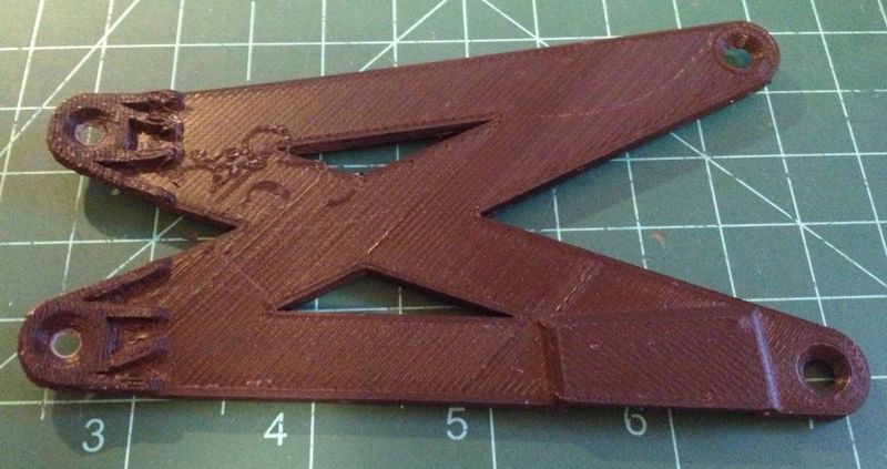

Right now getting ready to test on the track the a5010 and a2000 replacements.
But just got this off the printer, had been on hold while I made the initial launch parts. The printer decided to crash the head into the upper left corner when it finished so ignore how bad that looks right now. Did a test fit and fit perfect right from the start. Now I have to try doing some different test prints using different methods to make the part easier to produce.
Soon I can print out a chassis... just kidding!
